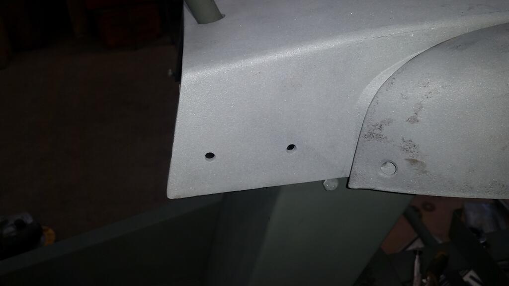

Jeff-C175 7,211 #8 Posted May 5, 2021 1 hour ago, WHX24 said: these Work like a brazing rod? Share this post Link to post Share on other sites
WHX?? 58,308 #9 Posted May 5, 2021 (edited) Yep... needs very low heat and very easy to use. We use them for patching AL coils that like Skunky @squonk ran a screw into. I used them to patch/fill in holes in a AL 701 tank wher the PO had a throttle mounted. Is a bit of technique to using them so practice a bit of scrap is advised. Edited May 5, 2021 by WHX24 speeling 2 Share this post Link to post Share on other sites
