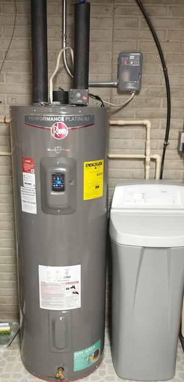

rmaynard 17,589 #104 Posted May 4, 2021 I'm in Florida on vacation at the moment. When I get back the water heater as well as the breaker is being replaced. Share this post Link to post Share on other sites
rmaynard 17,589 #105 Posted May 11, 2021 So, I'm back from vacation. Went to Home Depot. They gave me a new water heater. No problem. Installed it yesterday and had hot water again in less than an hour. Thanks for all the input. 1 Share this post Link to post Share on other sites

rmaynard 17,589 #114 Posted May 11, 2021 7 hours ago, Jeff-C175 said: Wait... what? They GAVE you a new heater free of charge? No pro-rating? I guess that lifetime warranty paid off then, didn't it ?! Yup. No paperwork. Warranty company not even involved. Assistant manager just said take the one like you are replacing and have a nice day. 1 1 Share this post Link to post Share on other sites

rmaynard 17,589 #117 Posted November 24, 2021 44 minutes ago, maxauthor18 said: The enemies of water heaters are impurities in your water that build upon its surface in scale. Scale changes the heat transfer from the surface of the heater to the water. Thanks for that. My water is softened, and when I drained the tank, there was no sludge in the bottom. I pulled one of the heating elements out prior to taking it back to Home Depot, and other than a little discoloration, it looked like new. UPDATE: We never found where the water was coming from, but after all was said and done, the warranty company ponied up with a check for $407.00 for my labor, transportation, and miscellaneous parts and fittings. 1 Share this post Link to post Share on other sites
