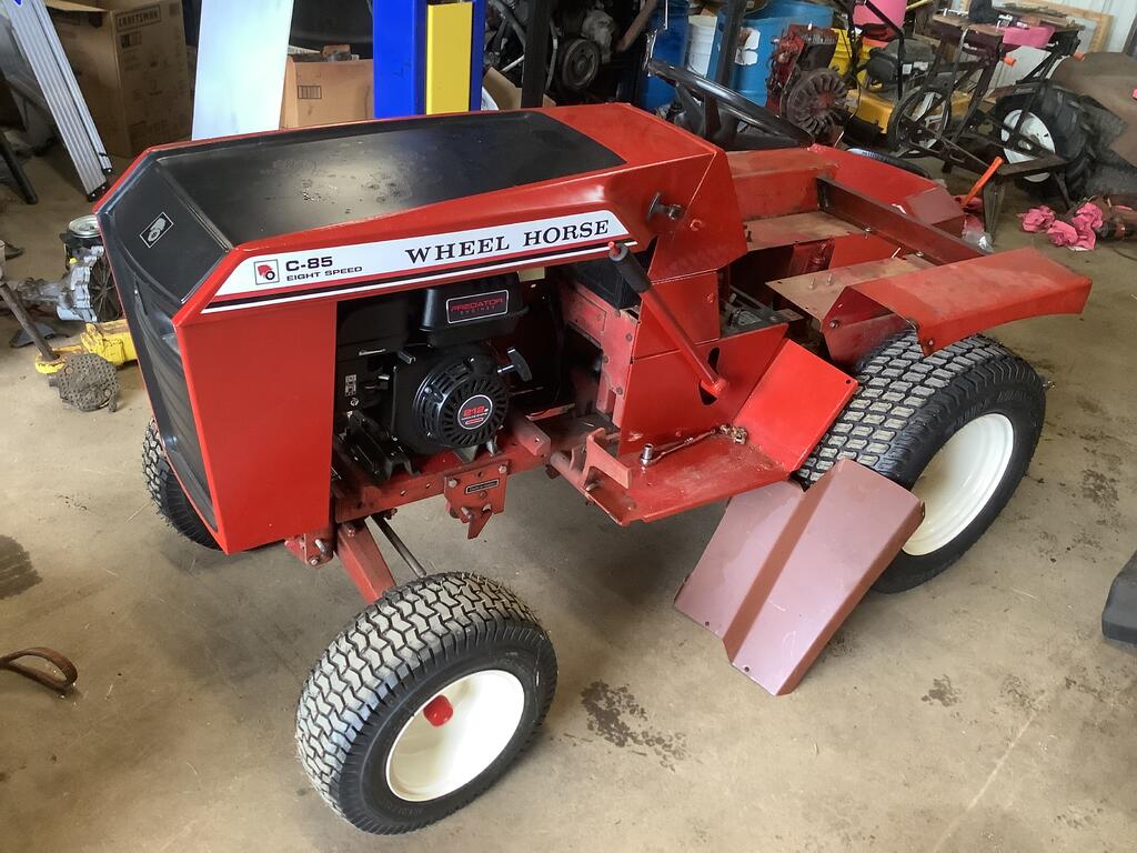

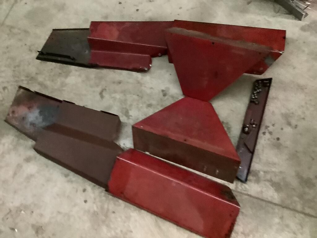

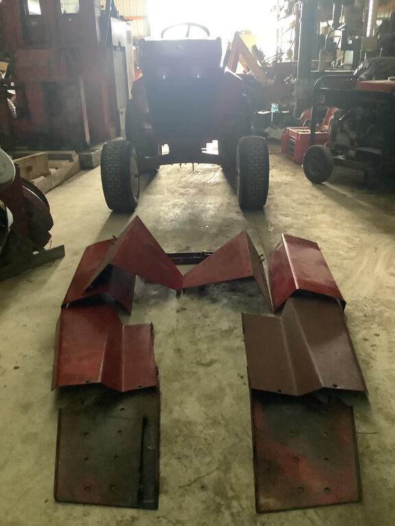

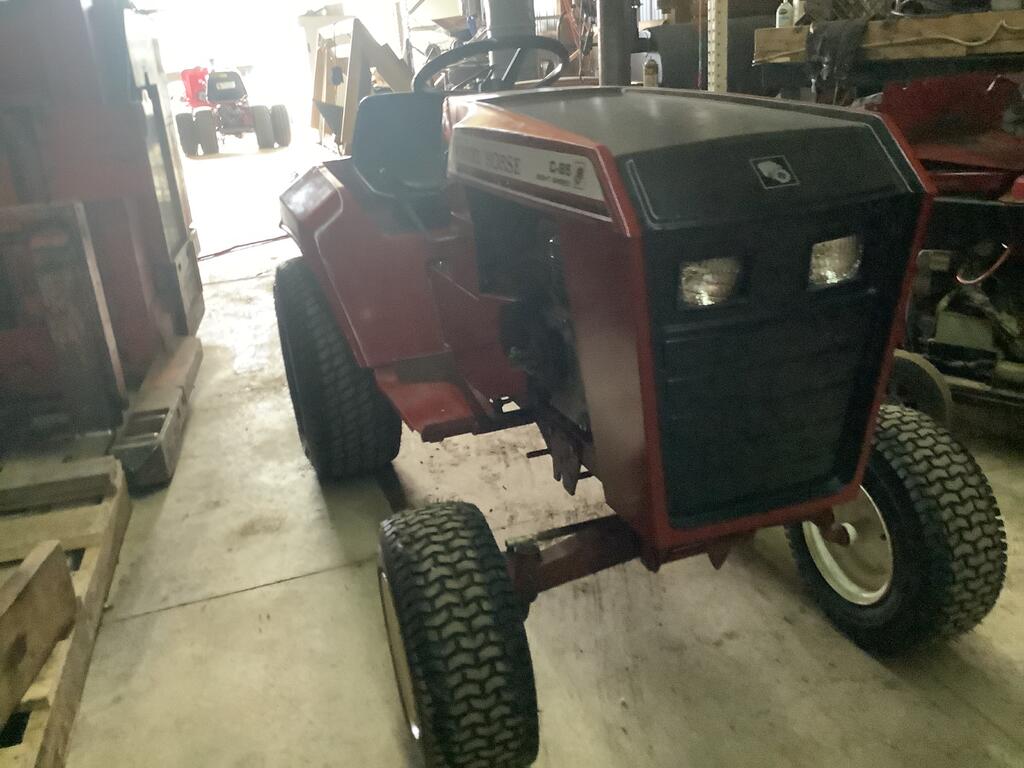

Pullstart 70,898 #153 Posted July 7, 2022 Here it is in the barn, all the GT14 fender stuff laid out. C-6.5, or GTC6.5? This isn’t just a bolt on swap I realize, there’s a lot of differences to consider. Frame width is 6.25” vs. 8”, different belt guards, different center counsel, dash stand, etc. With the predator engine, I don’t need the tractor fuel tank or supports…. I could even add what 3 point stuff I have off the GT14 and see what sticks! I like the brand new turf treads, but even considered 953/1054/GT14 4-lug hubs and 15” wheels and tires! 2 Share this post Link to post Share on other sites
SylvanLakeWH 31,849 #154 Posted July 7, 2022 Would look pretty cool with the gt stuff. I’d leave the tires though… show the nubbies off… 1 Share this post Link to post Share on other sites
Pullstart 70,898 #155 Posted July 7, 2022 38 minutes ago, SylvanLakeWH said: Would look pretty cool with the gt stuff. I’d leave the tires though… show the nubbies off… @WHX?? @19richie66 what do you fellas think about nubbies? 1 Share this post Link to post Share on other sites
SylvanLakeWH 31,849 #156 Posted July 7, 2022 Just now, Pullstart said: @WHX?? @19richie66 what do you fellas think about nubbies? That is the real reason to keep them on and show them off with pride… 1 Share this post Link to post Share on other sites

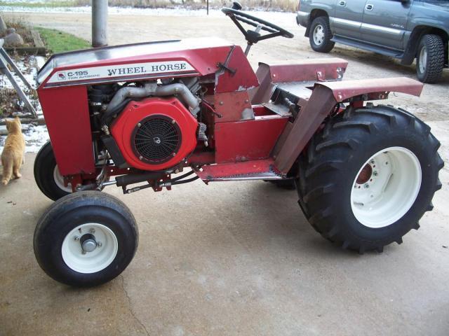

19richie66 17,930 #157 Posted July 7, 2022 Some people collect nubbies Funny you post this as I have this 417/12-A I mow with that needs a hood and sheetmetal. I have a lot of gt14 stuff laying around. Kinda scary we were both on the same page of the book about the same time. I’ll be interested to see what you come up with. I know Kelly put a gt14 fender set on a C195 diesel. That was neat. 3 1 Share this post Link to post Share on other sites
Pullstart 70,898 #158 Posted July 7, 2022 10 minutes ago, 19richie66 said: Some people collect nubbies Funny you post this as I have this 417/12-A I mow with that needs a hood and sheetmetal. I have a lot of gt14 stuff laying around. Kinda scary we were both on the same page of the book about the same time. I’ll be interested to see what you come up with. I know Kelly put a gt14 fender set on a C195 diesel. That was neat. Lowell has a mutt shown at last year’s J&C plow day. It’s got a mix of GT14 and Raider stuff too. As fun as it would be, I’d really like to make it look like a factory job. Share this post Link to post Share on other sites
19richie66 17,930 #159 Posted July 7, 2022 This is fantastic. It’s how I would do it. Kelly did a jam up job on it. 2 5 Share this post Link to post Share on other sites
Pullstart 70,898 #160 Posted July 7, 2022 2 minutes ago, 19richie66 said: Kelly That just guarantees the fact that it needs 15” wheels and tires to finish the rear! And a 3 point 2 Share this post Link to post Share on other sites

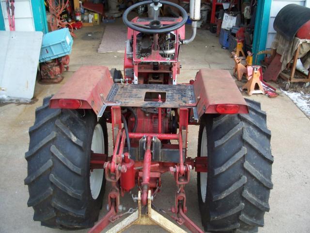

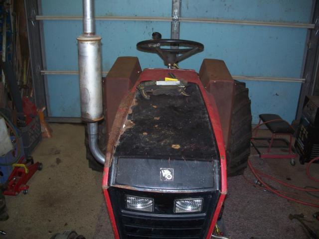

Pullstart 70,898 #162 Posted July 7, 2022 @19richie66 that front view is pretty awesome! Fits pretty awesome! From Kelly’s thread: Share this post Link to post Share on other sites
19richie66 17,930 #163 Posted July 7, 2022 (edited) I saved many a pictures from this build as I was hoping to do something similar down the road. We’ll see. I have most of the parts to do but never had a tractor to do it with. The one I mow with now will make a good candidate later on. For now I just keep collecting parts. I have a 520HC rear I was going to do the axle swap on so the width would work. Also have a D series three point, all the sheetmetal, the black hood and dash stand. Just no where to do it till I get somewhere to work set up. Edited July 7, 2022 by 19richie66 2 Share this post Link to post Share on other sites

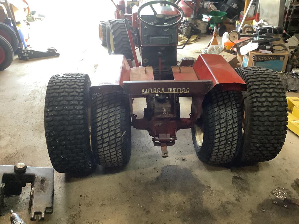

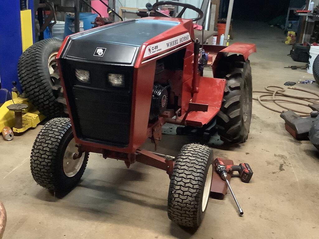

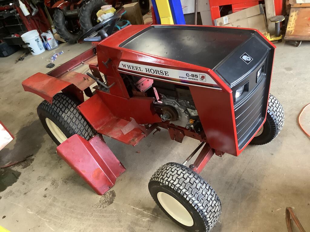

Pullstart 70,898 #167 Posted July 8, 2022 GT14 stuff fits fairly well! Obviously the tires are too small now! 3 Share this post Link to post Share on other sites
Pullstart 70,898 #168 Posted July 8, 2022 Maybe I need a GT-6.5 Dually…. 🤔 1 1 Share this post Link to post Share on other sites

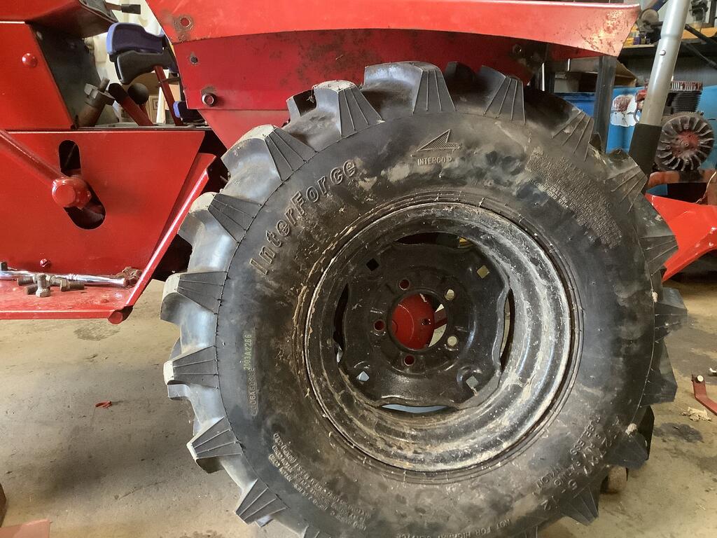

Pullstart 70,898 #169 Posted July 8, 2022 Here’s a 27” tall tire I might use for mock-up. I’ll need to modify the leg guards a bit. 2 1 Share this post Link to post Share on other sites
