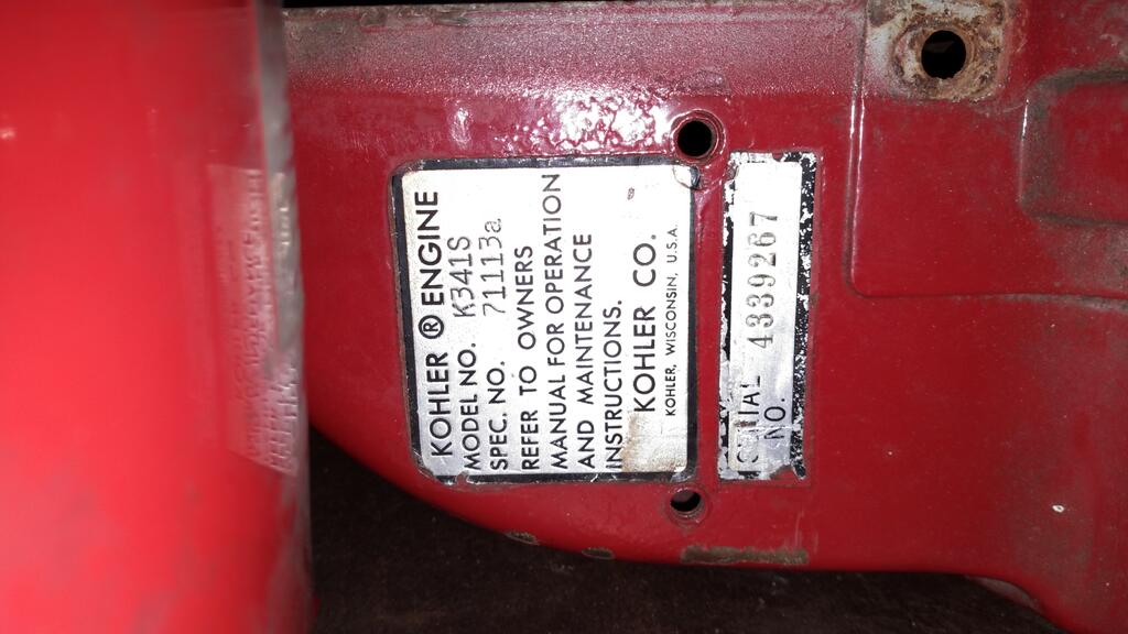

Bill D
K341. What did it come on originally?
Bill D
I bought this K341 and was wondering what it came on originally.  It's a 13 fin block and has been bored .020 over already.  It has a Kohler carb which may not be original.  Bill
Kohler  made serial 4339267 in 1972 and spec 71113a was used on the 1973 16hp Automatic model 1-0440.
It was also used on 1974 C-160 8-Speed model 1-0380 and C-160 Automatic model 1-0480
Garry
