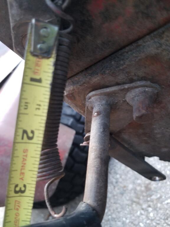

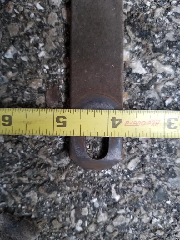

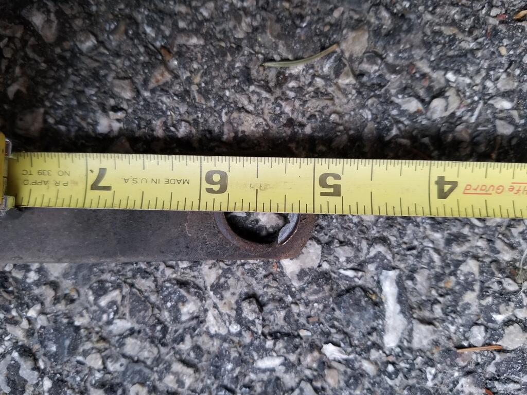

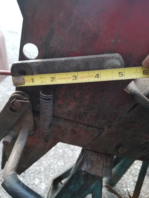

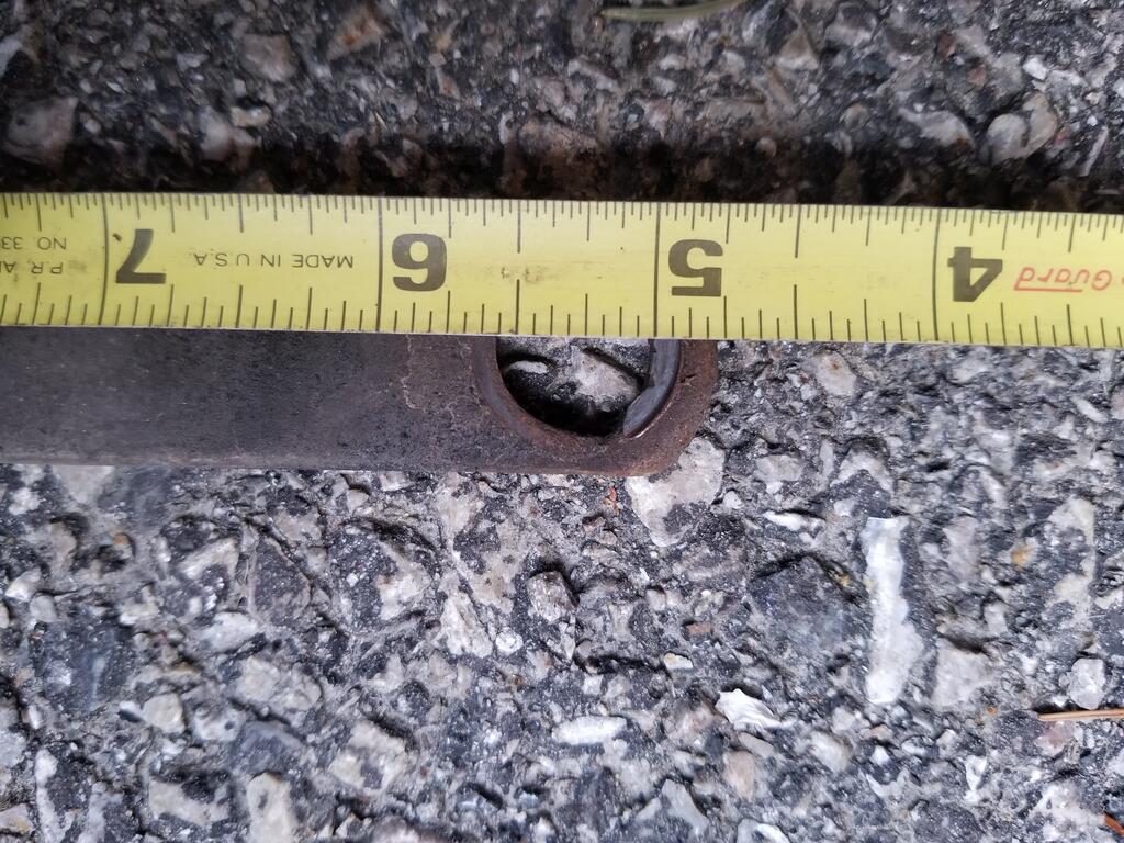

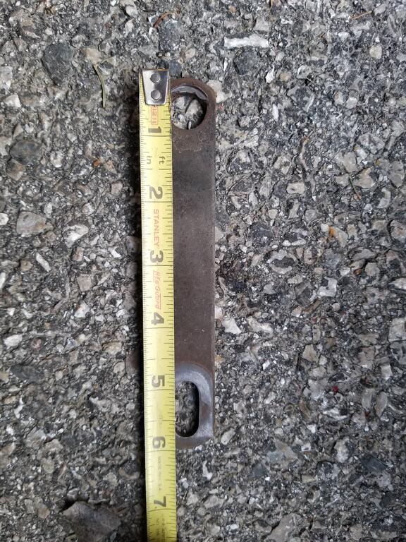

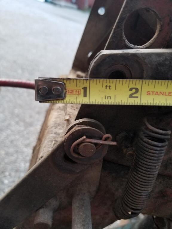

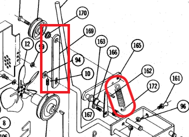

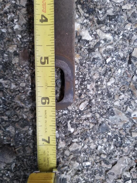

Gregor 4,848 #102 Posted April 20, 2021 While you have that thing tore down, would it be possible to get some measurements of this link? Mine was missing, when I got my 876, and I have been trying to replicate it. Part number 169 in the pic. Spring number 172 also please. Thanks Share this post Link to post Share on other sites
cafoose 3,862 #103 Posted April 20, 2021 36 minutes ago, Gregor said: While you have that thing tore down, would it be possible to get some measurements of this link? Mine was missing, when I got my 876, and I have been trying to replicate it. Part number 169 in the pic. Spring number 172 also please. Thanks Sure I can go out later and check it 1 Share this post Link to post Share on other sites

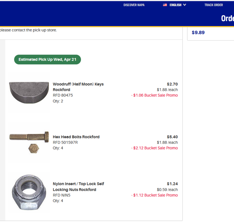

cafoose 3,862 #104 Posted April 20, 2021 1 hour ago, cafoose said: Trans gasket #5999 Pump gasket #5955 Axle seals #5958 Parking brake seal #5959 came in from @wheelhorseman Wix 51410 ordered from Fisher Auto Parts pickup tomorrow morning 1/4 x 1 woodruff keys in stock Fisher Auto Parts 10w-40 oil picking up tomorrow 5/16 x 18 nylock nuts in stock at Lowe's picking up tomorrow. Correction ordered grade 8 bolts thanks @pfrederi, nylock nuts, and woodruff keys from NAPA. NAPA wanted $16 for a filter and I got a Wix from Fisher for less than half the price Share this post Link to post Share on other sites
cafoose 3,862 #105 Posted April 21, 2021 @Gregor hope this helps 1 Share this post Link to post Share on other sites
Gregor 4,848 #106 Posted April 21, 2021 13 minutes ago, cafoose said: @Gregor hope this helps That's perfect. 2 Share this post Link to post Share on other sites

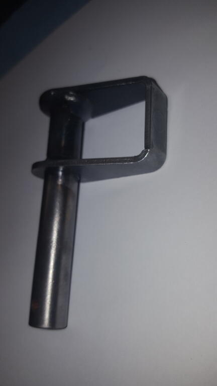

Gregor 4,848 #110 Posted April 21, 2021 @cafoose I made a new link using the measurements you provided. While mine did work, this one works better. I have been trying to get those numbers for weeks. again for the pics. 1 Share this post Link to post Share on other sites
