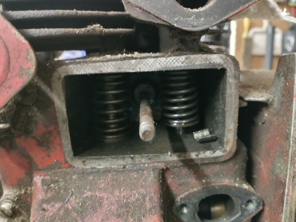

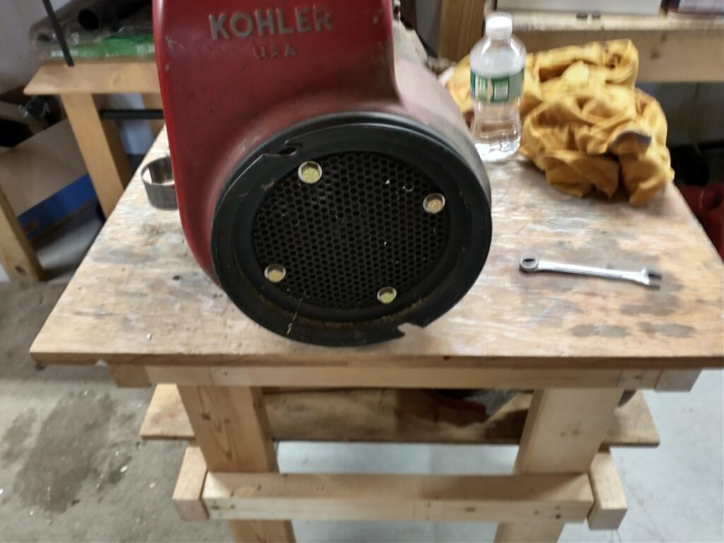

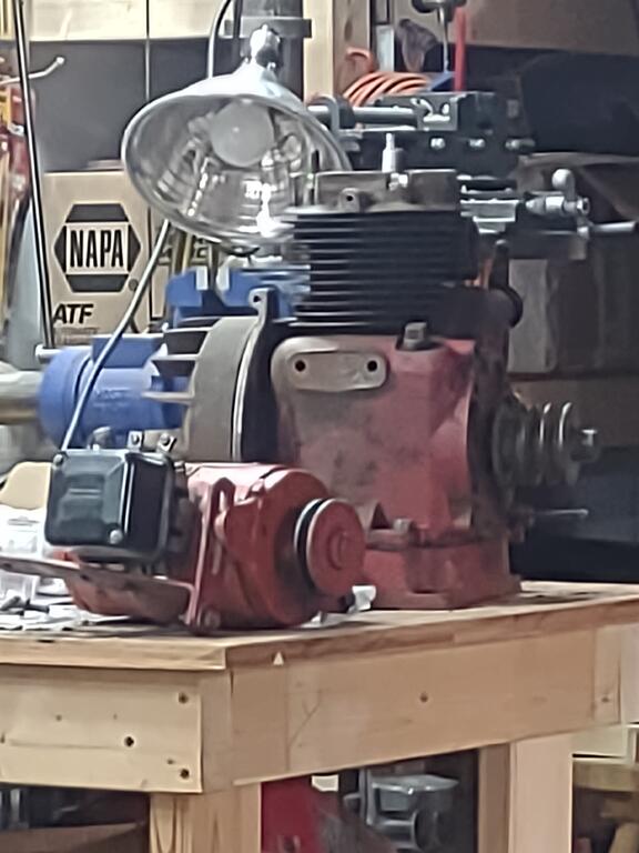

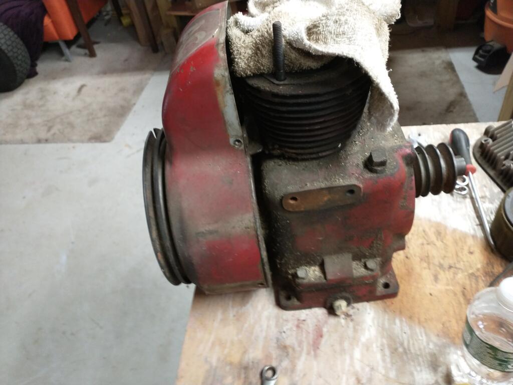

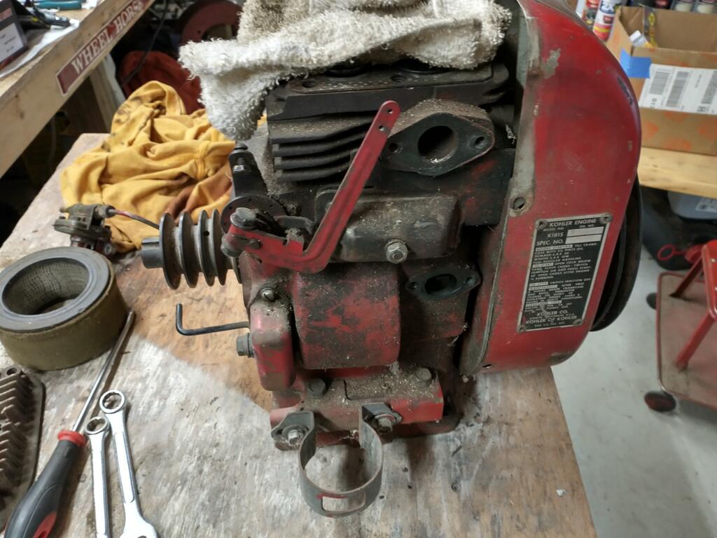

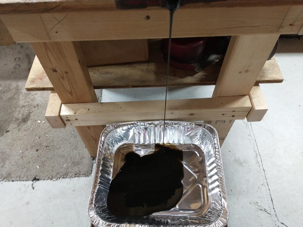

ebinmaine 80,974 #220 Posted February 23, 2023 Well folks. Back to the Millie for a bit here. @Oldskool @SylvanLakeWH BBT's next new old something to do... The 10 HP Tecumseh engine was always meant to be a temporary donor engine. We'll take a peak at the original engine which is of course a Kohler 8 HP. We'll also see about adding a few extra gears and a Limited Slip Differential. Swapping the 3 speed for a 6 speed. Yesterday Trina was working from home and it was pretty quiet on the 'puter so she went around the acreage here and gathered up the engine and Starter/generator. She drained the (her words) black goo - from the oil pan. Removed the carb, fuel pump, breather and points cover from the engine. We know the engine had no compression and we know it was because of the exhaust valve being caked with carbon. We'll remove the valves, clean em up, check clearance. Drop the oil pan off and look around in there. After doing some assessment we'll decide what level of work and parts replacement is necessary. 2 5 Share this post Link to post Share on other sites
Handy Don 17,571 #221 Posted February 23, 2023 16 hours ago, ebinmaine said: Noticing the long shaft on the PTO side even with the three-sheave pulley on there. 1 Share this post Link to post Share on other sites
ebinmaine 80,974 #222 Posted February 23, 2023 3 minutes ago, Handy Don said: Noticing the long shaft on the PTO side even with the three-sheave pulley on there. Good eye. I'll check the other two she has with that engine. Share this post Link to post Share on other sites
ebinmaine 80,974 #223 Posted February 24, 2023 8 hours ago, Handy Don said: Noticing the long shaft on the PTO side even with the three-sheave pulley on there. The others are like that as well. Share this post Link to post Share on other sites
Handy Don 17,571 #224 Posted February 24, 2023 Now I’m going to have to climb in to the store room and check on my 8hp! 1 Share this post Link to post Share on other sites

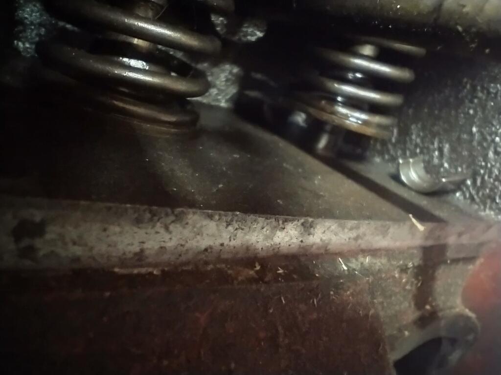

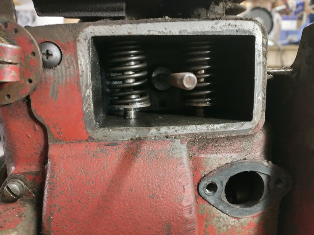

ebinmaine 80,974 #225 Posted February 26, 2023 Trina finished cleaning up the bulk of the muck from the block. Removed the oil pan so we could take a look at the engine bottom end. Looks good. She reinstalled the oil pan. We got the exhaust valve keepers put back in. Checked proper clearance on both valves. Exhaust - .017 Intake - .007 She installed the fuel pump and breather. I hand planed the cylinder head just a bit. Happy to see it's barely out of contour. We torqued it down to 18 or 20 ft lbs. 2 3 Share this post Link to post Share on other sites
