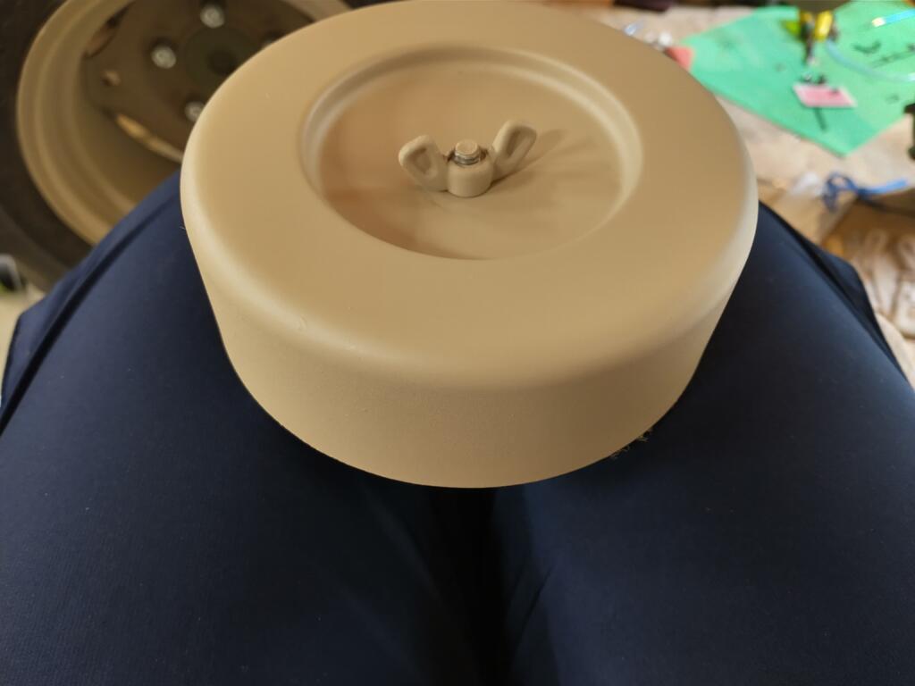

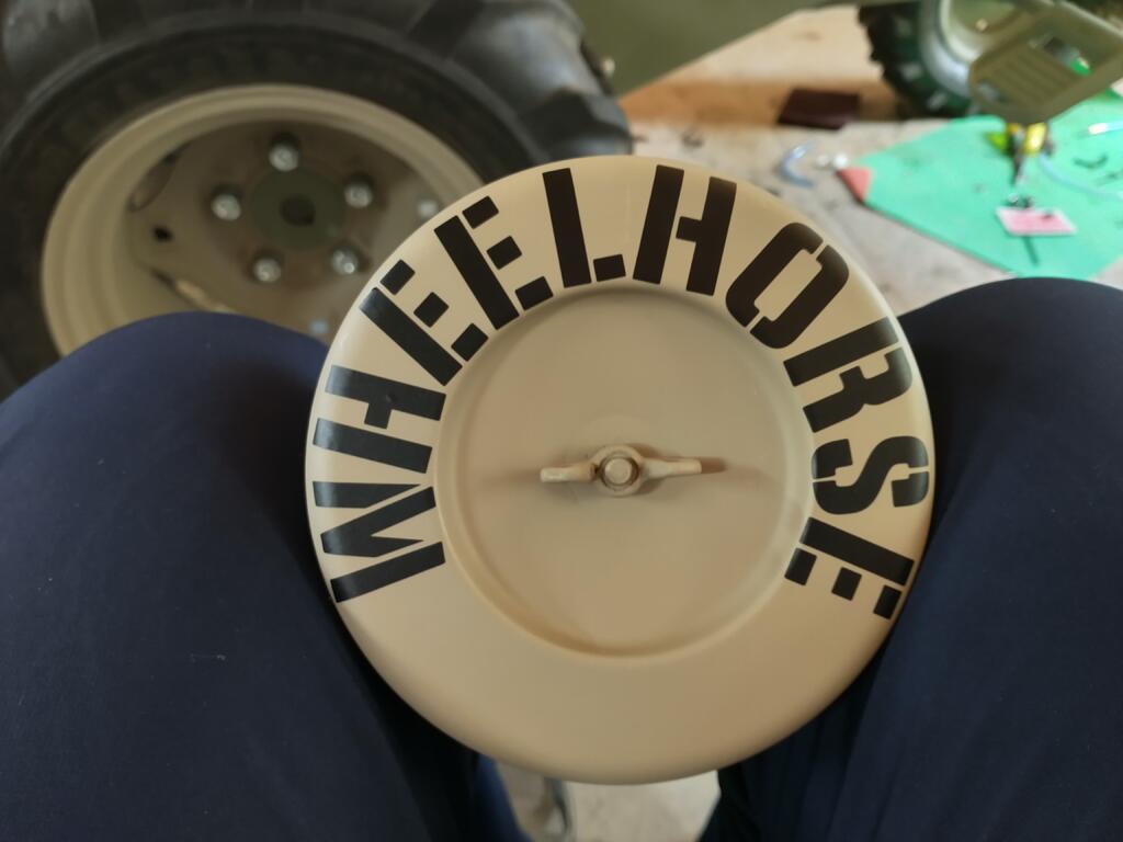

ebinmaine 80,974 #126 Posted September 6, 2021 Today we're installing the breather and carb. We had to rob the air cleaner from her Pony tractor to use on Millie. I've placed an ad looking for one. Here's The Paint Department's redecoration of said air cleaner: 5 9 Share this post Link to post Share on other sites
Handy Don 17,571 #127 Posted September 6, 2021 Excellent work by the Paint Department! 1 Share this post Link to post Share on other sites
Oldskool 6,678 #128 Posted September 6, 2021 Looking sharp. Your paint department is top shelf Eric. 1 Share this post Link to post Share on other sites

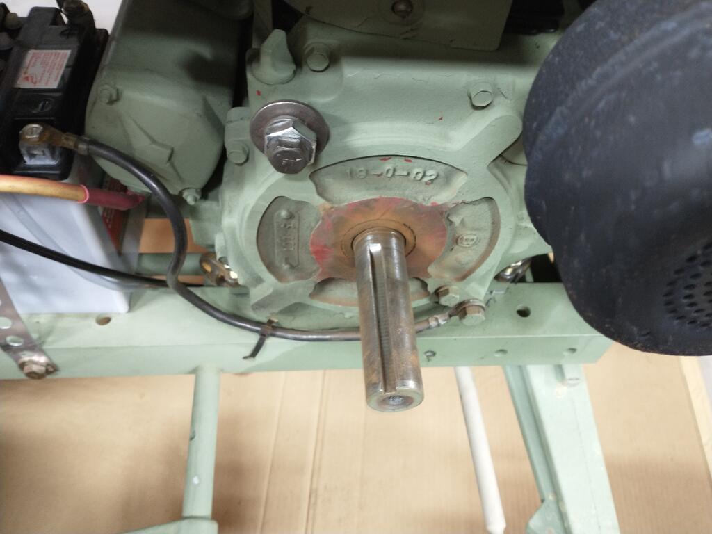

ebinmaine 80,974 #132 Posted October 26, 2021 We got back to Millie for a bit tonight. I'd ordered a 2-1/2" od engine pulley in an effort to slow her down some. Stock size is 2" so it'll be a hair faster but much more manageable. Trina changed the size of the spacers on the lower steering shaft hoping to tighten it up some. Made a little difference. The pillow block will need to be bored and bushed because the upper steering shaft slides side to side but not fore and aft. Next will be to get a shorter belt on there, weld up the belt guard and see how it goes. It starts and drives ok... At best. 3 Share this post Link to post Share on other sites

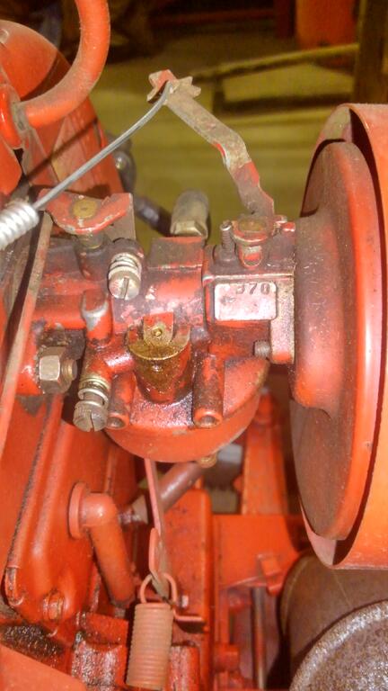

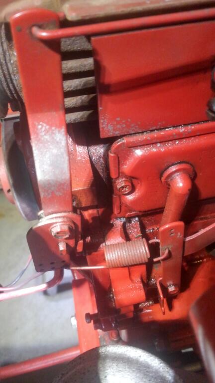

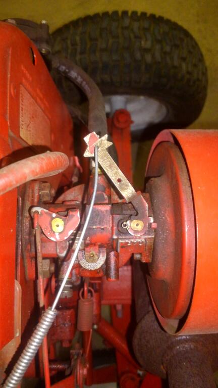

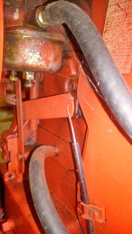

Rusty Tinsnips 477 #133 Posted October 27, 2021 On 9/10/2021 at 12:51 PM, ebinmaine said: Also, I don't know where the springs and linkages are supposed to be connected and I'm only assuming that whatever previous owner hadn't changed anything. What engine is that? I have an HH100 that I could put up pics of the governor linkages if you need it. Share this post Link to post Share on other sites
ebinmaine 80,974 #134 Posted October 27, 2021 36 minutes ago, Rusty Tinsnips said: What engine is that? I have an HH100 that I could put up pics of the governor linkages if you need it. It is an HH100. Your pics would be VERY helpful. Share this post Link to post Share on other sites
Rusty Tinsnips 477 #135 Posted October 28, 2021 Here are a couple old ones that I have on my computer at work. I will get some better ones later when I get home. 1 1 Share this post Link to post Share on other sites

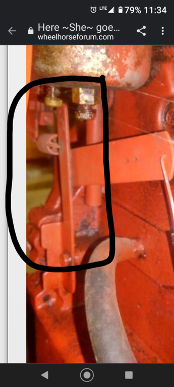

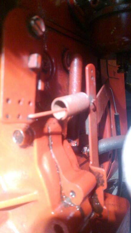

ebinmaine 80,974 #136 Posted October 28, 2021 40 minutes ago, Rusty Tinsnips said: Here are a couple Much appreciated. If I could get another pic that shows the spring in the following picture, and where it goes to and from, that would be fantastic. Share this post Link to post Share on other sites
Rusty Tinsnips 477 #137 Posted October 28, 2021 1 minute ago, ebinmaine said: If I could get another pic that shows the spring in the following picture, and where it goes to and from, that would be fantastic. You got it. Give me a few hours and I'll have it up. 1 Share this post Link to post Share on other sites
Rusty Tinsnips 477 #138 Posted October 28, 2021 These help? 1 Share this post Link to post Share on other sites
ebinmaine 80,974 #139 Posted October 28, 2021 3 minutes ago, Rusty Tinsnips said: These help? Perfect! Thank you. Share this post Link to post Share on other sites
Rusty Tinsnips 477 #140 Posted October 28, 2021 Note the screw at the bottom going through the block flange area. Looks like some kind of limiter like the low idle stop screw on the carb. 1 Share this post Link to post Share on other sites
Handy Don 17,571 #141 Posted October 28, 2021 2 hours ago, Rusty Tinsnips said: These help? @ebinmaine the Tecumseh carb manual also had a sequence for making sure the governor is properly adjusted. On the one I just worked on, it was off by about 5-7º and once fixed, the hunting just stopped. Tecumseh Carburetor Identification & Troubleshooting SM.pdf 2 Share this post Link to post Share on other sites
ebinmaine 80,974 #142 Posted October 28, 2021 26 minutes ago, Handy Don said: @ebinmaine the Tecumseh carb manual also had a sequence for making sure the governor is properly adjusted. On the one I just worked on, it was off by about 5-7º and once fixed, the hunting just stopped. Tecumseh Carburetor Identification & Troubleshooting SM.pdf 2.85 MB · 0 downloads Excellent Don. Thanks for posting that. Share this post Link to post Share on other sites

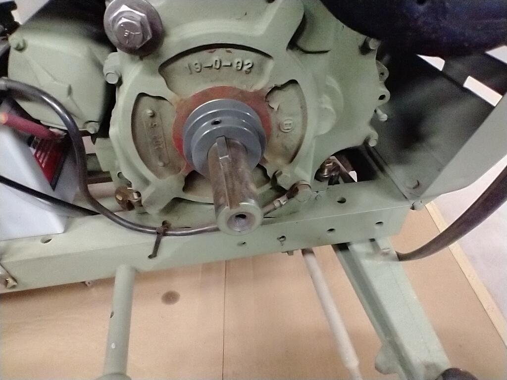

ebinmaine 80,974 #143 Posted November 10, 2021 On 10/28/2021 at 2:55 PM, Rusty Tinsnips said: These help? Thanks again for the pics. We got back to working on Millie again today. Governor appears ok and the linkages are on correctly. @Handy Don Interestingly enough the carb is much less angry now. Not sure why. Perhaps setting with good clean NON E gas?? It actually considers idling down now... Trina changed out the engine drive pulley for a smaller more reasonable one (2.5"). The old pulley was 4". Too large for a working tractor for us with the rough terrain. I welded the end of the belt guard back together after having cut it to make room for the 4" pulley. Trina used J. B. Weld to fill a hole I couldn't get with the Lincoln tombstone stick welder, then tossed some paint on the engine and belt guard. Next up I'll be testing the engine's charging system then adding mid and rear hitches for Wheelhorse implements. 2 8 Share this post Link to post Share on other sites

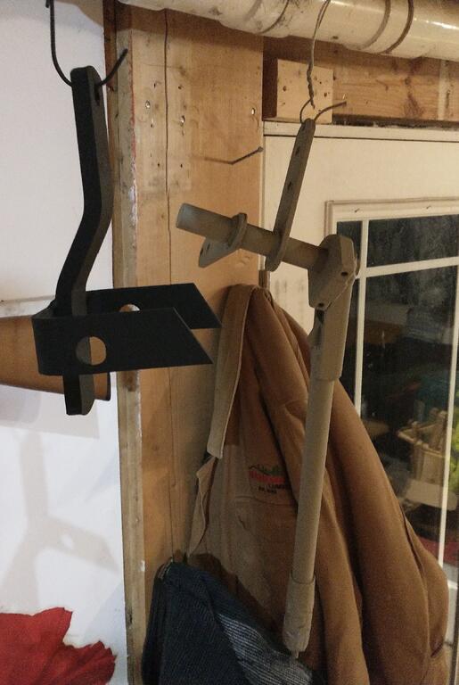

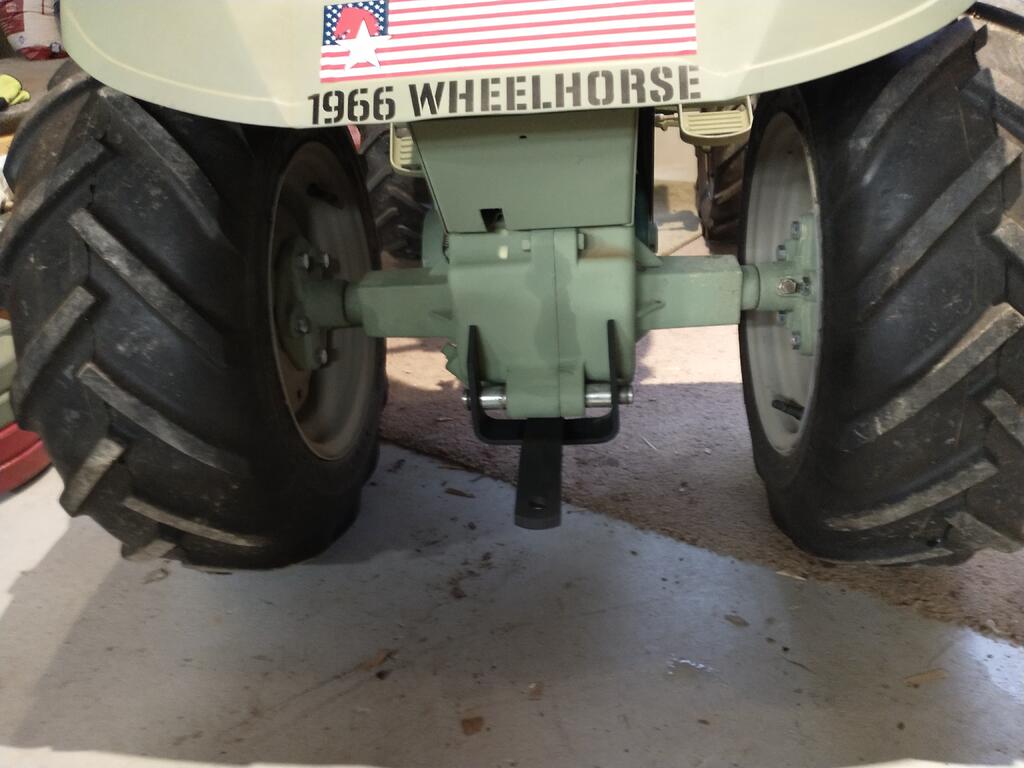

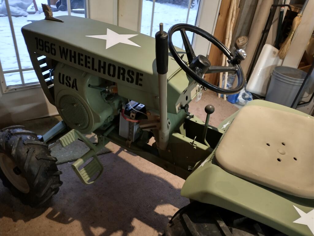

ebinmaine 80,974 #148 Posted December 12, 2021 Trina painted the implement control handle/lever and a rear hitch for Millie today. One step closer to it being a plow tractor for her. 3 1 Share this post Link to post Share on other sites

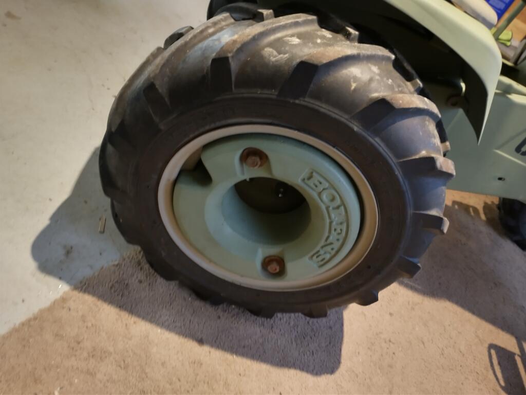

ebinmaine 80,974 #149 Posted December 19, 2021 Trina got the hitch, lift lever and wheel weights installed today. We don't have chains to fit this tractor. (Thought I did but they're too short. ) Other than that it's ready to plow snow. 1 2 Share this post Link to post Share on other sites

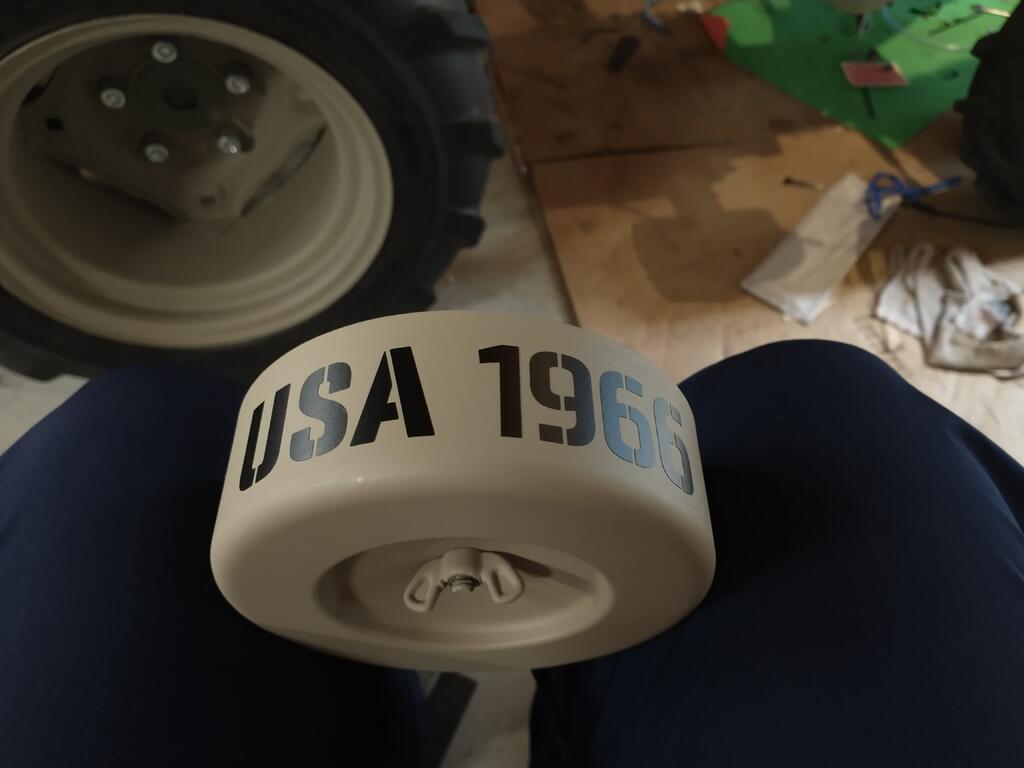

Snoopy11 5,731 #150 Posted December 19, 2021 I wish to know where you got the 1966 WheelHorse decal. I want a 1967 WheelHorse decal just like that... Don 1 Share this post Link to post Share on other sites
