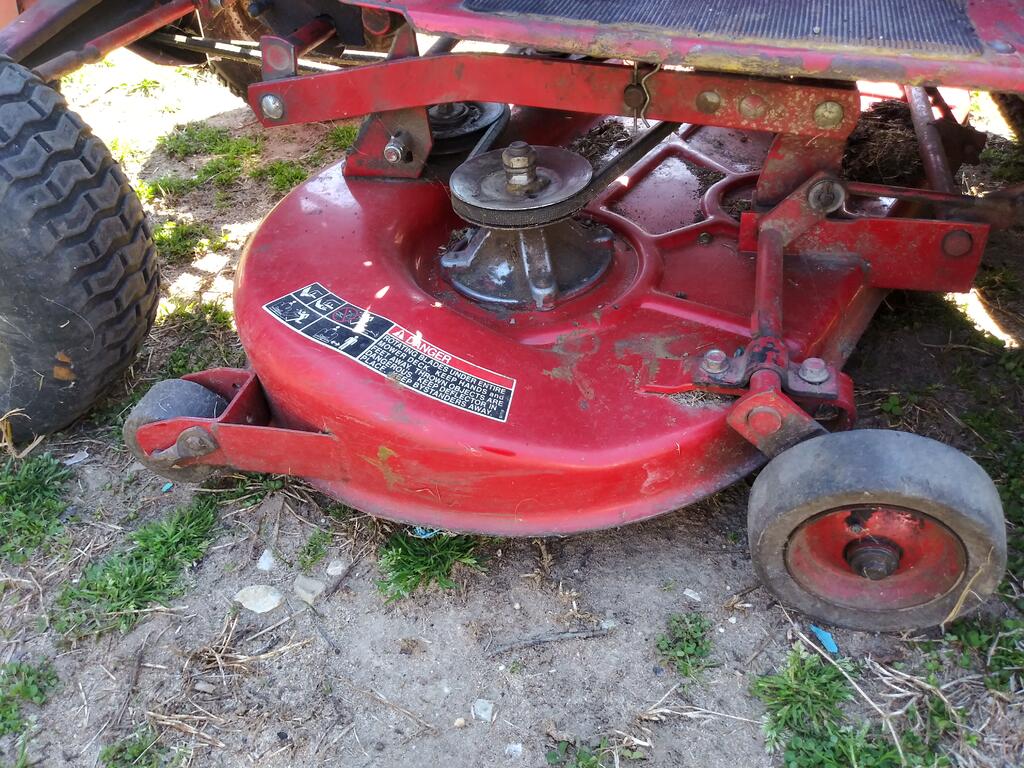

DANELMER 2 #1 Posted April 1, 2021 Hey all I just got my first wheel Horse. It has the 37 inch mower on it and I want to put a 48 inch mower on it. It is a 1990, and I want to know if the mower in the picture will fit on it. Thanks Share this post Link to post Share on other sites
Pullstart 71,367 #2 Posted April 1, 2021 That LOOKS like it’ll fit just fine. There are some various decks that only fit a GT-14 because of tire size and roller location I believe. 1 Share this post Link to post Share on other sites
peter lena 10,090 #3 Posted April 1, 2021 danelmer, agree with pullstart on the probable fitting , you also might have the 36 " deck , more info and pictures on your horse would help . its the common yet different lift frame that makes this possible . also realize that there are S/D side discharge and R/D rear discharge decks . also these decks need a thorough look see before use, pete 1 1 Share this post Link to post Share on other sites
clueless 3,440 #4 Posted April 1, 2021 Look like a 48" sd deck and it should fit fine. If you have the 37 sd deck on the tractor you may have to change the pulley set up on the mule drive and get the right belt. 1 Share this post Link to post Share on other sites
Ed Kennell 47,600 #5 Posted April 1, 2021 (edited) If your 312 has the 6" front wheels, the 48" SD should fit. The 12HP will be working pretty hard to spin the 48' deck. You may find you will have to mow more often and run a lower gear than with the 37" deck. Just sayin....Big is not always more efficient. Oh, to the Edited April 1, 2021 by Ed Kennell 3 1 2 Share this post Link to post Share on other sites

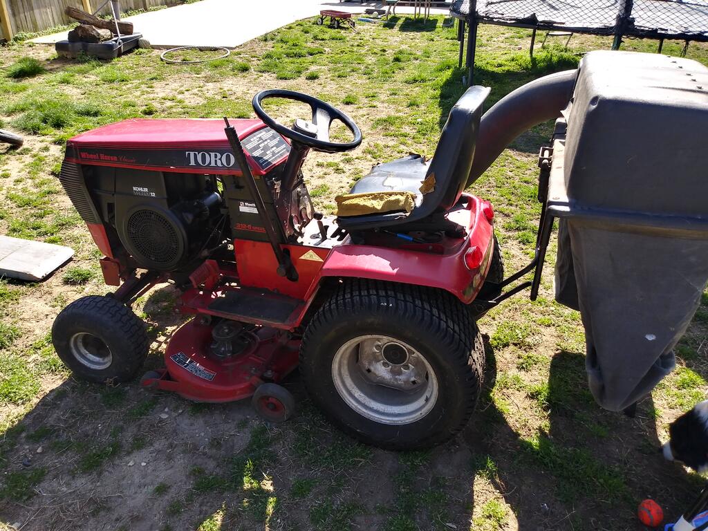

DANELMER 2 #21 Posted April 4, 2021 Here are some more pictures of the 312-8. I am amazed at this machine and still can't believe I almost passed it up due to the size of the mower! I'm looking forward to putting this baby to work! I'll be mostly mowing and towing. 1 Share this post Link to post Share on other sites

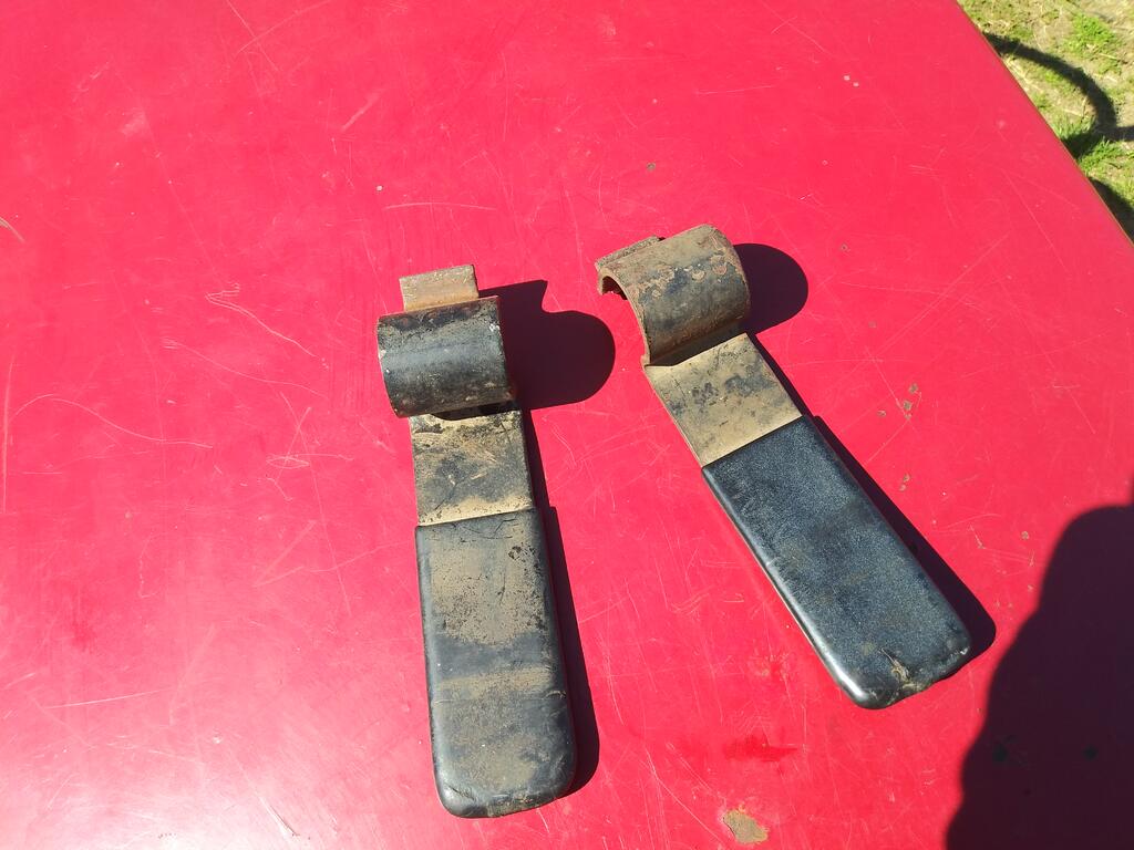

DANELMER 2 #23 Posted April 8, 2021 @peter lenaany idea what these clips are? I'm imagining they are for the bagger. I put the bagger on and as soon as I started mowing it fell off. I'm not sure how they attach the chute to the deck. Share this post Link to post Share on other sites
peter lena 10,090 #24 Posted April 8, 2021 @DANELMER, not familiar with that deck, one of the other members that is , will send you related info on them . also agree with TOM2P , on the 42" deck mounting on the tractor , I have 3 of them with 42" R/D decks , makes things very easy , to operate and service. pete 1 Share this post Link to post Share on other sites
Brockport Bill 2,483 #25 Posted April 11, 2021 i have virtually the same tractor since I bought it new in 1989 - 32 years of good service - its the 312-8 with 37 inch side discharge and the same bagger -- those clips you asked about are for the bagger hood to clip onto the bagger frames when you close the hood-- i haven't had mine attached for years -- depending on your lawn and yard size the 37 inch is great - very nimble --- i have 4/10ths acre - mow 1-2-3 times per week depending on season - I mow in 2nd gear at pretty tall cut height -- don't take much off except top of grass blade ---- best for health of lawn -- if on occasion the lawn is tall i go down to 1st gear - don't know what the tractors reaction would be to a 48 inch -- But i can tell you this -- i have used deck, tiller, plow and roller....... including on hills - never once did that tractor not have enough power ----- if you have trees and leaves you'll love the bagger --- i use it up to 3 times per week in fall just vacuuming up leaves - -FYI - I just took my mower apart after 32 years and had it sand blasted, then 2 coats of primer and 2 coats paint - at Auto body shop - -putting it back together tomorrow - looks new - one important suggestion --- be sure to clean under deck after each use --especially the clump of grass that sticks to underneath front of shell right in the middle - or the cut will loose quality, plus the air flow is reduced meaning the lift of grass reduced - and especially if you are cutting tall grass or doing heavy leaves. Enjoy !!! 1 Share this post Link to post Share on other sites
