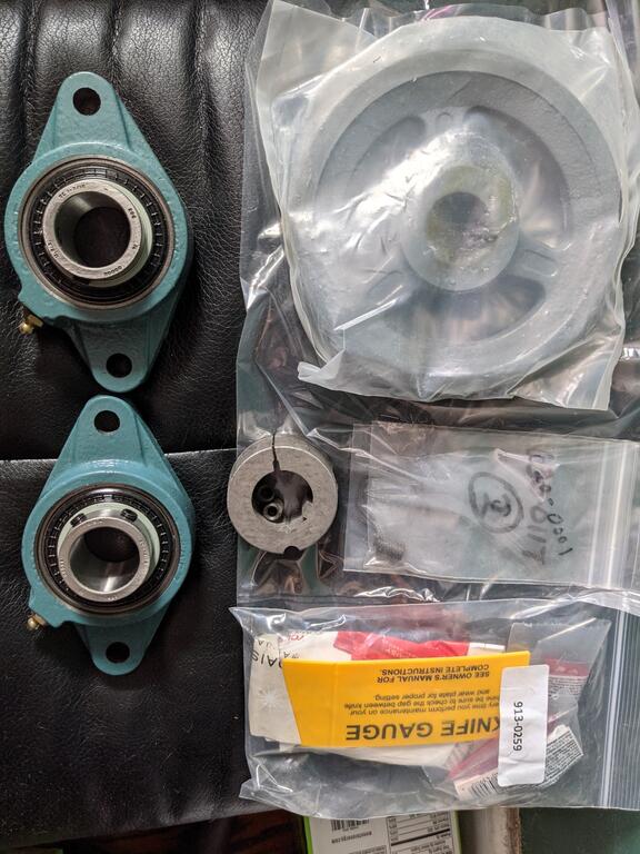

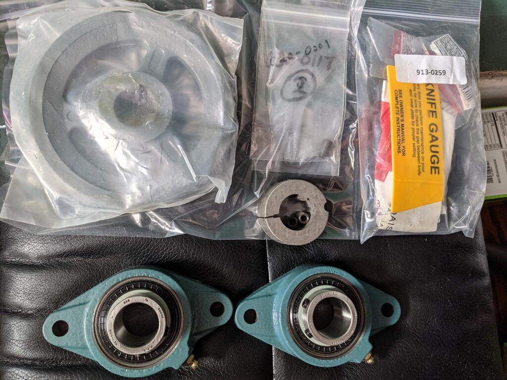

seuadr 490 #127 Posted June 8, 2021 Yay! my bearings came today! I got both outboard bearings, a new drive pulley, the tapered bushing for the chipper wheel and a new clips and set screws. Also got a new knife kit soon as i get my oliver 550 steering sorted, i should be able to get this thing running! 1 Share this post Link to post Share on other sites

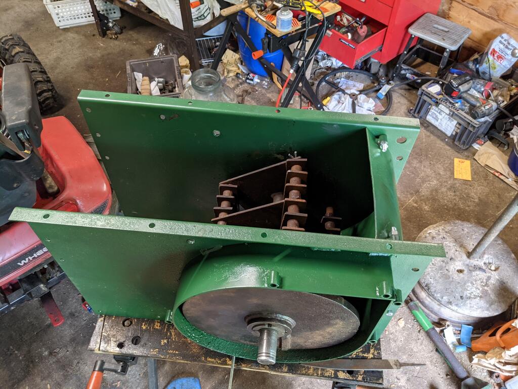

seuadr 490 #128 Posted June 29, 2021 finally had time to start to put this all back together. the bearings were on backorder, but, i have them now. 1 Share this post Link to post Share on other sites

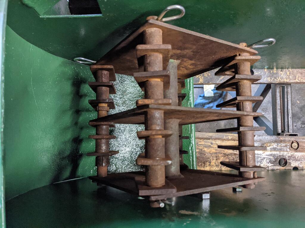

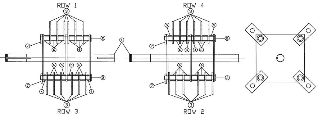

gwest_ca-(File Mod) 12,510 #130 Posted June 30, 2021 Hope the hair pins holding the flail shafts in are temporary for assembly. Have you seen the flail spacer drawing? 1 Share this post Link to post Share on other sites
seuadr 490 #131 Posted June 30, 2021 5 minutes ago, gwest_ca said: Hope the hair pins holding the flail shafts in are temporary for assembly. Have you seen the flail spacer drawing? re: the pins - they are, yeah. i am debating putting in straight pins as the supplier said they no longer have a source for the tapered pins and suggested that i use straight ones, but i feel like i should have something a bit tougher than big box pins so was thinking about exploring the hardware store's pin section to see what they have that might work better. in regards to the spacing, I believe that is how i have them, except that i am missing a couple of the narrower spacers from "row 3" - i was actually considering seeing if i could cut to size some pipe for the purpose. I only have 1 bearing on right now, so i can remove the other side to take the rows on and off. 1 Share this post Link to post Share on other sites

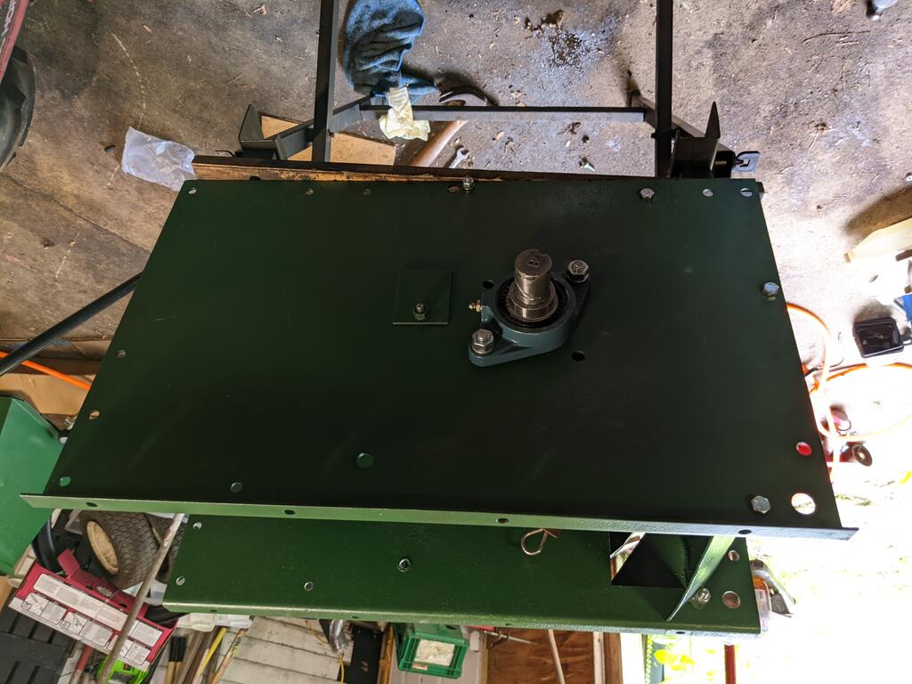

seuadr 490 #133 Posted June 13, 2022 On 5/14/2022 at 7:51 AM, ebinmaine said: @seuadr Any updates on this rebuild? Did you ever get or do you still need these measurements? i'm at a stage where i got the non chipper outboard bearing in, the shredder portion and the chipper wheel in, and i got side tracked by a bunch of other things and still need to get the other outboard bearing in. i do not have those measurements, but, since it is still in pieces, while i need them, i don't need them anytime soon 1 Share this post Link to post Share on other sites

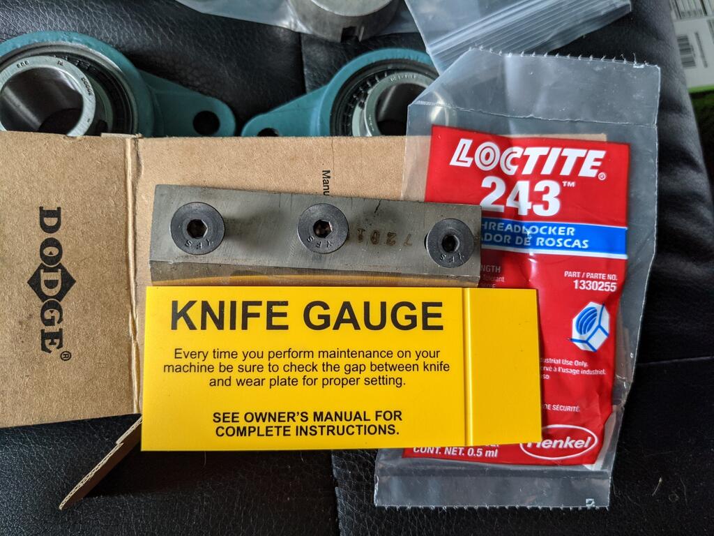

seuadr 490 #144 Posted May 15, 2023 11 minutes ago, gwest_ca said: I heat the heads with a map gas torch to release the Loctite on the threads sometimes twice. First one burns out the debris in the hex hole which is mostly pine pitch. I use a 1/2" manual impact driver to loosen and tighten the screws. how close do you need to get the "go/nogo" gauge when checking the blade? I'm not really clear on how to use it (Mackissic sent me one.. maybe a measurement would be easier for me..) Share this post Link to post Share on other sites

gwest_ca-(File Mod) 12,510 #148 Posted May 16, 2023 On 5/15/2023 at 9:57 AM, seuadr said: how close do you need to get the "go/nogo" gauge when checking the blade? I'm not really clear on how to use it (Mackissic sent me one.. maybe a measurement would be easier for me..) The anvil in the chute is what gets adjusted. I used a piece of 1/16" x the length of the knife aluminum flat stock as a gauge. The hard part is getting the anvil screw heads cleaned out to take an Allen wrench. Heat helps soften the pitch and wood residue from the holes. It took me hours. Placed the aluminum between the knife and the anvil - held it tight and tighten the nuts on the screws. I suspect the early DR chippers and shreaders were supplied by Mackissic. Their replacement knives and flails may be a more economical option. 1 Share this post Link to post Share on other sites
