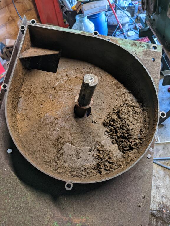

seuadr 490 #53 Posted April 24, 2021 (edited) 2 hours ago, gwest_ca said: I use Never seize on everything. The 3 bolts that secure the anvil for the chipper knife are flat head and require an Allen wrench. The problem with that is my hex holes were filled with wood and pitch residue that had turned to concrete. Took for ever to get them cleaned out so a wrench would go completely in. Just a heads up so you can start soaking and digging them out now. Garry yeah, mine are real gunked up. the housing around the wheel was full of crud too, took quite a while to get it all scraped out. it looks like the chipper wheel is removable from the shaft, but then again, it looked like that bearing assembly should remove easily too i've contacted the company about parts distribution since they don't seem to sell factory direct. that bearing assembly looks like it is a one piece deal, the collar is part of the bearing - it appears to keep it appropriately positioned on the shaft, which in turn looks like it keeps the chipper wheel appropriately positioned on the shaft. so i asked their engineering dept if that assembly is still available, and if not - if i could use a regular 1 3/16 bearing and shim it to get the same result. they were very prompt on their reply about the chute - which is no longer available, but the currently available one can be adapted easily. looks like it might be about 100 dollars, which isn't that bad, but, i'll probably try it out without first and see if i am OK with that operation. mainly i'd like to have a guide that i can start to feed a branch in on and have it stay in place - i can probably accomplish that a different way - but, can i do it for less than 100 dollars i guess is the question (i would think so?) Edited April 24, 2021 by seuadr 1 Share this post Link to post Share on other sites

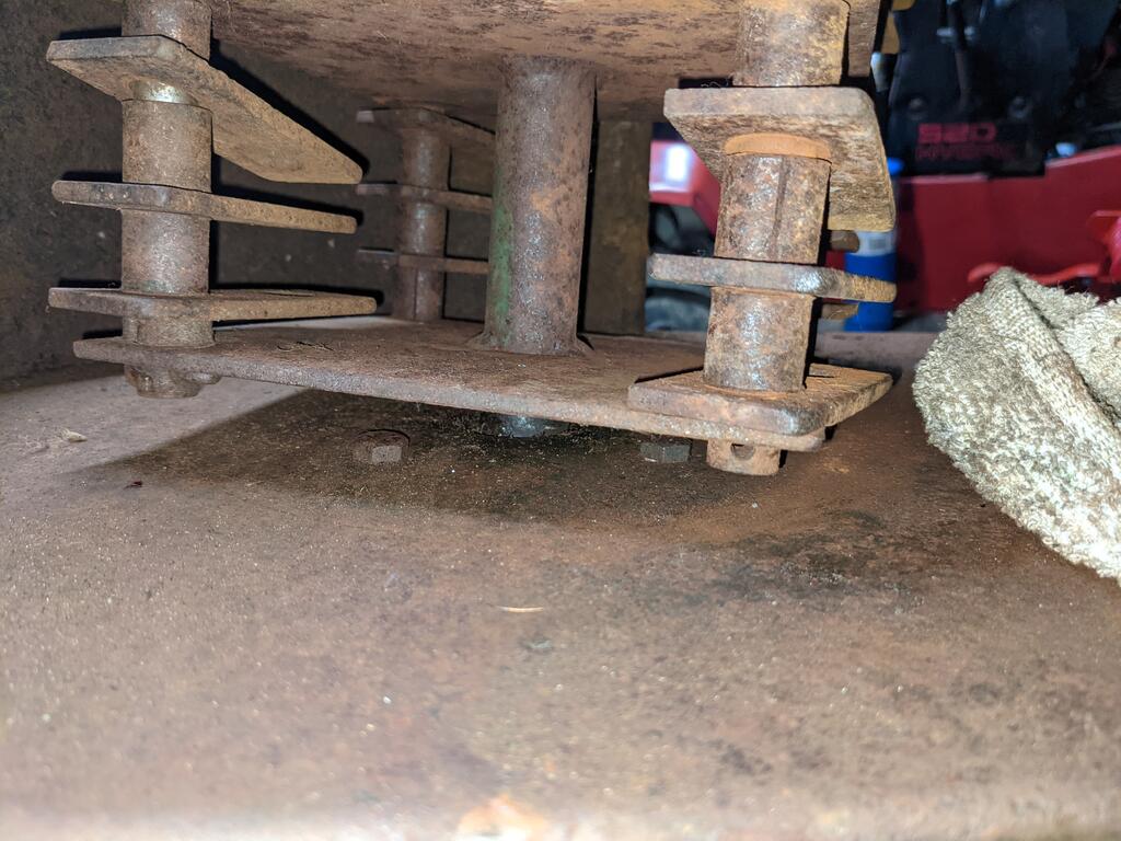

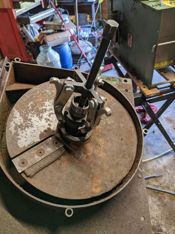

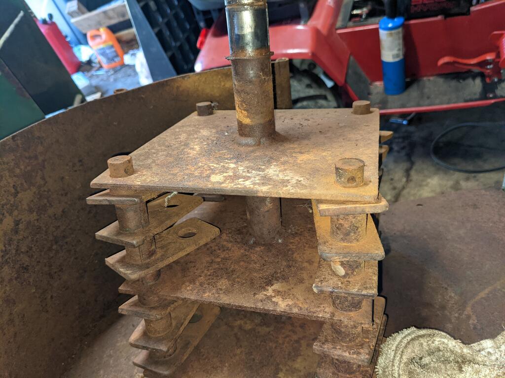

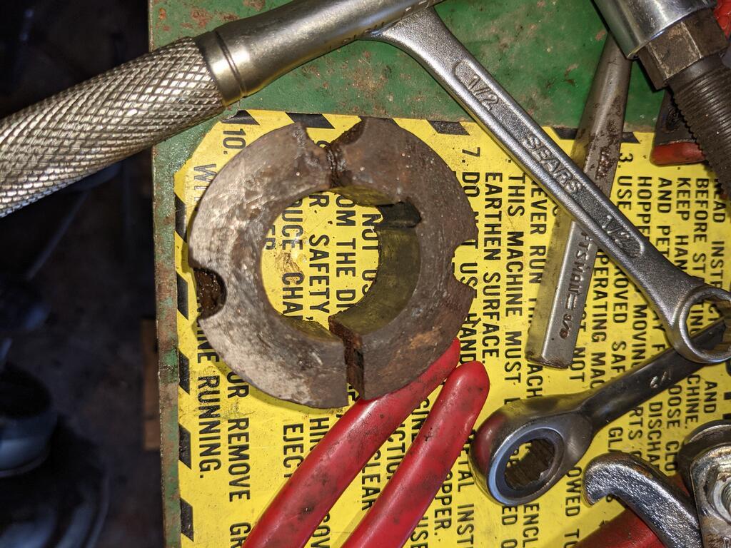

seuadr 490 #57 Posted April 25, 2021 Got the bearing race off. Glad i did, too - all of the pins are missing from the hammer rods: Dumb luck that nothing came loose when i tested it out. Lots of crud behind the chipper wheel even after i blew it out. Unfortunately the collar that holds the chipper wheel cracked when i dropped it: Just add it to the list i guess. 😄 1 Share this post Link to post Share on other sites

gwest_ca-(File Mod) 12,510 #60 Posted April 26, 2021 I was missing a few pins also when I got mine. Come to the conclusion that the previous owner did not realize they are taper pins and put some in backwards so some came out. To error on the side of caution I drilled the holes out to the largest diameter for standard cotter pins. Garry Share this post Link to post Share on other sites
seuadr 490 #61 Posted April 26, 2021 9 minutes ago, gwest_ca said: I was missing a few pins also when I got mine. Come to the conclusion that the previous owner did not realize they are taper pins and put some in backwards so some came out. To error on the side of caution I drilled the holes out to the largest diameter for standard cotter pins. Garry I would not have known that either except that you just shared it 👍 Share this post Link to post Share on other sites

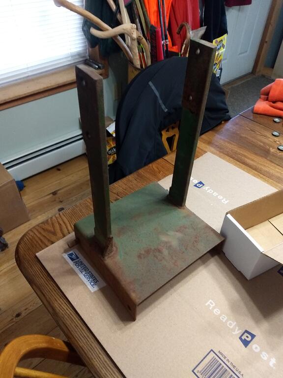

ebinmaine 80,932 #67 Posted April 26, 2021 Got me a bracket in the mail today!!! 2 Share this post Link to post Share on other sites
seuadr 490 #68 Posted April 28, 2021 well, got a hold of a mackissic parts dealer today and they confirmed that a) once those things are seized in place, they are a real challenge to remove b)the replacements are indeed sold as an entire unit (as is the other side) and they have all the parts i need still. I figure, this is the first time and hopefully the last time i'm in this equipment - so i'm going to replace both sides of the bearings, shims, rings, groove clips for the hammers and the knife and it's bolts. combine that cleaning up and sealing everything, i'm pretty confident that unless i abuse the snot out of it it'll be the last time i need to replace all of that. good people to deal with - quick response and knew exactly what i needed: 1 Share this post Link to post Share on other sites

JCM 11,419 #73 Posted May 2, 2021 That bracket looks very familiar @ebinmaine . 1 Share this post Link to post Share on other sites
ebinmaine 80,932 #74 Posted May 2, 2021 16 minutes ago, JCM said: That bracket looks very familiar @ebinmaine . In fact it does. You have/had a Mckissick chipper? Share this post Link to post Share on other sites
JCM 11,419 #75 Posted May 2, 2021 No, picked that up at the dealer years ago and turned it into a front hitch set up with a front electric winch years back. 1 Share this post Link to post Share on other sites
