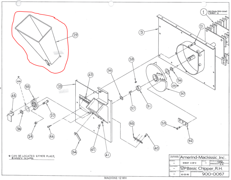

seuadr 490 #39 Posted April 23, 2021 i wonder if i can still get parts - i found that i am missing the chipper hopper - they don't list it on their site, but, who knows. 1 Share this post Link to post Share on other sites
ebinmaine 80,932 #40 Posted April 23, 2021 6 minutes ago, seuadr said: i wonder if i can still get parts - i found that i am missing the chipper hopper - they don't list it on their site, but, who knows. Can you post a diagram of what it is you're looking for? You may find it's an optional part you're not accustomed to using. You may find that they are available online or from somebody like A To Z or a connection of his. If I have one here I could take measurements and you could have one made up or make it yourself. 1 Share this post Link to post Share on other sites
seuadr 490 #41 Posted April 23, 2021 2 minutes ago, ebinmaine said: Can you post a diagram of what it is you're looking for? You may find it's an optional part you're not accustomed to using. You may find that they are available online or from somebody like A To Z or a connection of his. If I have one here I could take measurements and you could have one made up or make it yourself. i'm sure i could use it without, but dimensions would be great so i could put something together. believe it or not, they STILL MAKE the 12P (but on it's own cart, not to mount to tractors) so i'm guessing that they are out there. 1 Share this post Link to post Share on other sites
ebinmaine 80,932 #42 Posted April 23, 2021 3 minutes ago, seuadr said: sure i could use it without, but dimensions would be great so i could put something together I'll take a look and see if I have that. It is kind of handy to have a funnel-like chute to direct/squeeze the branches when you're feeding them in but that piece can also get in the way very easily. I'll double check later today and if I have it, get you some measurements. 2 Share this post Link to post Share on other sites
seuadr 490 #43 Posted April 23, 2021 you know, the one in nice condition doesn't have the chipper for branches like the rough one does - but - looking at the schematic closer - i think i could pull the branch chipper "side" off and attach it to the one in better shape? i was thinking about what it would take to get the rough one cleaned up and painted, but that would reduce it to just a few pieces instead of the entire thing. i'm already assuming i'm taking this thing apart anyhow to look at it and check the clearance of the knife, wear plate, etc. i might've just discovered my weekend project 1 1 Share this post Link to post Share on other sites
gwest_ca-(File Mod) 12,510 #44 Posted April 23, 2021 I prefer to use mine without the chipper hopper on it. I am going to make a chute less than 2" long that has rounded edges at the inlet. Side branches on a limb tend to get caught on the square edges as they are going in. Garry 2 Share this post Link to post Share on other sites
ebinmaine 80,932 #45 Posted April 23, 2021 47 minutes ago, gwest_ca said: I prefer to use mine without the chipper hopper on it. I am going to make a chute less than 2" long that has rounded edges at the inlet. Side branches on a limb tend to get caught on the square edges as they are going in. Garry I've got a smaller chipper like you push around the yard kind. I can certainly understand wanting to run that without the extra hindrance. The miniature Branch guide sounds very interesting. Whenever you get around to doing that I'd love to see pictures. 1 Share this post Link to post Share on other sites
ebinmaine 80,932 #46 Posted April 23, 2021 2 hours ago, seuadr said: weekend project And of course you know we're going to need pictures too..... 1 Share this post Link to post Share on other sites

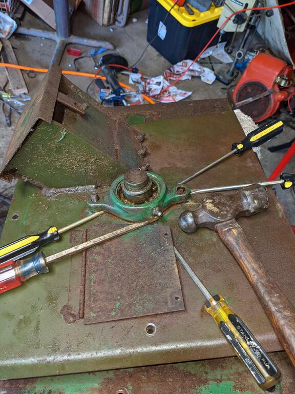

seuadr 490 #47 Posted April 23, 2021 (edited) i did find that the bearing inside part # 35 had this insert on the shaft, and it it wouldn't move. but i definitely did NOT drive a series of screw drivers and tiny cold chisels under the bearing housing to lift it up far enough to use a punch to drive the ball bearings out in order to get the whole thing loose enough that i could get a puller on that collar. i did something smarter, i'm sure. Edited April 23, 2021 by seuadr 2 Share this post Link to post Share on other sites
ebinmaine 80,932 #48 Posted April 23, 2021 11 minutes ago, seuadr said: NOT drive a series of screw drivers and tiny cold chisels under the bearing Hmm. Really? Share this post Link to post Share on other sites
seuadr 490 #49 Posted April 23, 2021 (edited) That thing would NOT move for nothing. It is free now.. although some bearings were hurt during the production. Parts list calls it out as a 1 3/16 ball bearing so i should be able to get a replacement. And will give that collar snd the shaft a really good cleaning. The collar is only supposed to be held on with a couple of set screws, so I'm not sure if i should use something like anti-sieze on it.. Well and a ring clip Edited April 23, 2021 by seuadr 1 Share this post Link to post Share on other sites
ebinmaine 80,932 #50 Posted April 24, 2021 12 minutes ago, seuadr said: That thing would NOT move for nothing. It is free now.. although some bearings were hurt during the production. Parts list calls it out as a 1 3/16 ball bearing so i should be able to get a replacement. And will give that collar snd the shaft a really good cleaning. The collar is only supposed to be held on with a couple of set screws, so I'm not sure if i should use something like anti-sieze on it.. Well and a ring clip I'm not sure. Need to get the mechanical wizards in on this one. 1 Share this post Link to post Share on other sites
