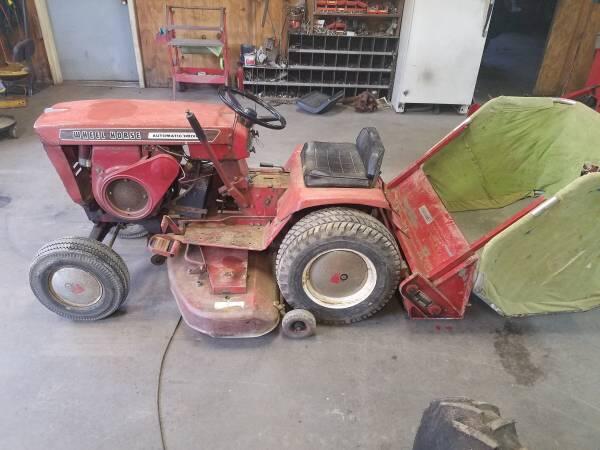

Ok, So I bought this tonight... Now what??
WHX??

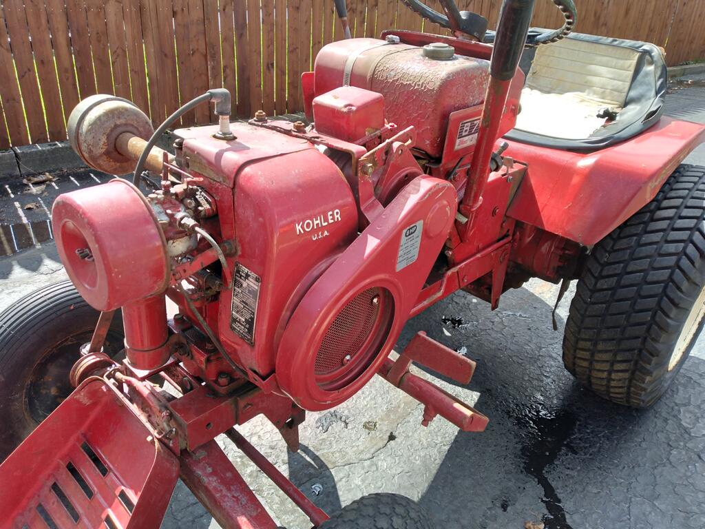

12 hours ago, D_Mac said:
What do you all suggest???
Save it gets my vote. You already got guys interested.
I guess I don't get why you guys are talkin repo... that motor is totally rebuildable, unless maybe the block is ventilated but even then.
At one time it had one of these on the back as evidenced by the knobs on the back of the fender pan.
WHX??
11 hours ago, D_Mac said:
I have the piece for the steering wheel. Has any one had any success in repairing one
Steering wheel is junk but lots of them out there.
He doesn't have the time, space, ability and he wants it fixed quick. Get another motor and sell the old one to who wants to fix it,

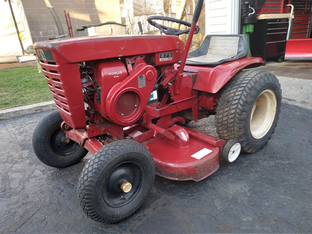

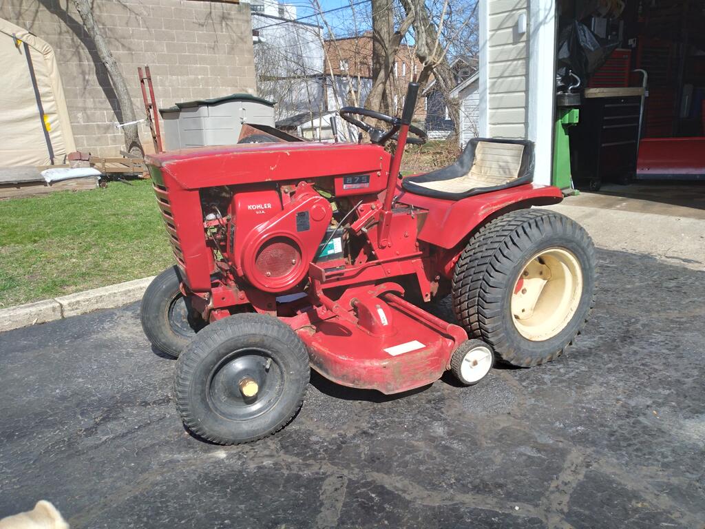

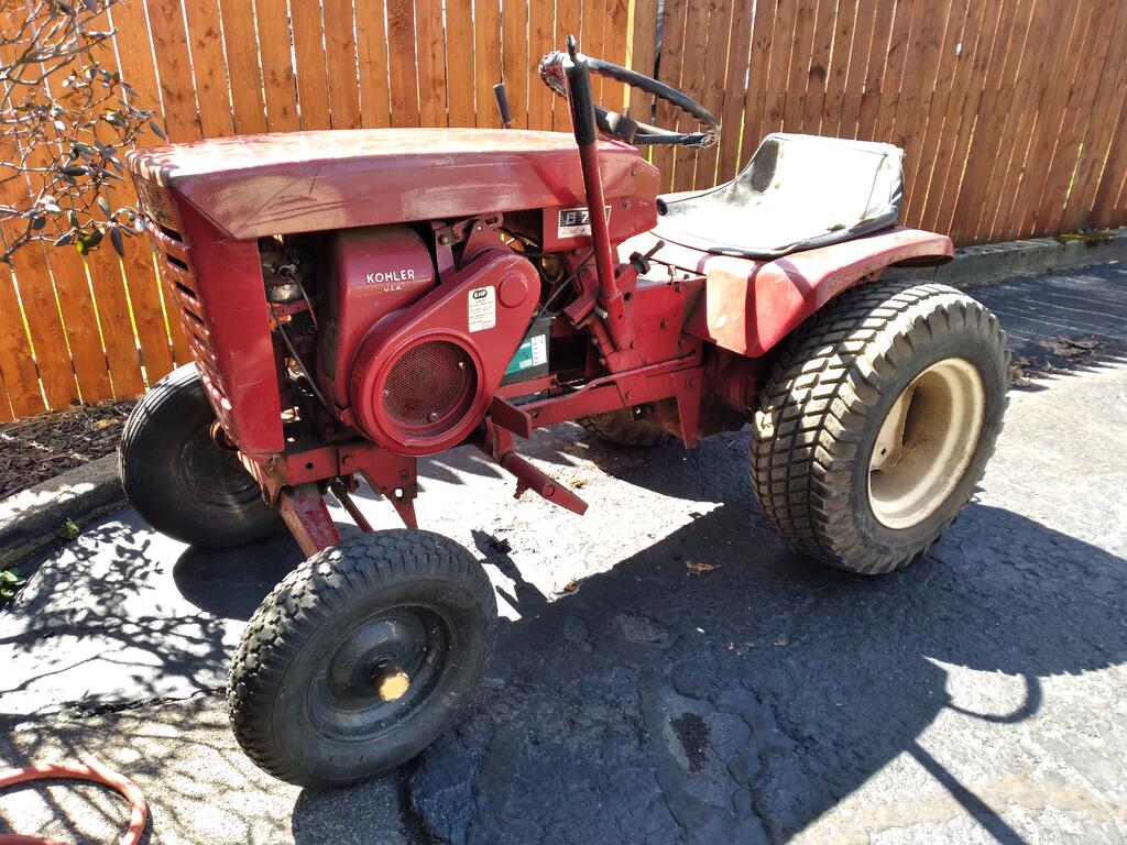

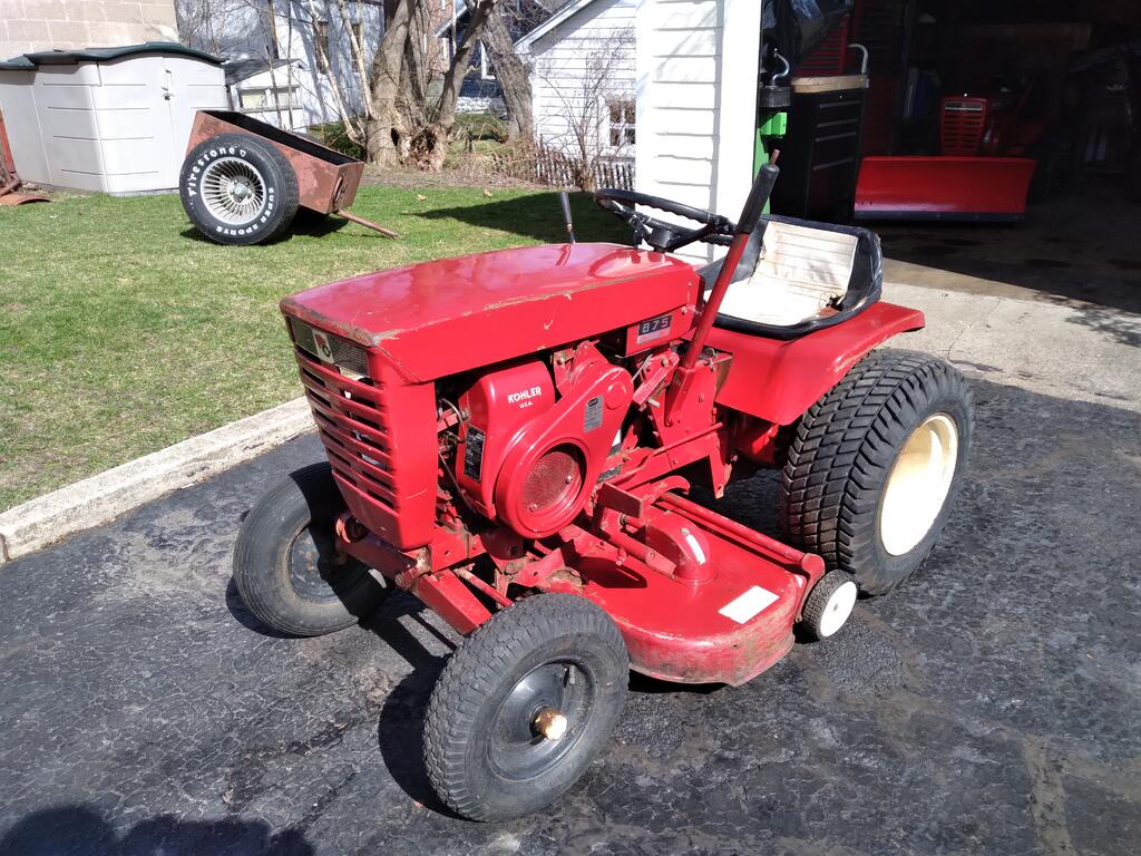

Ok... So I had these tires and wheels I saved off of that little cart I just got. With them on I was able to get it off the back of my truck. Cleaned out a few nest from mice and hosed it down. Seems it was repainted some time ago. I believe I could shine it up nice if I keep it. Seat is shot. Steering wheel is shot. I'm going to replace the front tires. Engine turns. I have not tried to start it. When I push it around I hear the tranny winding. Have not checked the fluid. Guess I will look for a steering wheel. Looks like it might be a little tricky to get the old one off. At least with tires and a steering wheel I can move it around.
Edited by D_Mac
Gregor
Your steering wheel is shot anyway. Bore a hole through the center of the plastic, and use a puller. Remove the plastic if you have to. This is after you drive out the pin if course.

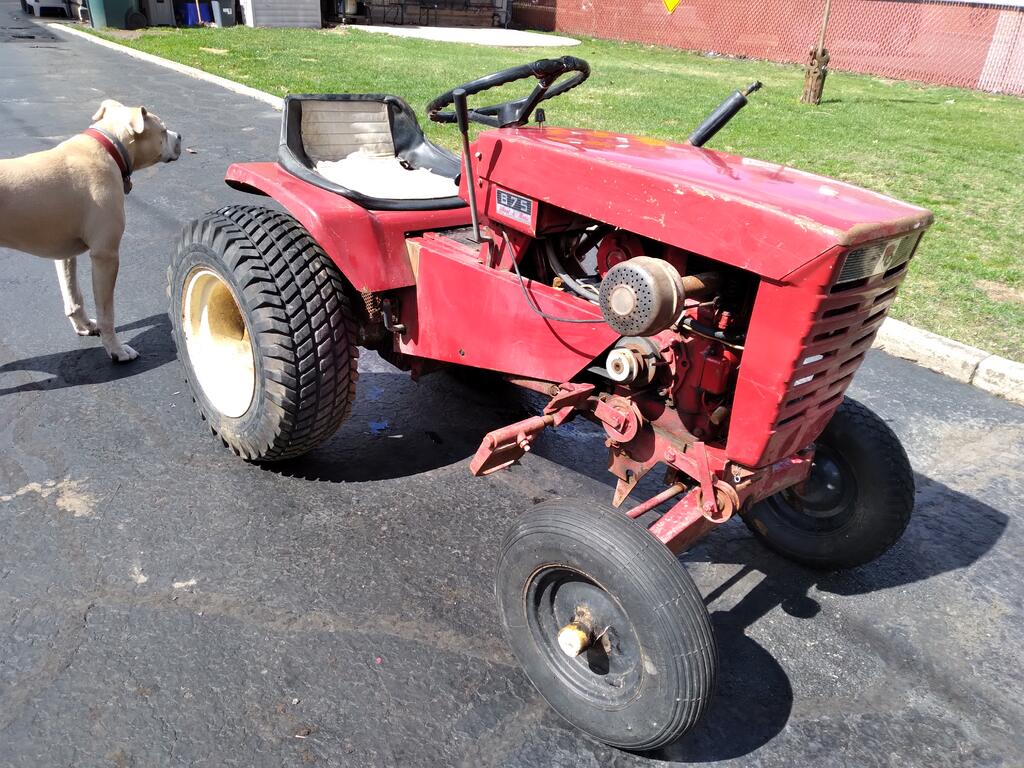

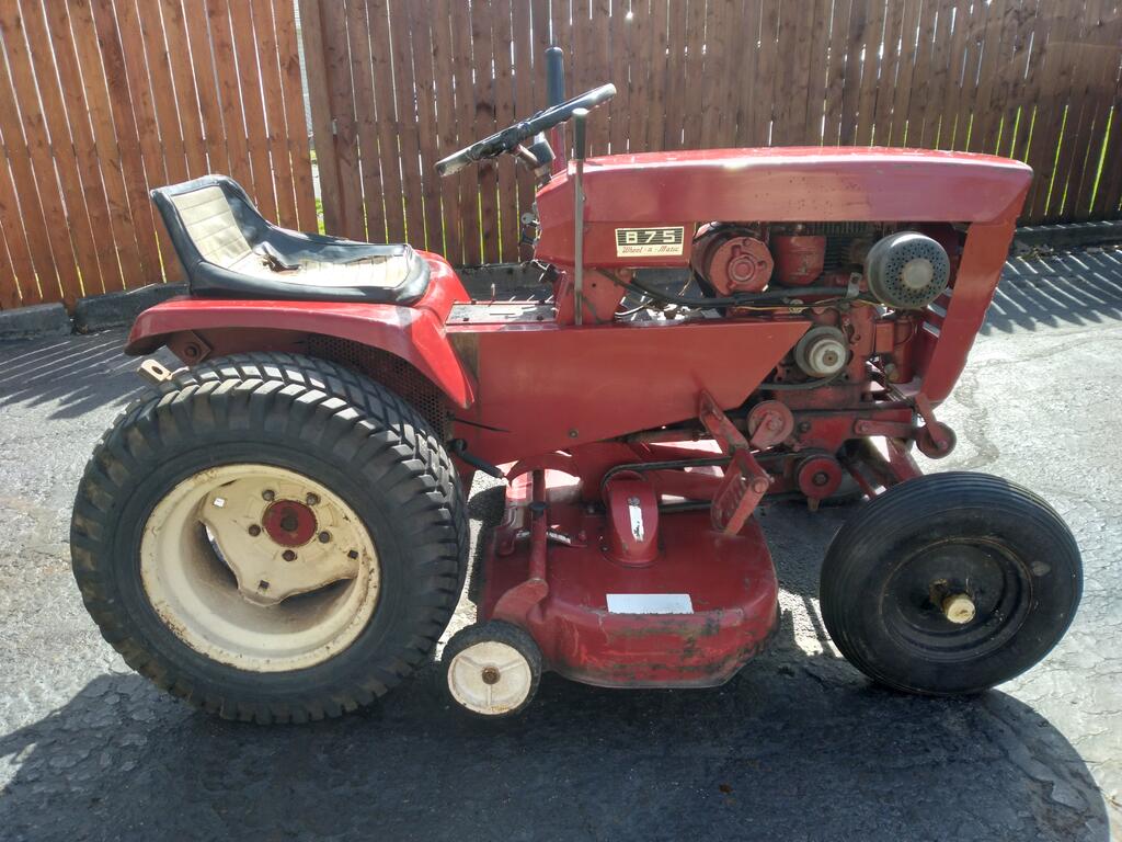

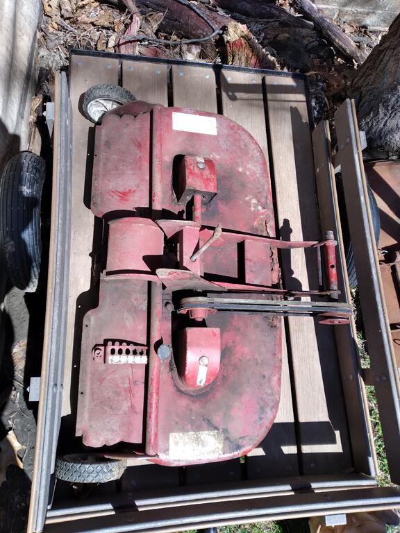

So today I degreased and cleaned the deck some. I wanted to see what it looks like with the deck on .... so I put it on. I am missing the belt that does from the deck to the engine pulley. If someone knows the correct size and can pass it on I thank you. There is also a small pull on the right hand side in front of the front axle ... Can someone tell me what that is for? I checked the dip stick for the tranny. Seems to be good, red no water. I lubricated the choke and throttle cables. Looked in the gas tank, its dry and I did not see any holes. See what happens when I am ready to pour a little gas in it. It has a key that has 2 positions, the second on a spring to bring it back to the first. It also has a push button. They have no lights so I am not sure if that is stock or someones doing. Also there was a nice nest behind the dash and I am not sure if there are some damaged wires. I am guessing turn the key once and hit the button to start? Has the generator light but no cigarette lighter. I ordered 2 tires for the front. Was told they dont make 16 x 5.5-8 anymore. I ordered 16 x 6.5 -8. Hope they dont rub. Might just swap the tires to the 857. Going to borrow a jump box and see what happens next. Fingers crossed. Also going to drop the deck off to my cousins for a patch, then I will paint it.
That small pulley someone added maybe for a snowblower. Take it off and put it on your knick knack shelf
@D_Mac Look at the latch arm on the left side that holds the front of the deck on. There should be a small hole in the arm and the hitch to put in a hairpin or cotter pin. This keeps the latch from springing open and dumping the deck when you hit a pothole on the way to the Deli.
I dont drive to the deli I walk there !! Do you know the belt size ?
I would add an in line fuel filter as close to the motor as possible, before adding any gas.

I only spent money on 2 tires and I ordered a steering wheel.I figure I will put the new tires on my 857 and use those rims and tires on this 875. I have to be able move it around.
WHX??
You do realize Mac that that tractor was the first year of the wheel a matic hence a collectors piece and you get quadtriplenty from  Randy what you paid for it????? :ychain:
D_Mac
Lol I know it was the first year of the Wheel -a - Matic but arnt they all collectors pieces? I am taking it to a friend's tomorrow. He has a 1075. I have had a couple people say they would give me what I paid for it. No one has offered more though !!!
