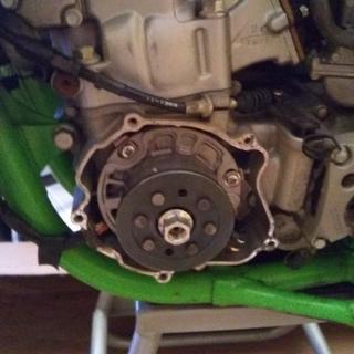

tom2p 2,394 #40 Posted April 1, 2021 On 3/28/2021 at 5:07 PM, Handy Don said: I'd be interested in knowing the respective rotating mass of those two engines, i.e. their moments of inertia at idle speed or just above. The "no stall" and slower throttle response are both symptoms of a heavier rotating mass. The stall and quick throttle response are both symptoms of lighter rotating mass. Steel costs money when building and shipping engines. I suspect predators have been scrupulously engineered to use as little as possible by taking advantage of better alloys and advanced stress analysis! rotating mass an important subject for off road motorcycle riders - many would install an additional flywheel weight on their 2-stroke bikes to improve ride ability on trails / tight woods riding ... I believe some install them today on their 2 and 4 stroke bikes I was on the other end of the scale - loved the quick revving bikes with low rotating mass ... quick stab at the clutch lever and the engine would shriek to life ... good times ! 1 Share this post Link to post Share on other sites

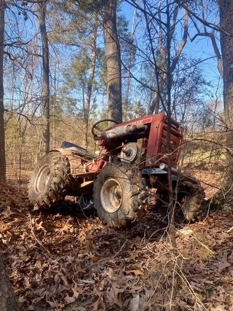

Greentored 3,220 #41 Posted April 1, 2021 (edited) 3 hours ago, ebinmaine said: I don't know if there's a rating officially. LOTS of rigs do 12 to 15 mph with success. @Greentored Scott has done 30 or so. Not sure on longevity at that point. Why are you asking? Some of you fellas disagree with what a few folks, myself included, are doing/have done with some of our beloved Horses, but if you read this to the end, you may not feel the need to send a lynch mob just yet The WH unidrives are TOUGH, even the early 3/4 speeds, that is exactly what makes them so appealing to the folks who want to hotrod them or otherwise do things they were not intended for. Add that to one super beefy chassis, front axle, spindles and and steering, and they're hard to say no to.. The 654 I had ran a hopped up 11hp OHV and ran 28mph. Trans input speed was something like 12,000rpm versus 2400-2500 stock. The trans was worn and noisy when I got it (it matched the rest of the machine) and was no worse when I sold it. I ran it for a entire summer and the only failure was one broken axle hub, which was destroyed and had a keyway that wrapped 1/4 turn around the hub when I got it. After feeling guilty about using a round hood for the shenanigans I sold it, and last I heard it was back to stock and pulling a firewood wagon through the woods. That makes me happy Wanting to still have some fun but with a somewhat less desirable model, I built the B-1 bomber, and am using it more as a utility/offroad crawler than a beater. Aside from beefing up the spindles a bit, a set of gnarly ATV tires, and a link to tie the brake to the deck lift arm for stopping, nothing has been done that cant be undone back to original in an afternoon. The stock K321 retains the governor at 3400-3500, the big 8 pinion 8 speed has flipped pinions to lock the axles (no welding!), and the stock pulleys are on the shelf. Top speed is 17-18mph. Trans input speed is in the 7200-7500rpm range and it stays happy, cool, and quiet there. Field reports from other guys running Horses, they have seen an occasional broken axle of the 1" variety, and they have to keep an eye on the hubs, checking after every ride or two. Most are running 15-20mph top speeds, with a few nuts running well over that, and they are being powered by everything from stock K181s to hopped up V twins and diesels. Some of these guys are beating the living TAR out of them on a regular basis, and they hold up to whatever is thrown at them. Yes, it tugs at the heart strings a bit seeing some of the beatings these guys are giving their Horses, but to each his own I guess. Really don't know what the limits are on these transmissions, but the offroad guys are pushing them far beyond their limits, and rarely seem to hurt them one bit. WHEEL HORSE TOUGH! Edited April 1, 2021 by Greentored 1 3 Share this post Link to post Share on other sites

tom2p 2,394 #43 Posted April 3, 2021 On 4/1/2021 at 8:28 AM, Greentored said: On 4/1/2021 at 8:28 AM, Greentored said: The 654 I had ran a hopped up 11hp OHV and ran 28mph. Trans input speed was something like 12,000rpm versus 2400-2500stock. The trans was worn and noisy when I got it (it matched the rest of the machine) and was no worse when I sold it. I ran it for a entire summer and the only failure was one broken axle hub, which was destroyed and had a keyway that wrapped 1/4 turn around the hub when I got it. After feeling guilty about using a round hood for theshenanigans I sold it, and last I heard it was back to stock and pulling a firewood wagon through the woods. That makes me happy you sold the trail machine ? that thing was awesome ! Share this post Link to post Share on other sites
Greentored 3,220 #44 Posted April 5, 2021 On 4/3/2021 at 2:03 AM, tom2p said: you sold the trail machine ? that thing was awesome ! I did! ...and it changed hands THREE more times within 2 months. One of the guys who had it for a short time said it scared the previous owner, who told him 'this thing is scary, someones gonna get hurt on it.' The new owner said he rode it once, agreed, and sold it again 1 Share this post Link to post Share on other sites
