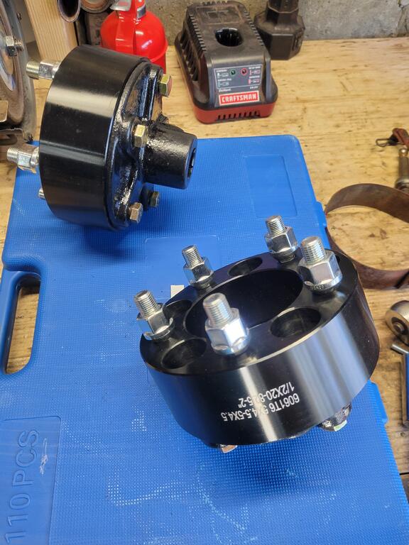

OldWorkHorse 3,153 #19 Posted March 26, 2021 Ford ranger spacers... drilling rims to .5 inch is pretty much just shaving the edges of the stock hole. 3 2 Share this post Link to post Share on other sites

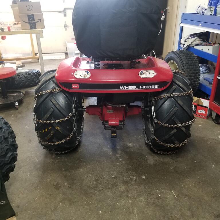

OldWorkHorse 3,153 #20 Posted March 26, 2021 Also 23x10.5-12 with 2 inch spacers. 2 Share this post Link to post Share on other sites

Gregor 4,848 #22 Posted March 26, 2021 3 minutes ago, OldWorkHorse said: Ford ranger spacers I think that's what I ordered Share this post Link to post Share on other sites
Gregor 4,848 #23 Posted March 26, 2021 Now I am thinking taller. Maybe raise the fender pan. Share this post Link to post Share on other sites
OldWorkHorse 3,153 #24 Posted March 26, 2021 3 minutes ago, Gregor said: I think that's what I ordered Think jeep spacer will work 2. Just not sure the center bore hole on them probly the same. Share this post Link to post Share on other sites
