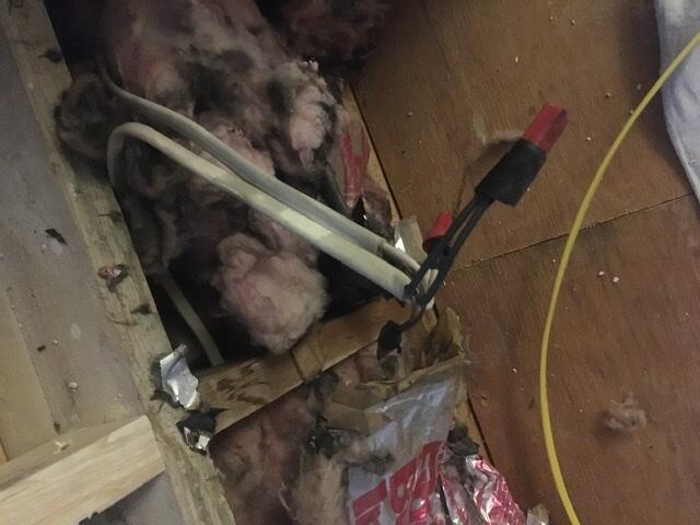

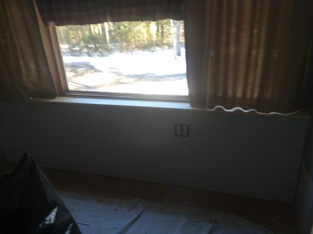

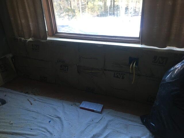

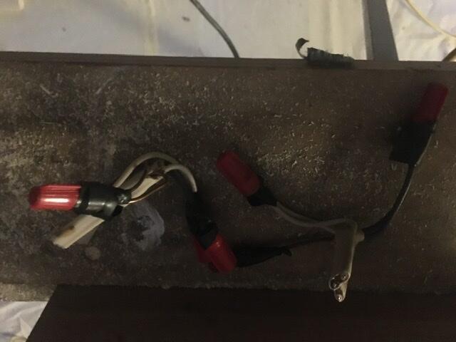

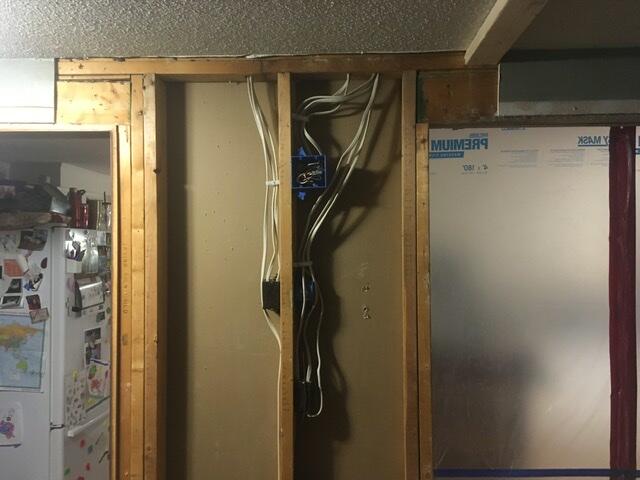

AHS 1,701 #1 Posted March 2, 2021 Oh boy, what a fiasco! I’m an electrician, so I have seen some a lot of ‘ut ohs’, but nothing like this house! Ok, so I was going to install an double gang box for outlets under the bay window and I was going to replace the wire to each side of it. One side of it (5’ to the next outlet) and it had two breaks in it both put together with wire nut, just thrown in insulation! No box or anything! I’m taking out the knee wall and adding more insulation. 7 Share this post Link to post Share on other sites
Achto 32,816 #2 Posted March 2, 2021 At least they put tape over the wire nuts. 3 8 Share this post Link to post Share on other sites
953 nut 69,701 #3 Posted March 2, 2021 You just never know what surprises are hidden behind drywall. Now the question is how many other little No-Nos exist. 6 Share this post Link to post Share on other sites

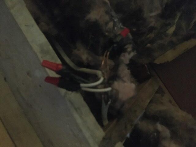

Jeff-C175 7,211 #8 Posted March 2, 2021 (edited) When we were remodeling this place there were TONS! of issues like that. Probably the worst one that I found was in the 'attic' which was inaccessible until I pulled down the drywall from the ceiling. There WAS a box, but it had no cover on it. The wires were LOOSELY twisted together and hanging out of the box with NO WIRE NUTS on them! They ARCED and SPARKED as I pulled down the drywall... THAT LOOSE! Gee... I wonder why the lights blinked when we walked across the floor? Scary stuff. Needless to say, this place has NONE of the original wiring left. 100% replacement. Should I mention the plumbing? naaaahhhh, use your imagination! Think of the worst plumbing nightmare you can. That was this place. But, the price was right. Edited March 2, 2021 by Jeff-C175 1 Share this post Link to post Share on other sites

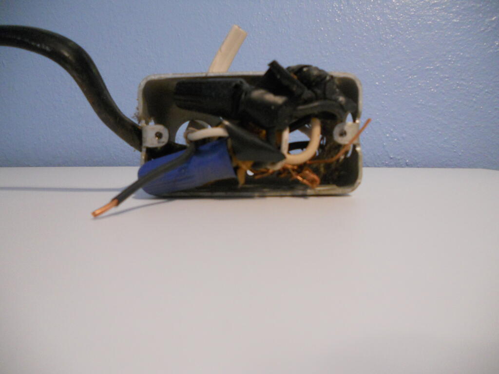

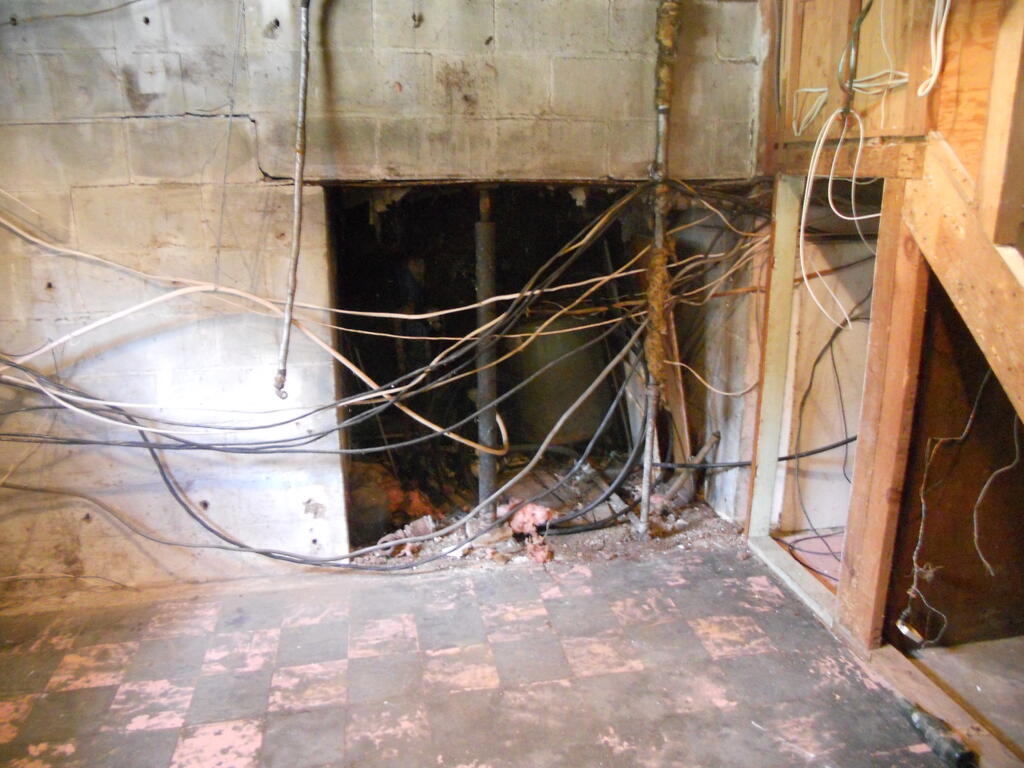

Racinbob 13,207 #9 Posted March 2, 2021 Any wonder why so many fires are caused by electrical issues? Over the past 45+ years my wife and I have been married we've bought and sold several homes and have always made out very well enabling us to 'upgrade' after each sell. When we decided to escape Florida in 2017 to come back to our home state we knew it would pose some issues. I did make a couple trips up here looking at houses but it takes more than one walk thru to get to know what a house needs. We've always leaned towards houses that we knew needed some work. As I've said to realtors many times, we look at a house for what we can turn it in to and not so much for what it is. It was no different with the first house we bought when we moved back. We knew it needed work. I NEVER request a home inspection because I have yet to see one worth the paper it's written on. I made an exception on that first house because I wasn't able to spend the time going over it. The report came back fairly good with just a few issues noted. This was one of them: The inspectors suggested repair........install a cover plate. As I started updating the house I came across issue after issue. Electrical, plumbing, structural, you name it. It wasn't long before I decided the best thing to do was start from scratch. Sledge hammer, sawzall,, dumpsters, etc. Two years later we were well rewarded for our efforts and bought the place we have now (the last one we're doing). This swayed from the subject but the point I'm trying to make is to never put much weight in a home inspection report. And never, never, never rely on the report for the critical systems. I don't want to step on the toes of anybody here that does home inspections but I have yet to see a proper report on the critical systems. Personally knowing many of the qualified contractors up here hindsight told me I should have contacted them for a proper inspection. Fortunately @AHS you are qualified to find and repair the electrical issues before a disaster strikes. 4 3 Share this post Link to post Share on other sites

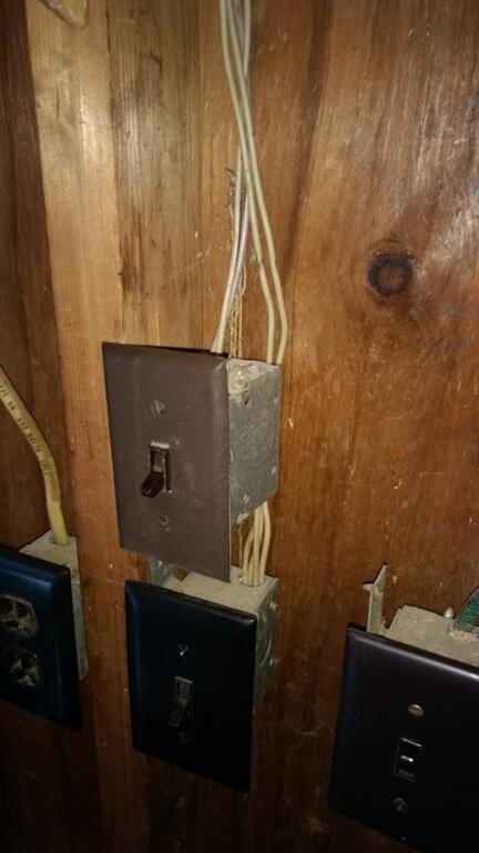

Jeff-C175 7,211 #10 Posted March 2, 2021 (edited) Here is an example why one should never install a metal box directly on a below grade foundation wall: Edited March 2, 2021 by Jeff-C175 3 1 2 Share this post Link to post Share on other sites

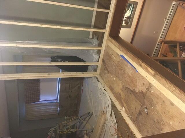

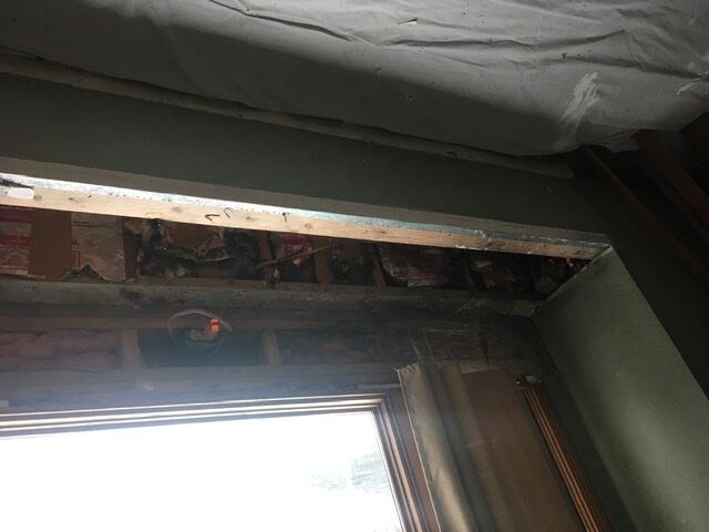

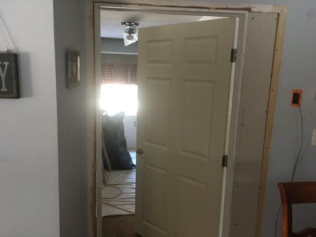

AHS 1,701 #15 Posted March 3, 2021 Here’s an update, after day 2. There was a 2x10 underneath the bay window so we had to frame out a little bit bit more. We filled it all with insulation! (It’s a gambrel house) got the closet sorta framed. Tightened up some wiring, I had to add a 2 gang box so it could be exposed! 4 Share this post Link to post Share on other sites

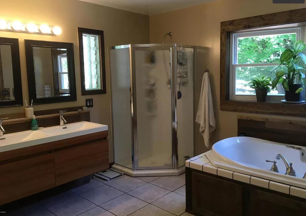

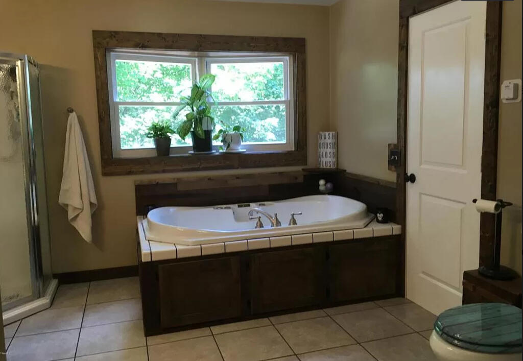

Pullstart 71,350 #16 Posted March 3, 2021 (edited) I commend you for turning a living room into anything else! At our old house, I built a master bath out of a living room. It was pretty much a total gut and redo. I even cut an 8’ hole in the exterior wall to reframe for a big bay window above the garden tub! Edited March 3, 2021 by pullstart Duplicate 5 Share this post Link to post Share on other sites

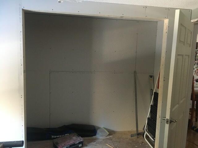

AHS 1,701 #19 Posted March 4, 2021 Nice job @pullstart Unfortunately we have a two bedroom house (now three beds) and we have 2 kids, and our kids are sharing a room. Definitely unfortunately, all my money is going to this instead of buying more wheelhorses!! Here is some more progress... 1 1 Share this post Link to post Share on other sites
