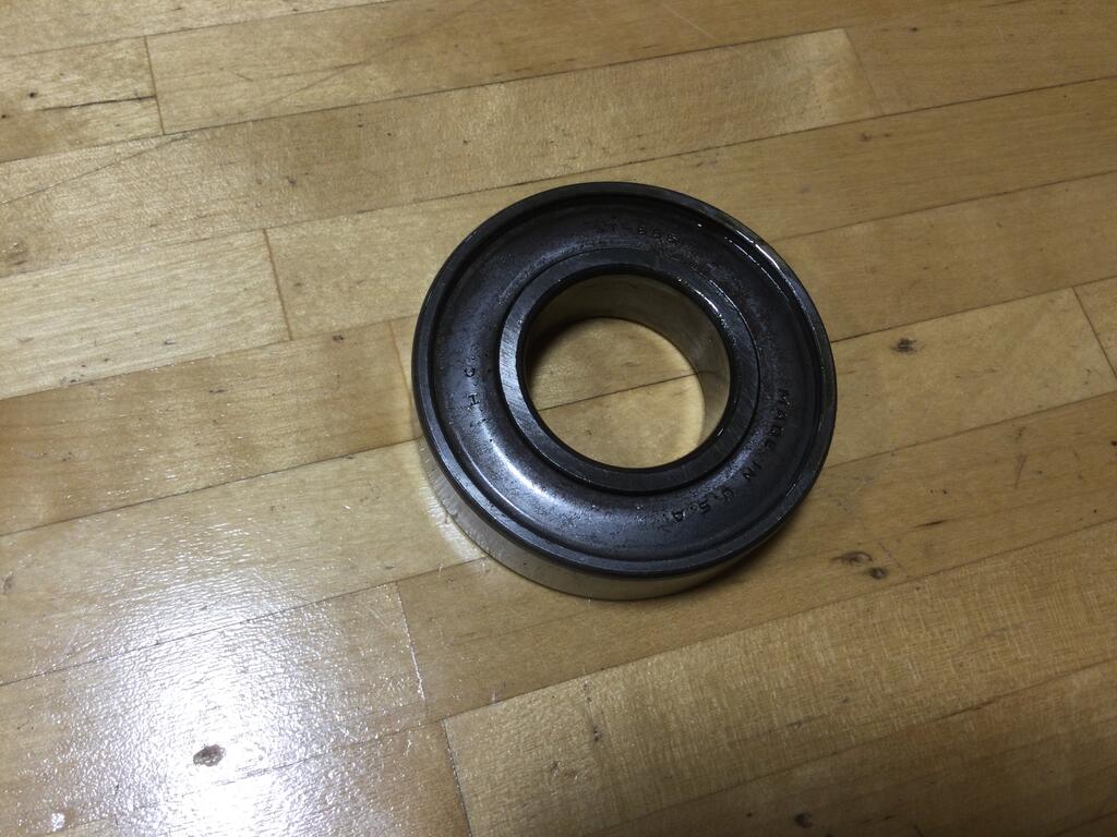

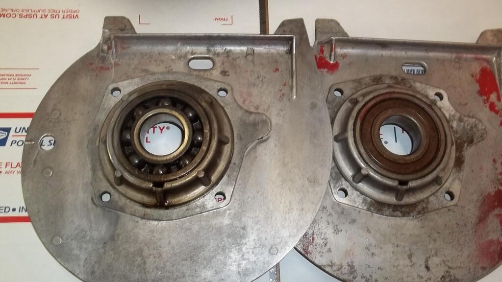

953 nut 65,215 #1 Posted February 27, 2021 I am assembling a couple of K-241 engines and have a question about the crank shaft bearings. One side of each bearing is open and the other side of each bearing is shielded. On one of the engines the shielded side of each was turned out away from the crank case (open side in) and on the other both shielded sides were turned into the crankcase (open side out). The bearings on both engines were good and had some oil on them when the engine was taken apart. All are in good condition. My question is what way would you feel is correct? Share this post Link to post Share on other sites

953 nut 65,215 #7 Posted February 27, 2021 2 minutes ago, WHX24 said: Exactly Ed... any sign of someone being in the motor before Richard? No signs of either engine having been worked on previously. 8 minutes ago, Ed Kennell said: I guess I don't understand why there should be a shield on either side. Logic tells me more oil is better on a bearing and you certainly don't want the seal to run dry. I'm inclined to turn the open side inward on both but wanted input from others on this. The shield apparently allows some oil to pass and there is a drain slot under the bearing. Share this post Link to post Share on other sites

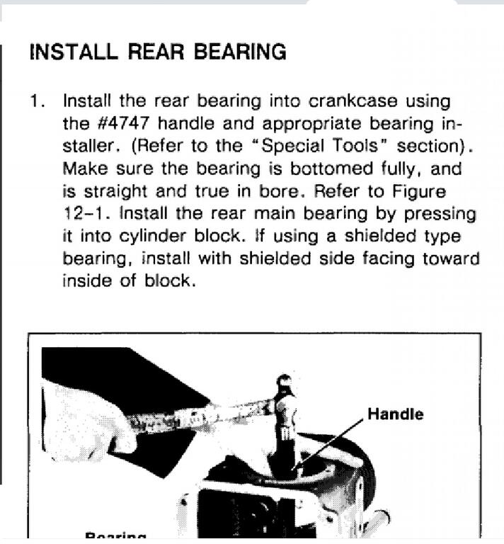

oldredrider 2,553 #11 Posted February 27, 2021 Shield to the inside of block. Kohler says so. 2 1 Share this post Link to post Share on other sites
richmondred01 2,360 #12 Posted February 27, 2021 I replace them with open sided bearings however, the ones I’ve seen the shield faces out on the open faces in. The vast majority of these were on the Deere models. Don’t ask me why. 2 Share this post Link to post Share on other sites

953 nut 65,215 #16 Posted February 27, 2021 10 hours ago, oldredrider said: Shield to the inside of block. Kohler says so. I have an older service manual in my shop and shielded vs. open wasn't mentioned but the manual we have in our manuals section says exactly what you are telling us. 2 1 Share this post Link to post Share on other sites
richmondred01 2,360 #17 Posted February 27, 2021 (edited) I know what the book says but everyone I’ve removed in 40 years the shielded side was out. that’s why I get new ones. Edited February 27, 2021 by richmondred01 2 Share this post Link to post Share on other sites
