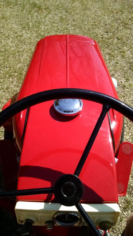

Achto 32,891 #101 Posted April 26, 2021 Other than a couple of decals, I was able to wrap this project up. I would like to thank @pullstart for the choice spindles. A thank you to @Racinbob for the ammeter that is on it's way. Thank you to @WHX24 for talking me into trading steering wheels with him. There's no way that I can say that it's done & not show some pictures. That would be unacceptable. Thank you for following along. Now I'm anxiously waiting for tractor shows to start so that I can show this 701 in her new cloths. . 8 6 Share this post Link to post Share on other sites

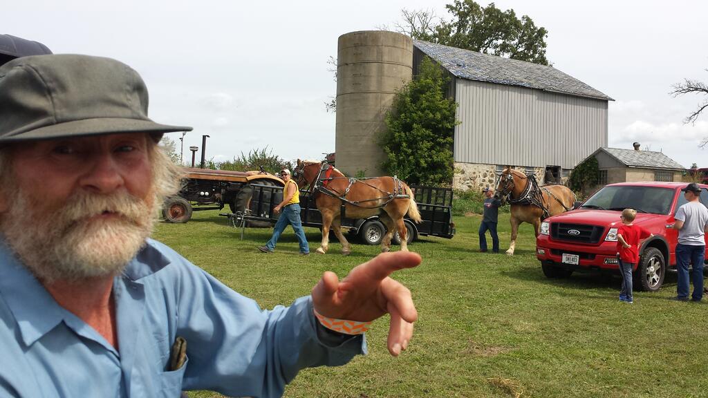

WHX?? 58,324 #106 Posted April 26, 2021 (edited) 10 hours ago, Racinbob said: another one worth repeating. Ok Bob ... Cindy and I were riding around at a show and drove past a guy with a couple of horses. Ok nothin new but a couple of hours later Dan comes back into camp asking if I got any cash. Sure I says I got a bit lets go have a peek see watcha found?... always up for a ride. So we go over to this guy Cindy and i drove past and there's a horse sittin ther. No for sale sign on it mind you. Right away cause of the double belt guard it hits me this is a 701. Older poorer resto but definitely has the right plumbing meaning it's all ther. So I says to the guy for sale ?? does it run? He says yah ... how much? 200 he says and I says sold!!!! Never even bothered to quibble on the price as we knew what we was looking at being fairly complete and somewhat rare in these parts. We knew the belt guard was worth that! A few things cobbled and incorrect but still. Rest is history. We barely managed to get it back to camp but dollar billed the points a few times and we both got seat time. But it didn't smoke and sounded fine so all it needed was Dan's touch. I hopped on it for a few shows after that and it always left me stranded ...yep 1$ bill! Too bad we were already celebrating and we didn't get any pics...the only one I have... nice mug Ritchie! That was a good show I'll never forget that one. The year of the runaway draft horses Dan.... Edited April 26, 2021 by WHX24 2 5 1 Share this post Link to post Share on other sites

Achto 32,891 #108 Posted April 26, 2021 (edited) 7 hours ago, WHX24 said: 7 hours ago, WHX24 said: The year of the runaway draft horses Dan That was a fairly scary few seconds!! Jim, Jason & I were laying a few furrows down while the horse pull was going on. We had stopped at the end of the field to jaw jack for a bit when all of a sudden Cindy comes running over the hill screaming "LOOK OUT". Apparently when they dropped the hitch for the team of horses pictured above, it missed the hook. The team heard the clink sound of the hitch hitting the stone boat and bolted, (which is what they are trained to do). Problem being, there was no stone boat to hold them back. Of course the reins got ripped out of the drivers hands and these horses were on the loose. They come over the hill behind us at a full out run, and flew between us while we were sitting on our tractors talking. Literally missing Jason by a few inches. From there they headed to the spectators parking lot where they got tangled in their harness and bashed into the side of a car. This was where they were finally caught & brought under control. Luckily no people were hurt and the horses did not suffer any injuries either. Quite an exciting few moments!! I think Jason had to go take care of a "brown out" in his shorts after this fiasco. Edited April 26, 2021 by Achto 5 Share this post Link to post Share on other sites

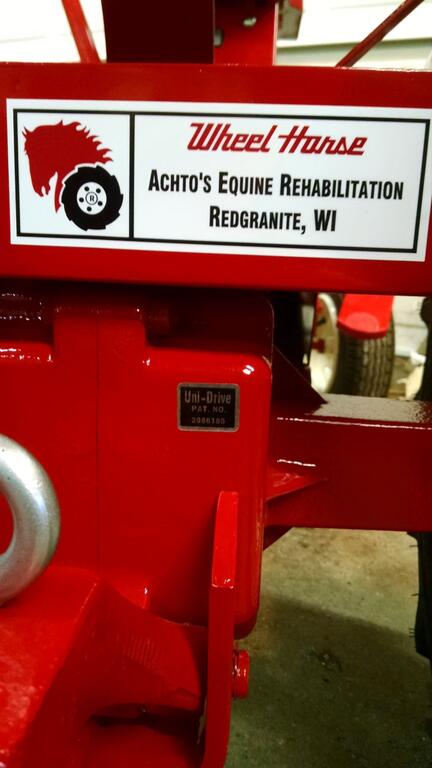

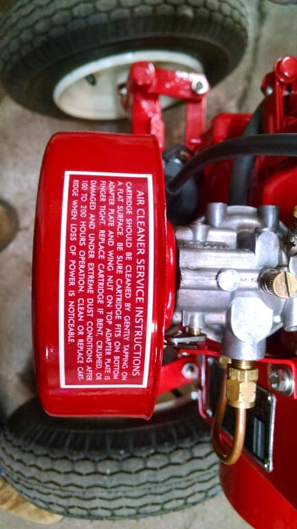

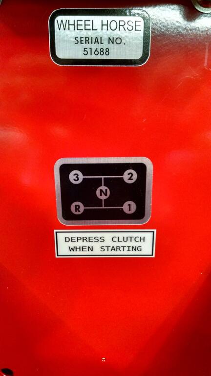

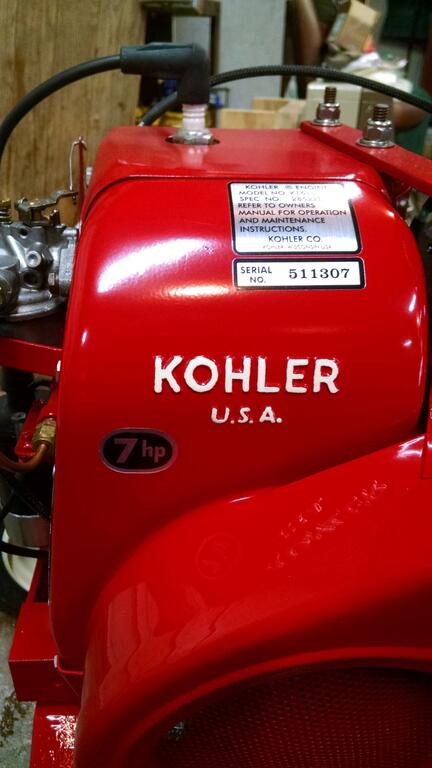

Achto 32,891 #113 Posted May 8, 2021 The rest of my decals showed up this week so I was able to put the last finishing touches on. Patten decal for the transmission. Counsel decals. Engine decals 10 2 Share this post Link to post Share on other sites

squonk 48,287 #124 Posted May 9, 2021 Is that a high heat white on the head Dan. Any Clear? 2 Share this post Link to post Share on other sites
Achto 32,891 #125 Posted May 9, 2021 (edited) 13 minutes ago, squonk said: Is that a high heat white on the head Dan. Any Clear? No paint at all on the head. Just sand blasted it, checked the gasket surface, blew it off good, and put it back on. It does look kinda white in the picture though. No clear on the tractor either. Single stage VanSickle acrylic enamel with a gloss hardener. Edited May 9, 2021 by Achto 4 Share this post Link to post Share on other sites
