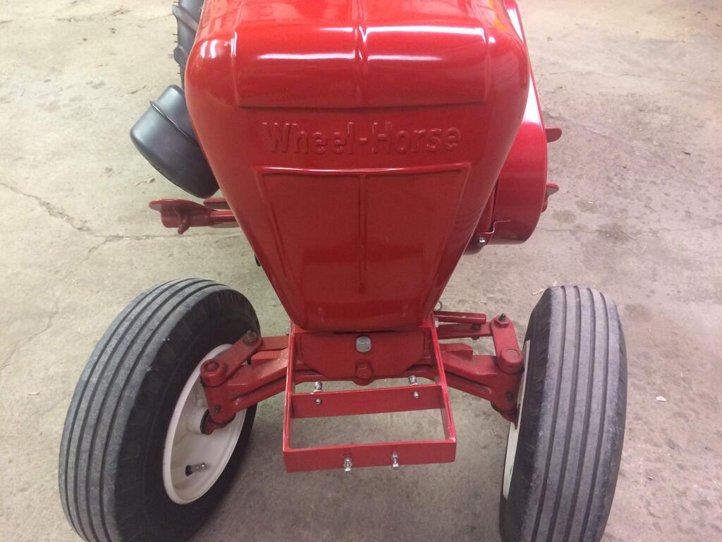

Achto 32,510 #51 Posted April 14, 2021 14 minutes ago, WHX24 said: Dan thinks the front rims should be mounted with the valve stem to the inside which makes sense for stem protection and wheel weights. If that's true all my early sixties tractor are on backwards. Issue with running them to the inside the rim gets pretty close to the spindle arm. .... some pics as I was playing... anyone know which is correct? I did a lil research & now believe that on early front rims did have the valve stem to the outside. I also came to the conclusion that these rims can not be used without an inner tube. If you look at the weld that holds the 2 halves of the rim together it does not go all the way around. 2 Share this post Link to post Share on other sites

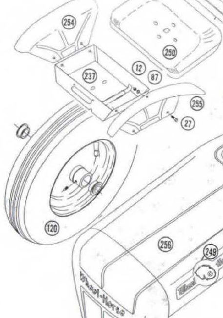

WHX?? 57,922 #58 Posted April 15, 2021 For what it's worth a snip of the IPL showing the stem to the inside? 2 Share this post Link to post Share on other sites

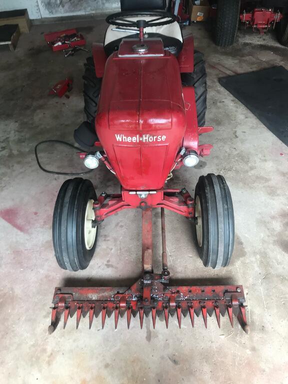

Lane Ranger 12,094 #63 Posted April 16, 2021 Mine are on the outside but I never claimed to be much of an original purist! Not sure wheels are original . This horse was traded back forth four times with two Wheel Horse owners before I rescued it from them! 3 1 1 Share this post Link to post Share on other sites
WHX?? 57,922 #64 Posted April 16, 2021 10 hours ago, Lane Ranger said: I never claimed to be much of an original purist! Me neither Lane as the MN boys ain't got me completely brainwashed.... yet! ' Specially when it comes to making improvements over factory like that hood hinge on yours. Sides when they get dirty running around at a muddy tractor show or worked in the garden... The way to tell if they are original or near original is look at the edge of the rim. It will have a pronounced curve to the inside. Looks like Dan's are and in my pic you can see left side is, passenger side no. Looks like Mikes are too. A painters pain to get paint under that curve without the runs. 2 1 Share this post Link to post Share on other sites

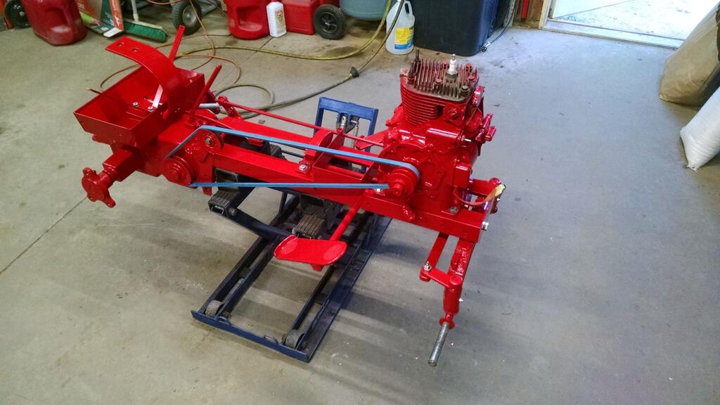

Achto 32,510 #66 Posted April 16, 2021 No work today so it's go time for assembly. I'll post more pic's of my progress at the end of the day. 6 2 Share this post Link to post Share on other sites
WHX?? 57,922 #67 Posted April 16, 2021 (edited) 13 minutes ago, Achto said: No work today !?!?!??!?!?!? whats up with that!?!?!?!? 13 minutes ago, Achto said: time for assembly. This always the part I like if one has all his hardware. No greasy parts to clean or repair .. seems to go fast and progress is seen right away. Hey wait a minute that floor looks way too clean ...you is at pumpkin farmers ain't ya! Edited April 16, 2021 by WHX24 1 1 1 Share this post Link to post Share on other sites
Achto 32,510 #68 Posted April 16, 2021 Yep, most of my stuff is at Pumpkin Farmers from helping him with his basket Case. Might as well assemble it there. 1 1 Share this post Link to post Share on other sites

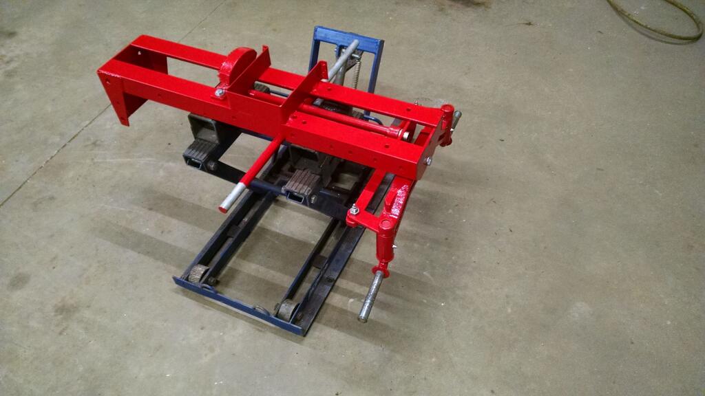

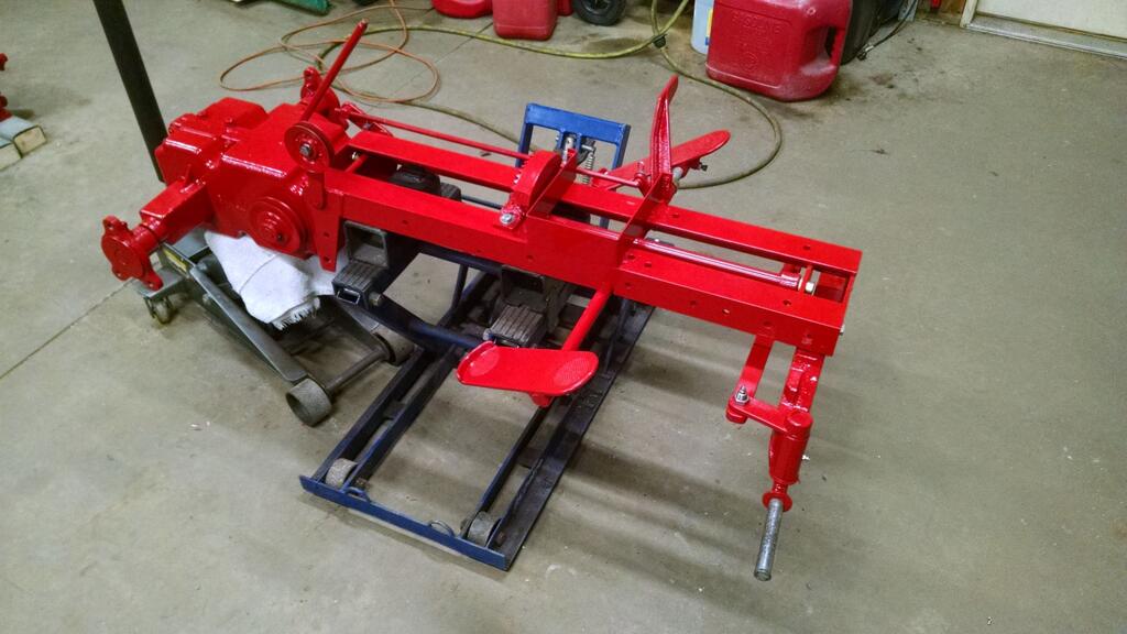

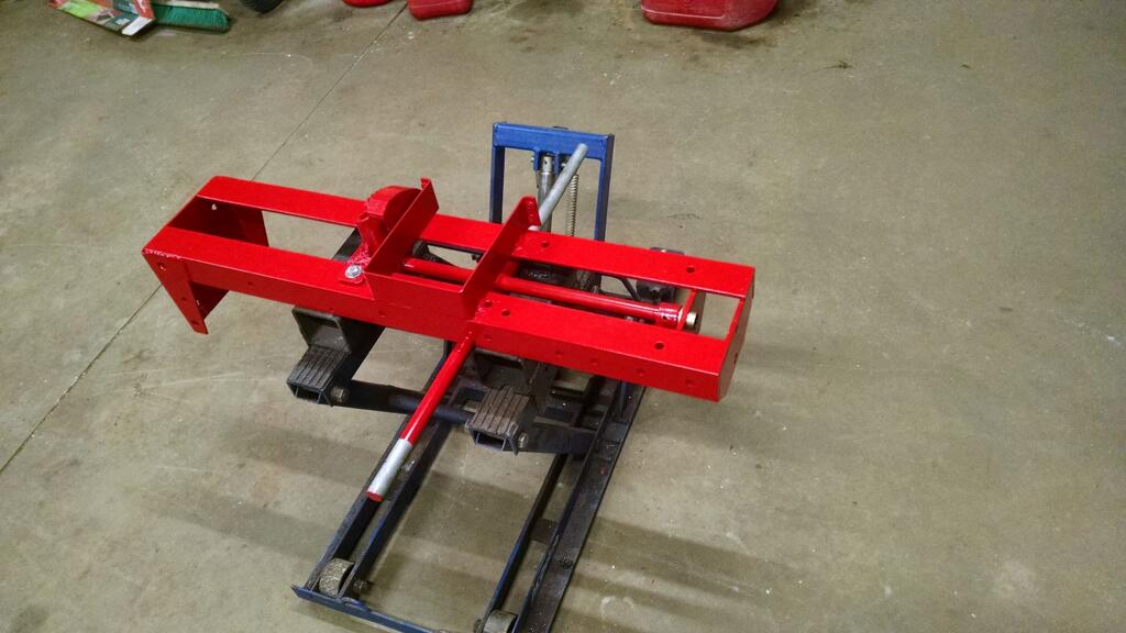

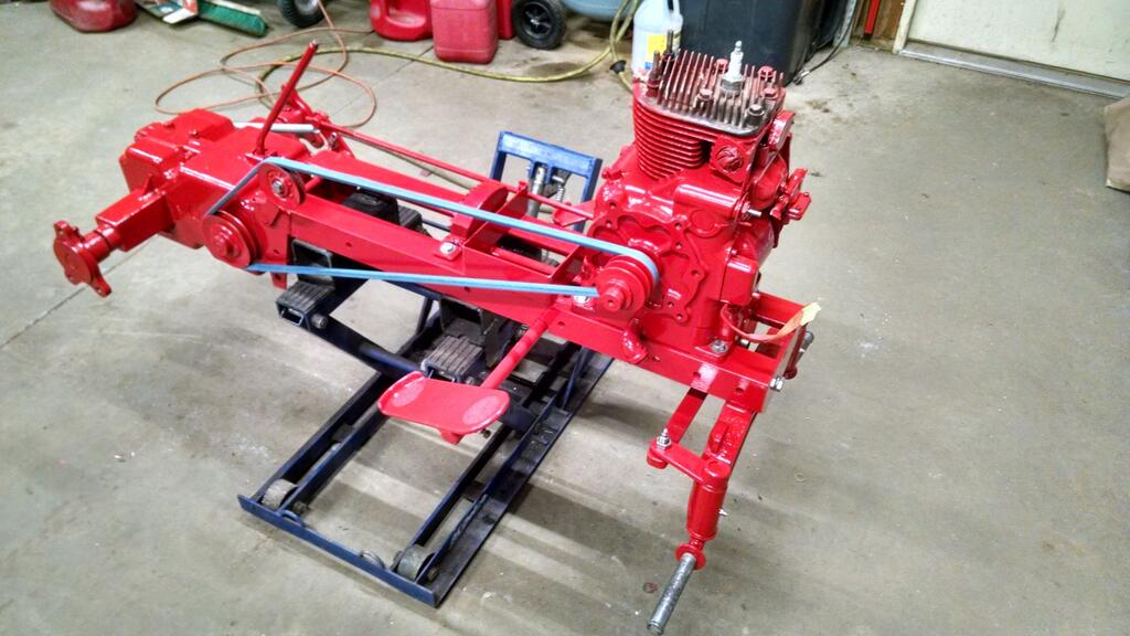

Achto 32,510 #74 Posted April 16, 2021 (edited) A progress report as promised. Had a fairly successful day and only had to make one trip to the hardware store. Even though they didn't leak before, I changed all of the shaft seals on the transmission. As long as all the pulleys & hubs were off I figured it a good idea. This is where I stopped for the day. I'll share my progress again after tomorrows adventures. Edited April 16, 2021 by Achto 1 6 1 2 Share this post Link to post Share on other sites
