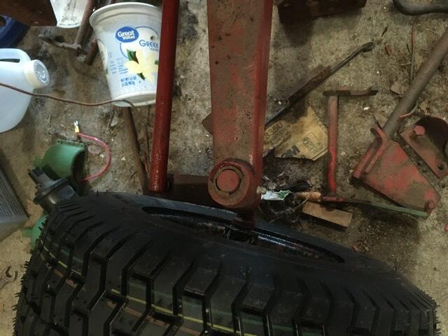

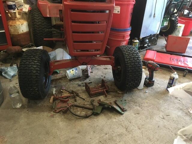

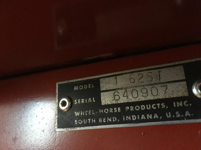

AHS 1,695 #1 Posted February 21, 2021 What’s going on? It’s been painted (8 years ago!) so it was all apart then... tie rods off. And I can’t remember the front axles? The steering wheel is in the middle and the right wheel is straight, the left is pointed outwards and they are fixed tie rods... they are the same length, 10”... oh by the way what year is it? 1970 or 71? Share this post Link to post Share on other sites
Lee1977 7,709 #2 Posted February 21, 2021 I have had that on my Wheel Horses. The way I fixed it was adjustable tie rods. I used heims joints to build mine. The set on my C-120 has been on 32 years and they are still just as good as they were new. 1 3 Share this post Link to post Share on other sites
ebinmaine 79,688 #3 Posted February 21, 2021 Do a search for 6251 and it should be a '70. I agree with @Lee1977 on the heim joints and custom tie rods. There were 2 lengths. I don't know how to tell by model or anything what it should have. 2 Share this post Link to post Share on other sites
pfrederi 20,869 #4 Posted February 21, 2021 Bent Spindle??. Look at the two spindles the tab the tie rod connects too look to be about perpendicular to the front axle yet the one wheel is canted way out. 1 Share this post Link to post Share on other sites
AHS 1,695 #5 Posted February 21, 2021 1 hour ago, pfrederi said: Bent Spindle??. Look at the two spindles the tab the tie rod connects too look to be about perpendicular to the front axle yet the one wheel is canted way out. Ok, this is where I will start pull both of the front wheel spindles, and mark the left one as ‘ok’ and see what the right one looks like. Otherwise, I will get an adjustable set. Share this post Link to post Share on other sites
Ed Kennell 46,578 #6 Posted February 22, 2021 I agree with Paul, the right spindle looks bent. Note how close the right tie rod is is to the tire. 1 Share this post Link to post Share on other sites

squonk 47,381 #10 Posted February 22, 2021 I have found spindles that had cracked welds where the plate the tie rod connects to attaches to the spindle. You almost can't even see it but it allows the spindle to rotate while the plate stays where it's supposed to be 3 Share this post Link to post Share on other sites

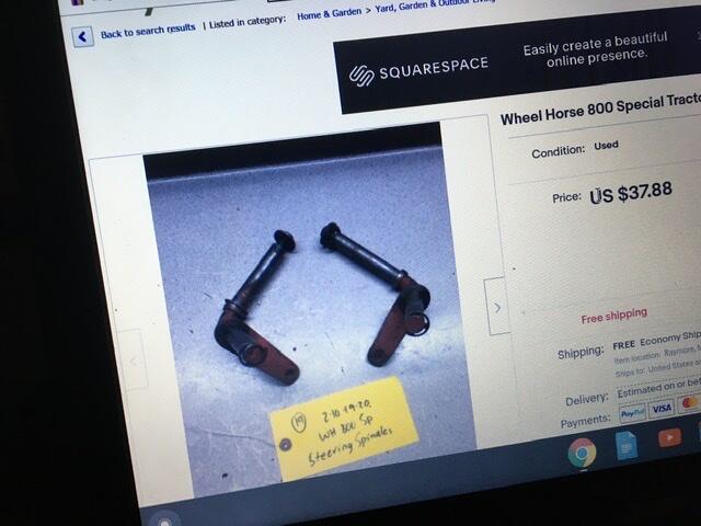

AHS 1,695 #12 Posted February 22, 2021 6 hours ago, squonk said: I have found spindles that had cracked welds where the plate the tie rod connects to attaches to the spindle. You almost can't even see it but it allows the spindle to rotate while the plate stays where it's supposed to be Ya, I guess that where it would be. .. that’s the only weld there. Ok, there 3/4” spindles on my ‘70 Raider 12, ‘73 14hp, and 76’ 8hp. eBay has a set of C160 ones, I guess those would be the same? 1 Share this post Link to post Share on other sites
ebinmaine 79,688 #13 Posted February 22, 2021 1 hour ago, AHS said: Ya, I guess that where it would be. .. that’s the only weld there. Ok, there 3/4” spindles on my ‘70 Raider 12, ‘73 14hp, and 76’ 8hp. eBay has a set of C160 ones, I guess those would be the same? They would be but how much are they?? Decent chance you'll be able to get them for less money from one of our own members or Lincoln at A To Z. Share this post Link to post Share on other sites
AHS 1,695 #14 Posted February 22, 2021 1 hour ago, ebinmaine said: They would be but how much are they?? Decent chance you'll be able to get them for less money from one of our own members or Lincoln at A To Z. What’s the number? $50 for two of em. Does it go by left once your sitting on the tractor? Or looking at the tractor... I think it the first one! Share this post Link to post Share on other sites
ebinmaine 79,688 #15 Posted February 22, 2021 1 minute ago, AHS said: What’s the number? $50 for two of em. Does it go by left once your sitting on the tractor? Or looking at the tractor... I think it the first one! MOST vehicles, equipment, whatever.... Left, Right are as seen by the driver/operater while SITTING IN the driver's seat. Lincoln's number is (717) 821-2542 CALL. Don't use the website. He's good people and very busy. My experience shows me the site often doesn't show things he really does have. 1 Share this post Link to post Share on other sites
AHS 1,695 #16 Posted February 22, 2021 eBay $38 for both spindle for an 800 special? Will these fit? They look like they will! @ebinmaine Share this post Link to post Share on other sites
ebinmaine 79,688 #17 Posted February 22, 2021 5 minutes ago, AHS said: eBay $38 for both spindle for an 800 special? Will these fit? They look like they will! @ebinmaine Ahhhh..... That I don't know. Not sure how those 800s were set up. 1 Share this post Link to post Share on other sites
AHS 1,695 #18 Posted February 22, 2021 The 800... They look the same. Made in 71, and have 8” wheels. Anyone else..are the 800 and the Raider 12 the same? Spindle wise... Share this post Link to post Share on other sites
Lee1977 7,709 #19 Posted February 22, 2021 The ones on the 300 series tractors are different with the 6" wheels. They change the axle on the later 520's and they are different. Your could break it loose and have it welded back right. The 800 special is a oddball tractor but the spindle numbers check out to be 115426 and 115425 they are the same number that the original Raider supereded to. My C-120 uses the same number. 1 Share this post Link to post Share on other sites
AHS 1,695 #20 Posted February 23, 2021 7 minutes ago, Lee1977 said: The ones on the 300 series tractors are different with the 6" wheels. They change the axle on the later 520's and they are different. Your could break it loose and have it welded back right. The 800 special is a oddball tractor but the spindle numbers check out to be 115426 and 115425 they are the same number that the original Raider supereded to. My C-120 uses the same number. Ya, I thought the 400 series would be the same. I have a 414-8..I haven’t measured it up yet. So the 800 and the Raider are the same? Share this post Link to post Share on other sites
Lee1977 7,709 #21 Posted February 23, 2021 the 400 series checks out ti be the same numbers. My early 520-H has different numbers but they look to be the same. Share this post Link to post Share on other sites
AHS 1,695 #22 Posted February 23, 2021 12 hours ago, Lee1977 said: The ones on the 300 series tractors are different with the 6" wheels. They change the axle on the later 520's and they are different. Your could break it loose and have it welded back right. The 800 special is a oddball tractor but the spindle numbers check out to be 115426 and 115425 they are the same number that the original Raider supereded to. My C-120 uses the same number. I ordered the 800 special spindles. For under $40, if they don’t work, paint them up and re sell them! I have a feeling that they will work. @ebinmaine 1 Share this post Link to post Share on other sites
