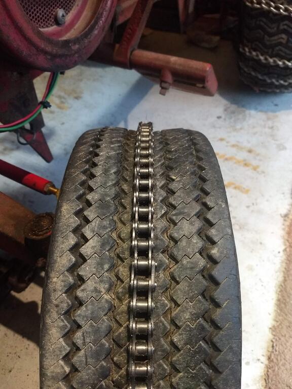

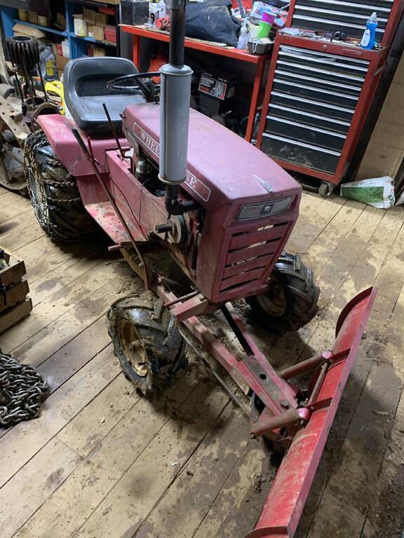

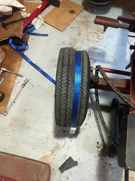

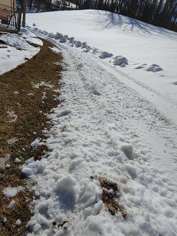

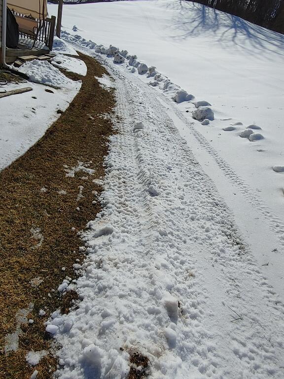

ebinmaine 79,467 #3 Posted February 20, 2021 (edited) General consensus is rubber in snow is bad no matter the tread design. Get some #40 roller chain and do like I've pictured below. It'll steer like it's on rails. Edited February 20, 2021 by ebinmaine 2 Share this post Link to post Share on other sites

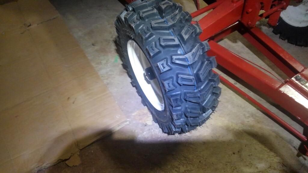

DennisThornton 4,773 #4 Posted February 20, 2021 2 minutes ago, kitkit said: do AG tires on the front end help steering/ sliding when trying to drive in snow . Thank you My first are on their way so I have no first hand experience but I ordered them after spending a lot of time searching this site. I gathered that they should be turned backwards, the reverse of the rears and that they do help steer in conditions that ags like, not packed snow or ice. For GT fronts search for roller chain. 2 Share this post Link to post Share on other sites
DennisThornton 4,773 #5 Posted February 20, 2021 1 minute ago, ebinmaine said: General consensus is rubber in snow is bad no matter the tread design. Get some #40 roller chain and do like I've pictured below. It'll steer like it's on rails. Man you got them nestled right in their groove! Way better than mine and I've got twice the PSI! Guess my colorful comments weren't feeling their stuff today. 1 2 Share this post Link to post Share on other sites
ebinmaine 79,467 #6 Posted February 20, 2021 4 minutes ago, DennisThornton said: Man you got them nestled right in their groove! Way better than mine and I've got twice the PSI! Guess my colorful comments weren't feeling their stuff today. They're a link too short I think but they sure do hold. Here's a pic of the ratchet strap in action. 4 Share this post Link to post Share on other sites

DennisThornton 4,773 #8 Posted February 20, 2021 2 hours ago, ebinmaine said: They're a link too short I think but they sure do hold. Here's a pic of the ratchet strap in action. No wonder your chain set in well! Ok, strap is the tool! And at least one link shy. Mine was 1/2 link shy. Share this post Link to post Share on other sites

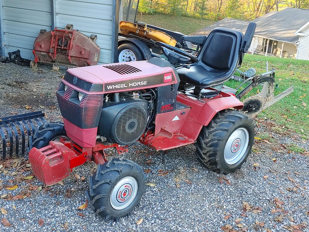

WVHillbilly520H 10,378 #12 Posted February 20, 2021 I have OTR LAWN TRAC R1s, in most cases pointed normal as the rears they are 100% better than turfs by far, but if you look at the tread pattern closely they have an overlapping flat center section which IMO gives these tires a couple of advantages over "standard" AG patterns, 1) better/smoother ride 2) more lateral traction/grip, 3) the corner/ends of the bars are flat/squared off which allows them to bite as well for more lateral grip, but alas rubber without maximum weight won't bite in frozen ground/grass or ice and of course they are not driven so basically its moot to consider them for actual straight line traction, but "flat" plowing of snow I have had excellent results but if side plowing along an incline even going down hill there is slippage, hell even my 4x4 eMax won't hold that line and steer without using the rear/independent "steering" brakes. 2 Share this post Link to post Share on other sites

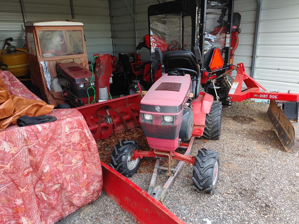

pfrederi 20,819 #14 Posted February 20, 2021 I have it on the snow blower tractor so not directly comparable to my plow tractor with Roller chain. The roller chain works better and is a lot smoother.... 1 Share this post Link to post Share on other sites

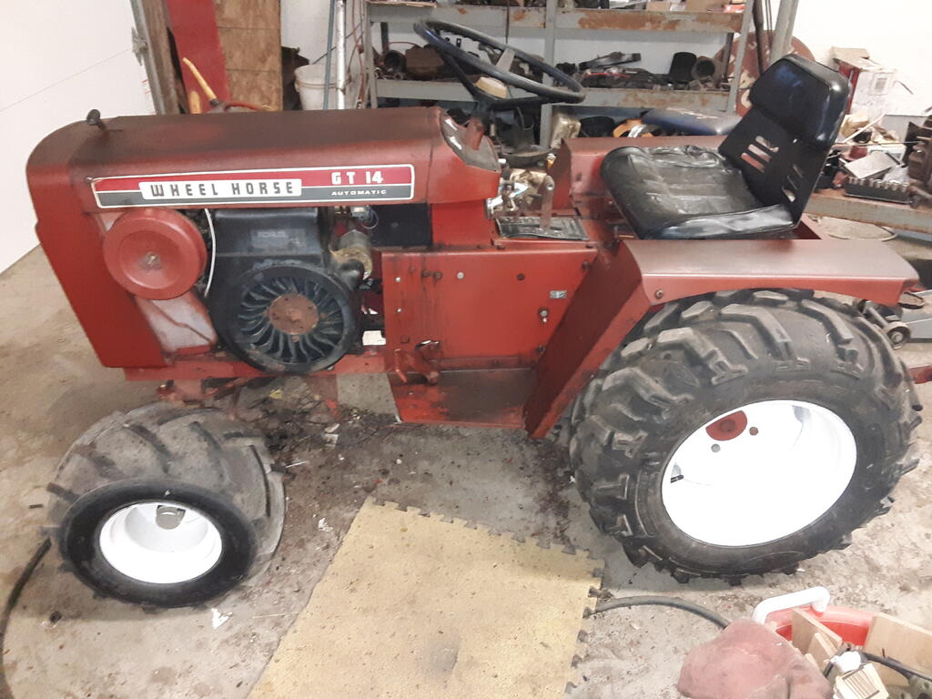

DennisThornton 4,773 #17 Posted February 20, 2021 1 hour ago, WVHillbilly520H said: I have OTR LAWN TRAC R1s, in most cases pointed normal as the rears they are 100% better than turfs by far, but if you look at the tread pattern closely they have an overlapping flat center section which IMO gives these tires a couple of advantages over "standard" AG patterns, 1) better/smoother ride 2) more lateral traction/grip, 3) the corner/ends of the bars are flat/squared off which allows them to bite as well for more lateral grip, but alas rubber without maximum weight won't bite in frozen ground/grass or ice and of course they are not driven so basically its moot to consider them for actual straight line traction, but "flat" plowing of snow I have had excellent results but if side plowing along an incline even going down hill there is slippage, hell even my 4x4 eMax won't hold that line and steer without using the rear/independent "steering" brakes. Mine arrive here on the 28th. Not sure what I'm going to do with them... Glad to hear you like yours, and faced as they are. But, have you run with ags on the front reversed? Share this post Link to post Share on other sites
DennisThornton 4,773 #18 Posted February 20, 2021 I'm going to add tire chains to the front of my compact but I've never had any intent to do so on a 2wd. Certainly not now that I have roller chains. Then again I've never had any intent to put ags on the front yet I've got some coming... BUT, I can put roller chain on them too! Or not. Or remove them. Or... Share this post Link to post Share on other sites
WVHillbilly520H 10,378 #19 Posted February 20, 2021 3 minutes ago, DennisThornton said: Mine arrive here on the 28th. Not sure what I'm going to do with them... Glad to hear you like yours, and faced as they are. But, have you run with ags on the front reversed? No I haven't and don't plan to, even though they aren't driven my mind works differently in I have to have "symetry" and this is working for me. Never seen a MFWD(4X4) farm tractor come factory with front tires reverses even though it may actually help with reverse traction in the barn lots. 3 minutes ago, DennisThornton said: I'm going to add tire chains to the front of my compact but I've never had any intent to do so on a 2wd. Certainly not now that I have roller chains. Then again I've never had any intent to put ags on the front yet I've got some coming... BUT, I can put roller chain on them too! Or not. Or remove them. Or... @Ed Kennell IMHO, these would be the best front tires chain option for turf , AG, or "snowblower" type treads, it blends the roller chain and crosslink style, might be a bit rough riding though ... https://www.amazon.com/dp/B00PXAQO7K/ref=cm_sw_r_cp_apa_fabc_14ZCZ8V2AASZ63GDX8K7... Also has my 4x4 ATV out to play just a little bit ago even with the big deep treads low tire air pressure and front axle engaged it still wouldn't climb over iced over plow banks (like steering against an angled blade) just kept clawing along straight with the the wheels turned hard. 2 1 Share this post Link to post Share on other sites
