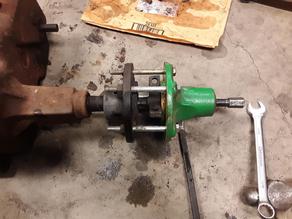

Oldskool 6,678 #3 Posted February 17, 2021 The transmission is coming apart to get freshened up because I'm not getting 3rd n 4th gear. @ebinmaine I said I wouldnt use a 3 jaw puller to get the hubs off BUT........I did... 4 1 1 Share this post Link to post Share on other sites
ebinmaine 80,483 #4 Posted February 17, 2021 56 minutes ago, Oldskool said: The transmission is coming apart to get freshened up because I'm not getting 3rd n 4th gear. @ebinmaine I said I wouldnt use a 3 jaw puller to get the hubs off BUT........I did... Heat the lava right to it and you'll do fine. That's a very similar setup to what I do. 1 Share this post Link to post Share on other sites
Oldskool 6,678 #5 Posted February 17, 2021 14 minutes ago, ebinmaine said: Heat the lava right to it and you'll do fine. That's a very similar setup to what I do. They are both off and in 1 piece. 3 2 Share this post Link to post Share on other sites

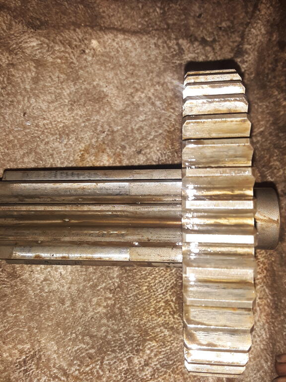

Oldskool 6,678 #17 Posted February 17, 2021 For sitting in a rotten shed, snow covered and no oil in it, everything is looking pretty good. 2 Share this post Link to post Share on other sites

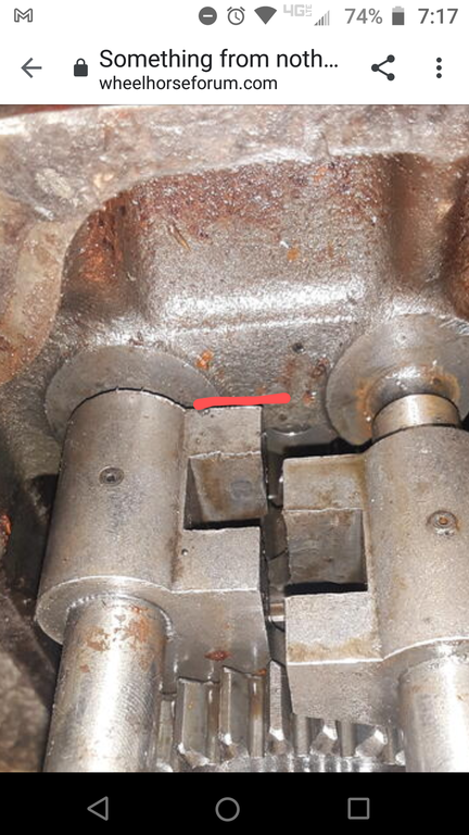

ebinmaine 80,483 #21 Posted February 18, 2021 27 minutes ago, Oldskool said: I went to the link above and watched the video but did not see how to get the shift fork shafts out and one is stuck in place Those should line up. (That's neutral) Stick a lever where I made a red line and gently pry up. Share this post Link to post Share on other sites

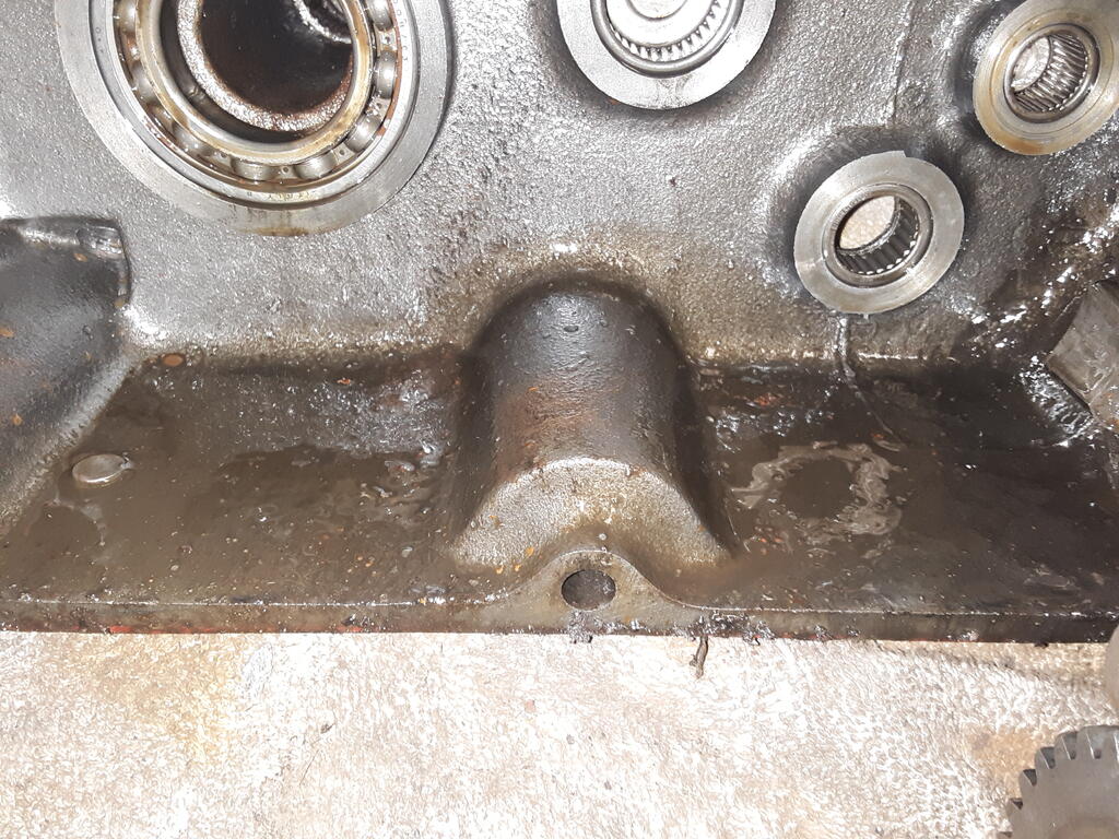

Oldskool 6,678 #22 Posted February 18, 2021 9 minutes ago, ebinmaine said: Those should line up. (That's neutral) Stick a lever where I made a red line and gently pry up. I have it out to neutral now but cant get it to the next detent. But how do they come out of the case when I get them moving freely ? Share this post Link to post Share on other sites
ebinmaine 80,483 #23 Posted February 18, 2021 4 minutes ago, Oldskool said: I have it out to neutral now but cant get it to the next detent. But how do they come out of the case when I get them moving freely ? Should be a hole in the front of the case where there will be a set screw type thing or a freeze plug. Remove that.... PAY ATTENTION. This is the home of the (in) famous "hoobie doobie balls". They will roll from your place to roughly Cincinnati before stopping. 2 1 Share this post Link to post Share on other sites
Oldskool 6,678 #24 Posted February 18, 2021 5 minutes ago, ebinmaine said: Should be a hole in the front of the case where there will be a set screw type thing or a freeze plug. Remove that.... PAY ATTENTION. This is the home of the (in) famous "hoobie doobie balls". They will roll from your place to roughly Cincinnati before stopping. Ok I did see that in the video. I was under the assumption it was a set screw. Mine doesnt have a set screw. So must be a plug? I assume I drill that out and tap to replace with set screw? Share this post Link to post Share on other sites
ebinmaine 80,483 #25 Posted February 18, 2021 18 minutes ago, Oldskool said: Ok I did see that in the video. I was under the assumption it was a set screw. Mine doesnt have a set screw. So must be a plug? I assume I drill that out and tap to replace with set screw? That I'm not sure of. All of mine have had screws.... And now we call in @stevasaurus. 2 Share this post Link to post Share on other sites
