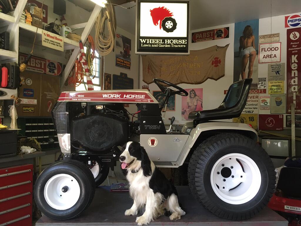

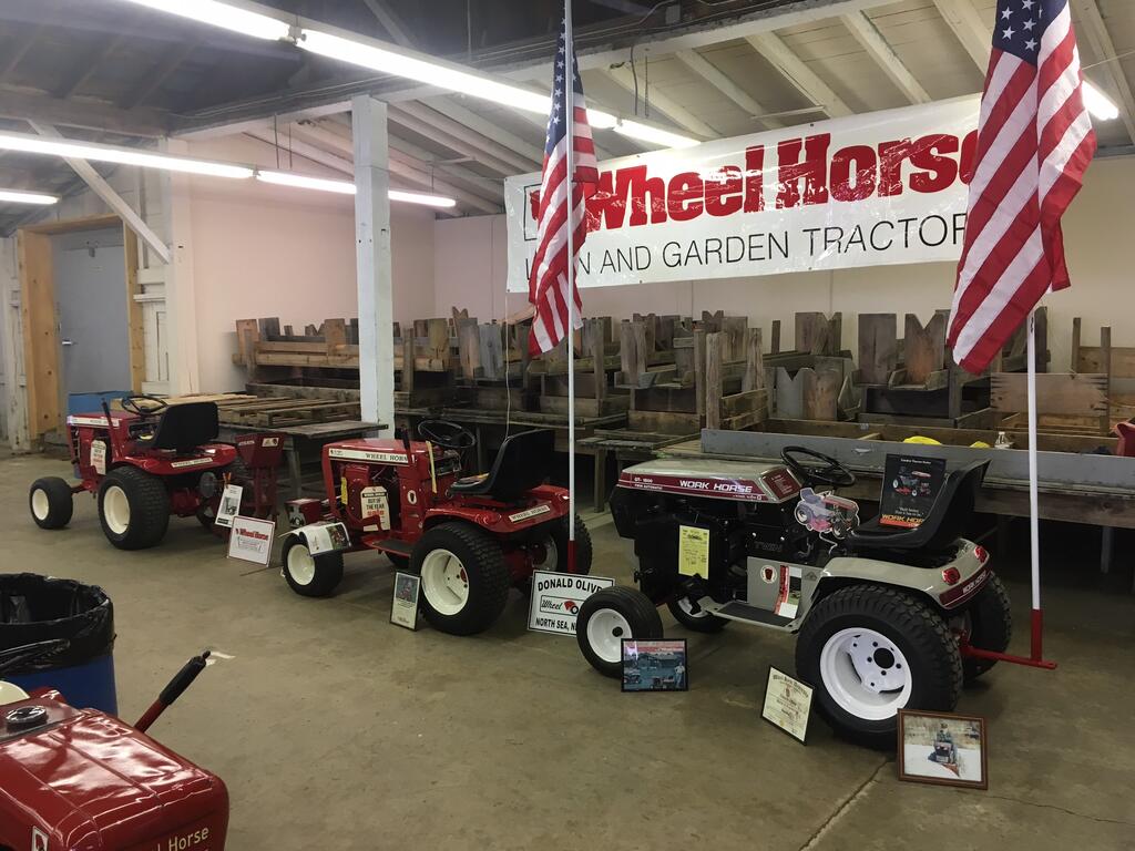

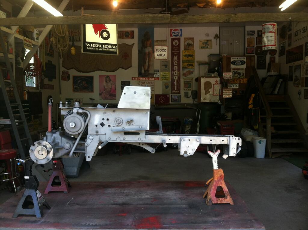

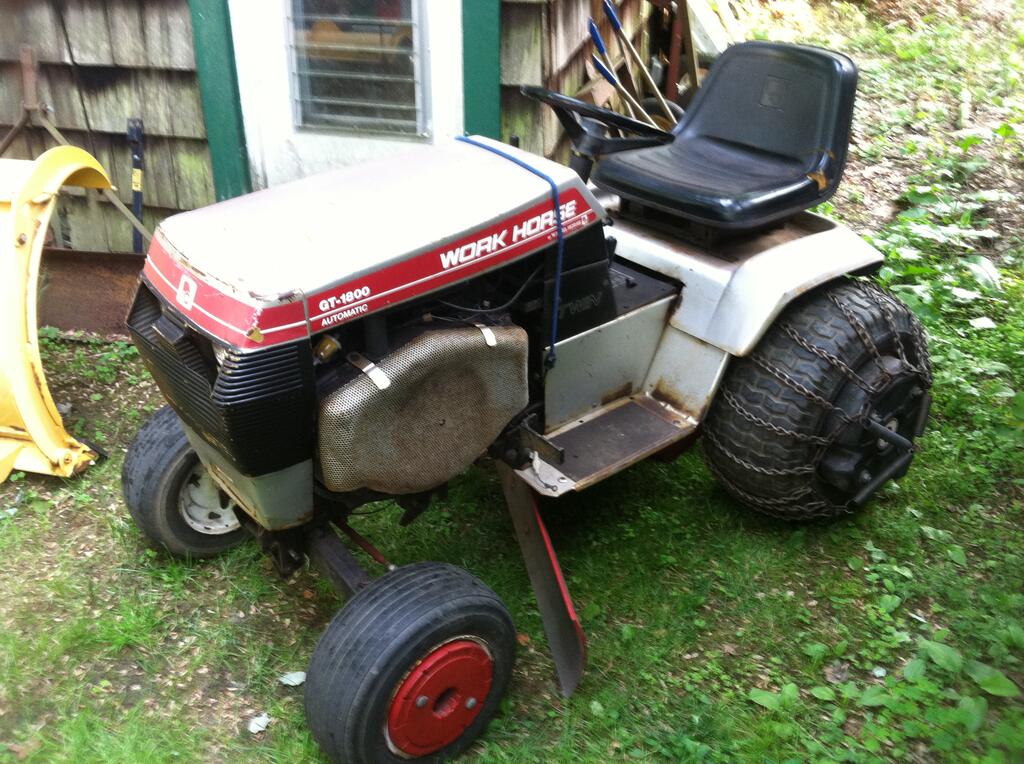

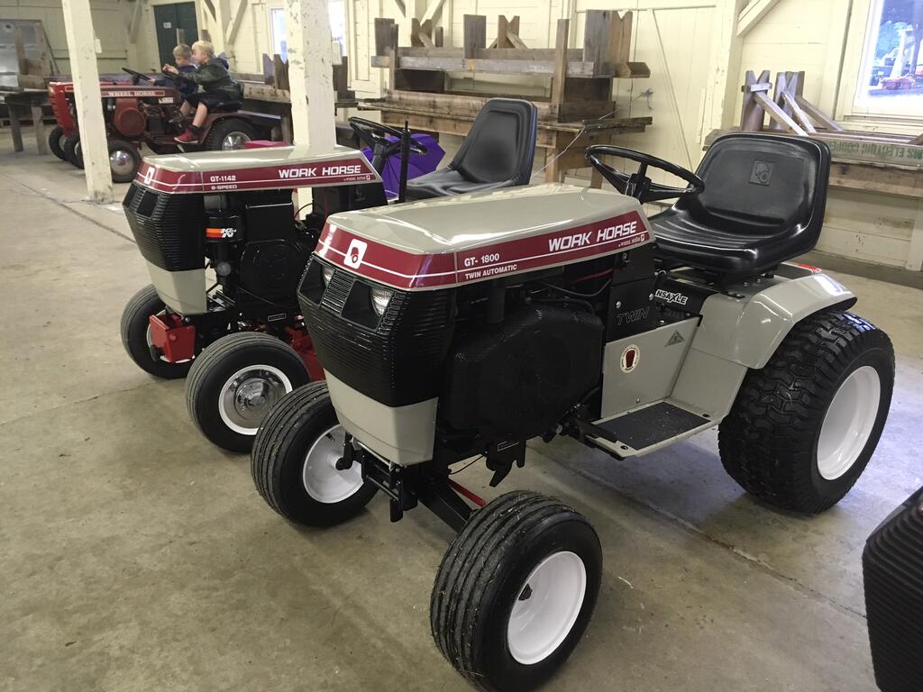

c-series don 11,963 #5 Posted February 13, 2021 1 hour ago, gwest_ca said: Paint used was two Ford colors Pewter metallic part number 8-0335 for 1982 models - Automotive equivalent 1971 Lincoln-Mercury Pewter Metallic Pewter gray part number 8-0337 for 1983-84 models (Not metallic) - Automotive equivalent 1982 Lincoln Light Pewter Will let others suggest a hood source. Garry Garry is totally correct on this. I used the pewter gray non metallic 1982 Lincoln light pewter which is correct for my 1984 GT-1800 that I bought new in august of 84. I restored it about 3 years ago after countless hours of work with that tractor. It is this tractor that got me hooked on Wheel Horse tractors. They are not red but they are Wheel Horse through and through. 3 Share this post Link to post Share on other sites
roadapples 6,987 #6 Posted February 13, 2021 Nice tractors. Flood area looks real dangerous though... 3 Share this post Link to post Share on other sites
Emt260 15 #7 Posted February 13, 2021 Thank all of you! I plan on taking all the metal off and have it repainted. I will post pictures of what it looks like. @c-series don yours came out amazing! I have a love for this tractor, and if I had the space I would own a dozen more! 2 Share this post Link to post Share on other sites

c-series don 11,963 #9 Posted February 13, 2021 (edited) 10 hours ago, roadapples said: Nice tractors. Flood area looks real dangerous though... I’ve had that poster since I was about 14. It used to hang in my bedroom when I was a kid. I stored it away for many years and finally when I built my garage she was the FIRST thing to get hung up. My wife said oh no you are not hanging that up in here. I said you don’t understand, I had a relationship with her as a teenager. She never said no and never talked back. She’s still hanging there 24 years later and hasn’t aged a bit. Still don’t even know her name 😂👍🏻 Edited February 13, 2021 by c-series don 1 1 Share this post Link to post Share on other sites
