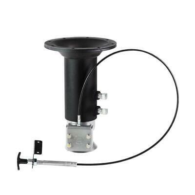

Pullstart 71,327 #9 Posted February 12, 2021 Reason I ask, is we recently ordered a 5th wheel Toy Hauler camper. I have a turnover ball gooseneck hitch in Norman. The idea of this Andersen Ranch Hitch excites me. I can’t think of a reason it wouldn’t work, so I made a deal on one. It has a threaded 3 piece wedge assembly that goes onto the groove of the trailer pin, then the assembly threads on and is either welded or bolted into place as a fail safe. I will add safety chains as well. Share this post Link to post Share on other sites

cschannuth 3,821 #11 Posted February 12, 2021 8 minutes ago, pullstart said: Reason I ask, is we recently ordered a 5th wheel Toy Hauler camper. I have a turnover ball gooseneck hitch in Norman. The idea of this Andersen Ranch Hitch excites me. I can’t think of a reason it wouldn’t work, so I made a deal on one. It has a threaded 3 piece wedge assembly that goes onto the groove of the trailer pin, then the assembly threads on and is either welded or bolted into place as a fail safe. I will add safety chains as well. My brother installed one of these adapters and it worked great. Like you, he already had the turnover ball in his truck and didn’t feel like having to mess around with the fifth wheel hitch. 1 Share this post Link to post Share on other sites
