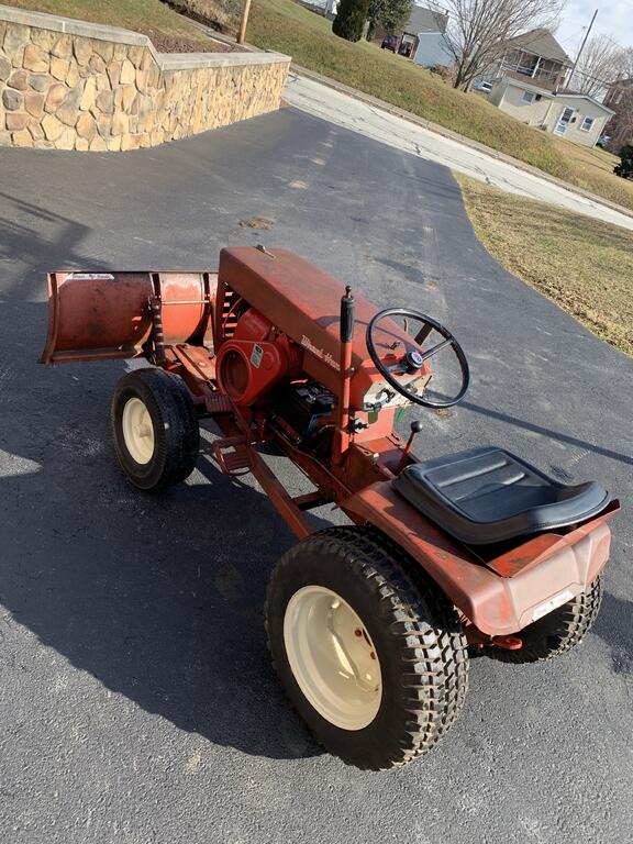

jamessparks 55 #1 Posted February 10, 2021 Kohler 181 used it to plow on Sunday with no problem. Today I go out in the shed to start up and motor flywheel makes a squeal noise and barely turns over. I can hold the key and it will barely spin the motor flywheel. Thoughts? Share this post Link to post Share on other sites

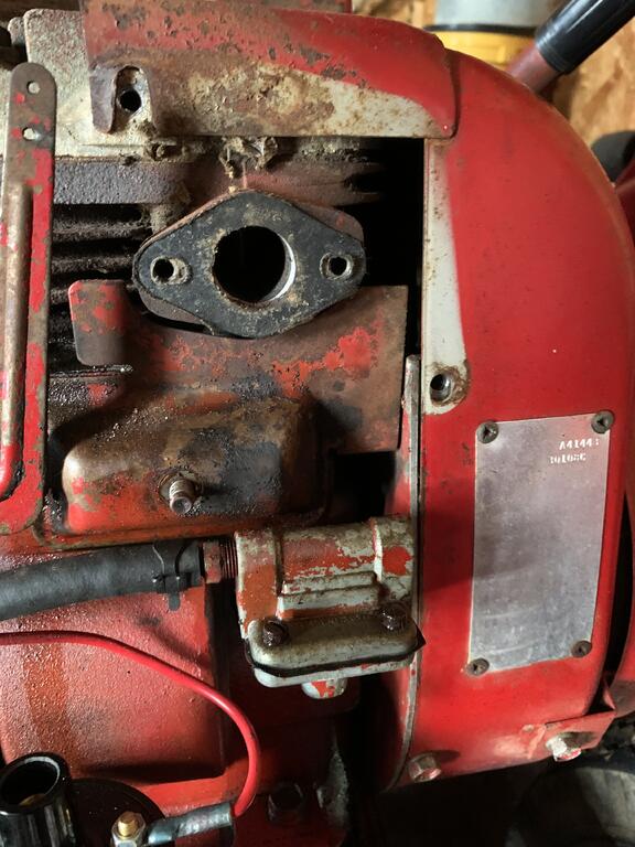

jamessparks 55 #8 Posted February 10, 2021 Yes @Ed Kennell but I believe it’s something with Compression. Got the carb off but trying figure out how to get this plate off to see the valves. 🤔 Share this post Link to post Share on other sites

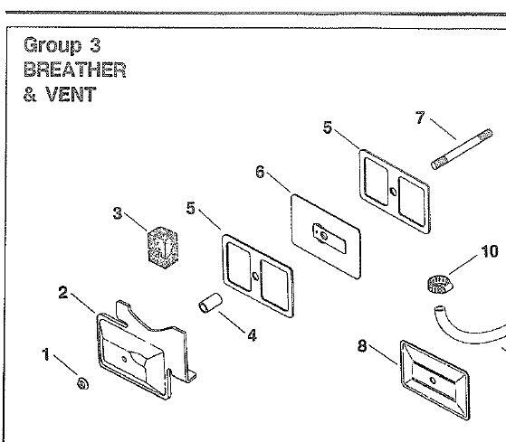

pfrederi 20,657 #9 Posted February 10, 2021 You will have to pry it is probably stuck to its gasket. Share this post Link to post Share on other sites
Ed Kennell 46,198 #10 Posted February 10, 2021 If it is that tight , the gasket will probably need replaced. Make sure you keep all the parts of the breather in order for reassembly. Share this post Link to post Share on other sites

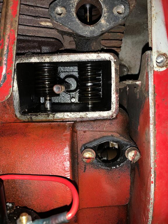

jamessparks 55 #12 Posted February 10, 2021 Yes both gaskets broke. So I’ll need some help finding them. Haha. Here’s what the valves look like Share this post Link to post Share on other sites
pfrederi 20,657 #13 Posted February 10, 2021 Gaskets 230048 Share this post Link to post Share on other sites

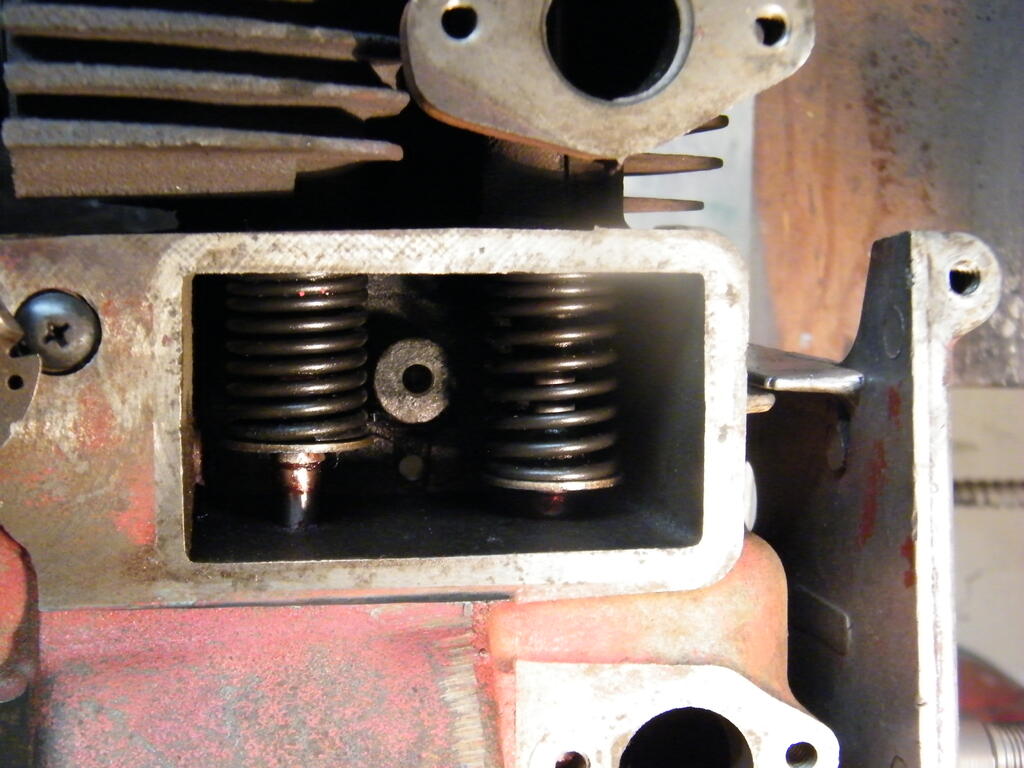

jamessparks 55 #14 Posted February 10, 2021 Thoughts? I was reading and read something about a compression spring? Like I said, it even spins free now with power hooked up. When everything was together it was tight and made a squeal noise and barely would turnover. Share this post Link to post Share on other sites
Ed Kennell 46,198 #15 Posted February 10, 2021 Are you saying it turns over easy now with the plug in place? Share this post Link to post Share on other sites
rmaynard 17,218 #16 Posted February 10, 2021 Were you referring to the ACR (automatic compression release)? That image appears to have the exhaust valve open and the intake closed, which should not be building up pressure. Next turn of the flywheel should have the exhaust valve closed and the intake open. 1 Share this post Link to post Share on other sites
jamessparks 55 #17 Posted February 10, 2021 Yes sitting as is with the valve open if I turn the key to start with no plug in it turns over fine. Put the plug in, it gets all tight again and doesn’t want to spin/turn over without dragging from the main flywheel Share this post Link to post Share on other sites
