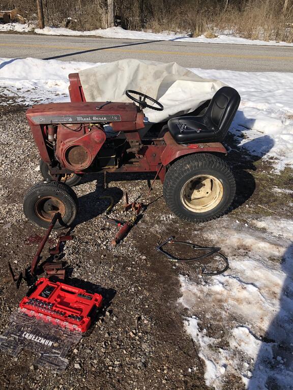

Sammy 89 #1 Posted February 9, 2021 I’m putting this topic out there because I want to know if there’s anything I should know going into this conversion. I recently bought a 1966 1276 and it had a manual lift on it but I’m restoring this tractor in the spring for my grandpa who had one as a kid so he can mow with it. I have a hydraulic valve, cylinder, and center lift shaft off of a 1969 electro 12 that I’d like to put on for his convenience. Is there anything I need to know with this conversion or any issues that someone else has had that has done this? I’m basing it off of a 1277 full hydro I already have! Share this post Link to post Share on other sites

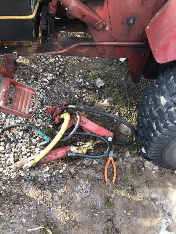

Sammy 89 #4 Posted February 9, 2021 Just now, pullstart said: It should be plug and play there. You might want to check the integrity of the hoses, wouldn’t want to blow one up on grandpa. Ok that’s good, I was unaware if there were any springs or valves that need to be changed in the transmission pump body. And we have 2 good good year hoses and have 2 more coming soon. The one hose in that picture had a broken fitting and the other had quite the slit through it! Share this post Link to post Share on other sites

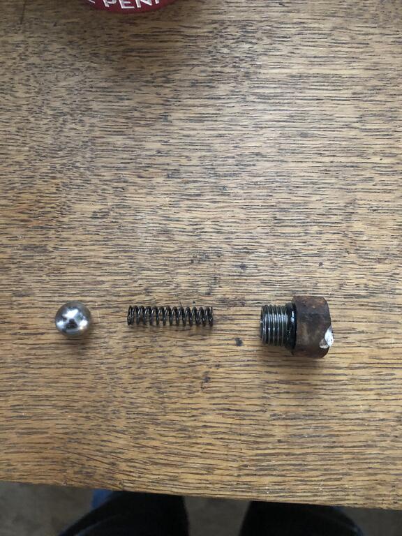

Sammy 89 #10 Posted February 9, 2021 (edited) 19 minutes ago, ebinmaine said: Yes sir. I just did this conversion on a 1970 Charger. There's a pressure spring and a little holder that needs to be transferred... Paul or Dave could explain that. I would highly recommend new hoses. Lowell at Wheel Horse Parts And More sells them. Ok and would you I be able to buy them. We sold the transmission a while ago but didn’t save the spring or the holder. We have a part C-141 hydro, would it be in there? Edited February 9, 2021 by Sammy Share this post Link to post Share on other sites

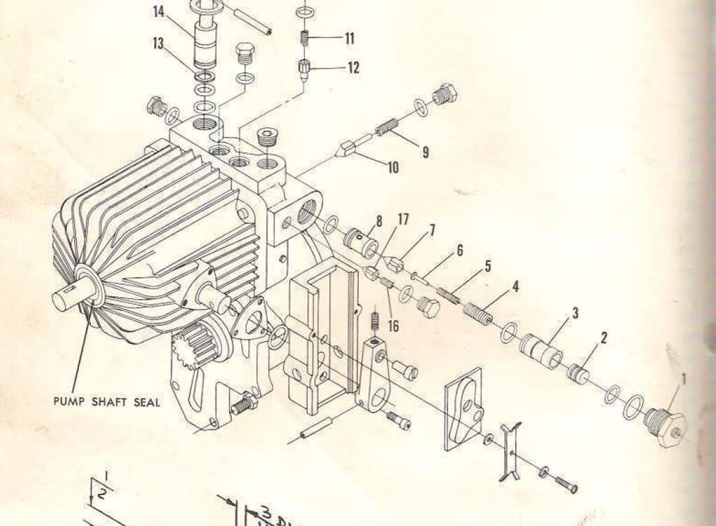

pfrederi 21,145 #13 Posted February 9, 2021 (edited) You need to see if the 16 and 17 are in your hydro (I doubt it) It is the implement relief valve and is needed EDIT Also I am pretty sure your C-141 parts tractor is a piston to piston mot a hydro gear. Edited February 9, 2021 by pfrederi 1 Share this post Link to post Share on other sites
Sammy 89 #14 Posted February 9, 2021 Ok I see what I need but would these out of the c141 work? Share this post Link to post Share on other sites
pfrederi 21,145 #15 Posted February 10, 2021 17 hours ago, Sammy said: Ok I see what I need but would these out of the c141 work? Honestly do not know. The hydro gear relief is a cone shaped valve. Not sure the ball would seal well. You could put it in and try it. Wouldn't hurt anything if it didn't seal just the lift wouldn't operate or would work some but not lift anything. Share this post Link to post Share on other sites
Sammy 89 #16 Posted February 10, 2021 Ok thank you for replying. So if I were to try to ball it wouldn’t affect anything in the pump? Share this post Link to post Share on other sites
pfrederi 21,145 #17 Posted February 10, 2021 2 minutes ago, Sammy said: Ok thank you for replying. So if I were to try to ball it wouldn’t affect anything in the pump? Don' believe it will hurt anyhitng. I did find that in some later piston to piston units they changed from a ball relief valve to a cone. Didn't change the seat so maybe your ball would seal... Share this post Link to post Share on other sites
Sammy 89 #18 Posted February 10, 2021 Ok thank you, I’ll definitely give it a shot because trying not find that cone is useless I’ve tried a lot of guys and can’t find one. Hopefully the ball seals and the spring from the 141 to my understanding is about the same. It’s supposed to be a little over an inch long and that one is an inch and 3/16 so it should work Share this post Link to post Share on other sites
