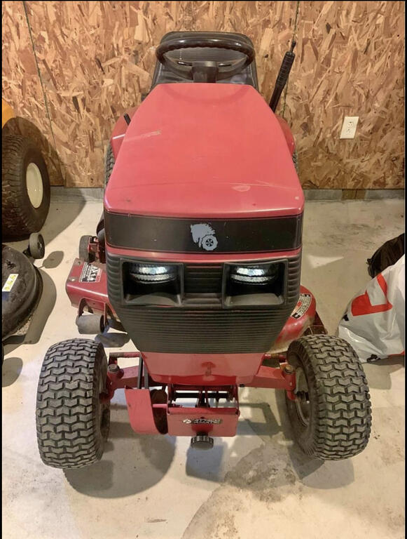

Bcmedic85 12 #1 Posted February 7, 2021 Just bought my first new to me 1994 wheel horse 312-8. Only known issue stated from the seller is the drive belt will slip due to the pulleys being glazed he had a new one put on. A small equipment shop mechanic advised him of the pulleys. My question is anything simple easy things I can check to troubleshoot and verify the pulleys are the problem? Also what is everyone’s advice with getting parts online? How can I verify I’m getting the correct parts for my machine? 2 1 Share this post Link to post Share on other sites

Pullstart 68,938 #8 Posted February 7, 2021 I’d start with just the new belt. They are designed to slip across the pulleys when the clutch is in, until the belt stops. The Kevlar on the edges of the belt eventually gets hard or worn away and most times a new belt will be just what you need for all the pushing and pulling power you need. You’ll learn, traction = weight. These tractors very seldom run out of power, they run out of grip. 7 Share this post Link to post Share on other sites
Bcmedic85 12 #9 Posted February 7, 2021 1 minute ago, pullstart said: I’d start with just the new belt. They are designed to slip across the pulleys when the clutch is in, until the belt stops. The Kevlar on the edges of the belt eventually gets hard or worn away and most times a new belt will be just what you need for all the pushing and pulling power you need. You’ll learn, traction = weight. These tractors very seldom run out of power, they run out of grip. The buyer stated he did put a new drive belt on, however I did some reading and seen that if the proper type of belt isn’t put on they are prone to slipping. Anyway to tell if he put the correct type of belt on? 1 Share this post Link to post Share on other sites
squonk 45,591 #10 Posted February 7, 2021 You don't need to install a WH OEM belt. I've used Napa green or blue TSC belts with no issues. See if you can get the I.D. of the tractor and the number of the belt he put on. Also pics with the belt guard off will let us see if there are any other issues going on. you really have to glaze and wear out the pulleys badly to be an issue. 4 Share this post Link to post Share on other sites

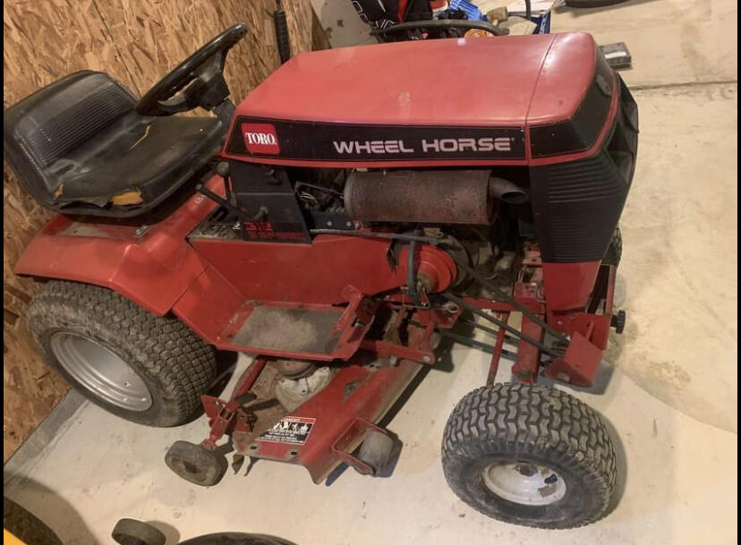

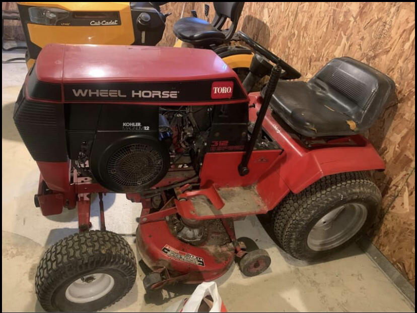

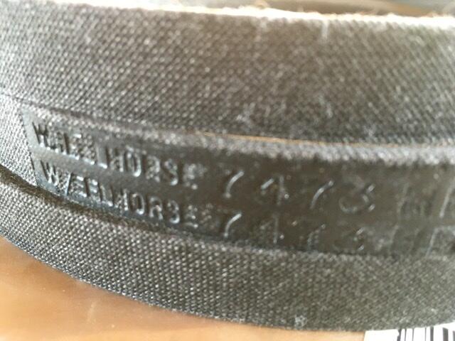

tom2p 2,394 #20 Posted February 8, 2021 (edited) make sure to install a molded and wrapped belt - similar to the OEM Wheel Horse belts I've only used OEM Wheel Horse drive belts - but others have good luck with other belts Edited February 8, 2021 by tom2p 2 Share this post Link to post Share on other sites
tom2p 2,394 #21 Posted February 8, 2021 (edited) 5 hours ago, Bcmedic85 said: something is up with the clutch pedal placement - at rest it appears to be too far toward the rear of the tractor could be due to the floor board placement can't recall for sure but I believe the pedal rests on the front part of the floor board inside cutout - if so might need to move the floor board up and/or in in to get the clutch pedal to the correct position ... again can't recall - would need to look at it to be sure or possible the clutch rod or similar adjustment is required note the clutch pedal placement on the 312-8 pictured below Edited February 8, 2021 by tom2p 4 1 Share this post Link to post Share on other sites
oliver2-44 11,258 #22 Posted February 8, 2021 Tom caught a good clue in that picture. I think the clutch peddle and floorboard are mounted correctly. But the Clutch Pedal Gas or Spring is shot or missing for that pedal to be laying that far back. Item 54 is the Gas Damper. https://www.partstree.com/models/73362-312-8-toro-garden-tractor-sn-049000001-049999999-1994/clutch-brake-and-speed-control-linkage-7/ 1 1 Share this post Link to post Share on other sites
DennisThornton 4,773 #23 Posted February 8, 2021 (edited) See above! Maybe oil the clutch pedal shaft first! Edited! BTW. I had a clutch spring break too! Check it as well! You will see the clutch doesn't spring back and for as I suggested earlier. My bad... Should have mentioned that. Edited February 8, 2021 by DennisThornton Share this post Link to post Share on other sites
haydendavid380 759 #24 Posted February 8, 2021 (edited) A short belt will also pull the pedal down and cause issues that seem like it's slipping. Had a similar issue with a belt marked as that correct length, but in reality was almost an inch short. I'd go to a local store where you can measure the belt in person and match it to the proper spec. Put that on and see how that does. Edited February 8, 2021 by haydendavid380 Share this post Link to post Share on other sites
953 nut 64,275 #25 Posted February 8, 2021 9 hours ago, tom2p said: something is up with the clutch pedal placement - at rest it appears to be too far toward the rear of the tractor Good eye there. If the foot rest on the right side is too far in it will catch the clutch arm and prevent it from tightening the belt completely. @Bcmedic85, move the right foot rest out a bit and see if there is any change. All that is needed is a 1/2" wrench to loosen the clamps on the foot rest. Share this post Link to post Share on other sites
