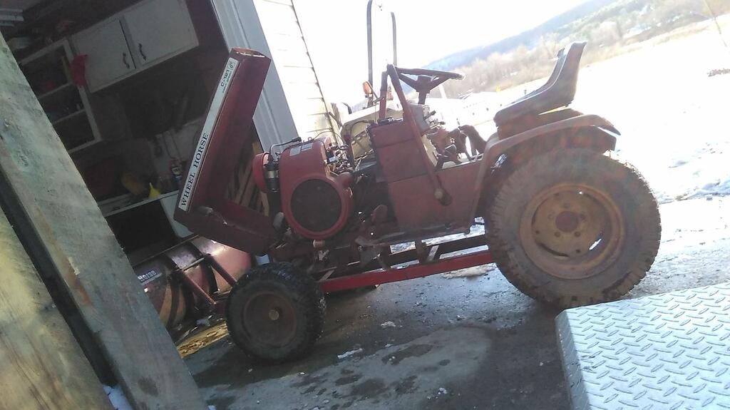

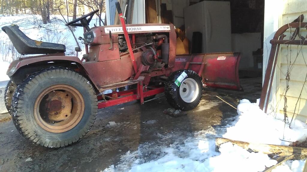

Robt64 15 #1 Posted February 4, 2021 So my sister wanted this old girl out of her garage. Threw on a new carb, solenoid and tire. Will work on the mower deck in the future. My question for now is, if there a way to adjust the plowing height of the plow? Right now in the up position the lowest height is roughly 5 inches off the ground. Are these plow made to set on the ground for plowing and/or could I attach small shoe to prevent digging in? Also, there is a lot of play in the clutch pedal...is there any adjustment to return the pedal to it's disengaged position? Thank you! 6 Share this post Link to post Share on other sites
briankd 833 #2 Posted February 4, 2021 (edited) there is an adjustment knob right by the lift handle and the lift link/ chain my need adjusted for more length to the plow frame Welcome to the forum looks like a great tractor !!!! Edited February 4, 2021 by briankd 1 Share this post Link to post Share on other sites
Handy Don 17,563 #3 Posted February 4, 2021 Nice looking machine. Are you saying that the big lever isn't putting the plow down onto the ground? 1 Share this post Link to post Share on other sites
Robt64 15 #4 Posted February 4, 2021 The lever is letting the plow on the ground. I wanted to stop in just an inch or so to prevent digging in the yard. Yes Brian, I noticed there is a short chain hanging underneath...which I do not believe is attached to anything. I'll be going back out tomorrow to evaluate the situation a little more. Share this post Link to post Share on other sites
Handy Don 17,563 #5 Posted February 4, 2021 The upper arrow points to the knob that adjusts the lowest point. Clockwise to raise it; counter clockwise to lower it. If the tractor has been sitting and rained on, the screw can get rusty and frozen so it may need a dose of penetrant to get loose. The lower arrow points to the bracket on the plow frame where the lift chain attaches, If the chain is too tight, take the tension off by lifting and blocking the front of the plow and change where the plow attaches to the chain. 3 Share this post Link to post Share on other sites
Robt64 15 #6 Posted February 4, 2021 (edited) The knob is free and turns but wasn't doing anything so I imagine the chain is not hooked up. I'll have to climb under it again and have a look/see. Thank you! Next issue is the steering, wheel turns much easier when tractor is in motion... Edited February 4, 2021 by Robt64 Share this post Link to post Share on other sites
cschannuth 3,821 #7 Posted February 4, 2021 (edited) 5 minutes ago, Robt64 said: The know is free and turns but wasn't doing anything so I imagine the chain is not hooked up. I'll have to climb under it again and have a look/see. Thank you! Next issue is the steering, wheel turns much easier when tractor is in motion... The knob limits how far the lift lever will lower. If you’re able to lift the blade with the lift lever the knob should limit how far the handle will go down and that will limit how far the blade will lower. Welcome to RS! Edited February 4, 2021 by cschannuth 2 Share this post Link to post Share on other sites
Handy Don 17,563 #8 Posted February 4, 2021 Just now, Robt64 said: steering, wheel turns much easier when tractor is in motion... Yep. Normal. No power steering. There are lubrication point (grease zerks) on the front axle for each spindle--should hit them with 3-4 pumps of a grease gun every 25-30 operating hours. 2 Share this post Link to post Share on other sites

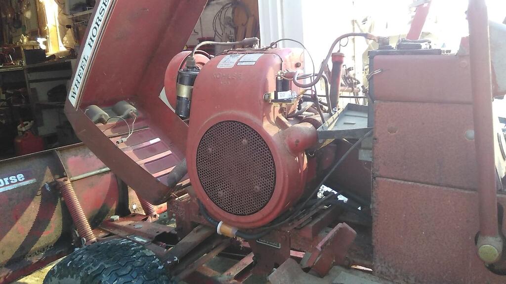

Pullstart 71,367 #15 Posted February 5, 2021 The hood says C-121. It is a 12 HP Kohler powered machine, awesome worker! When you grease the front axle pivot, it’s best to jack the FRAME up to relieve pressure off the pin and allow grease into the right place. Also, whenever you’re under the tractor, please don’t just trust the jack... block it up You were smart enough to not scrap this awesome piece of work, so I assume you already knew to use jack stands 1 Share this post Link to post Share on other sites

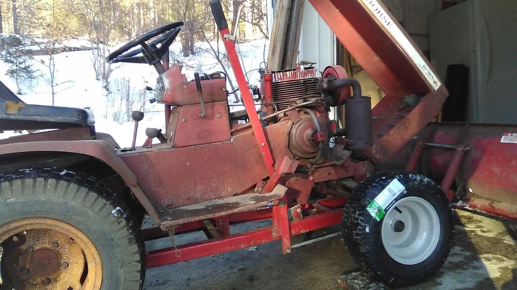

oliver2-44 11,782 #16 Posted February 5, 2021 (edited) It looks like your clutch lever is flopped forward which I suspect means the spring is probable broke/missing. The image below may not be your exact tractor but will give you an idea of where to look for the spring. https://www.partstree.com/models/1-0353-c-120-toro-lawn-tractor-1974/brake-clutch-linkage-0/ Edited February 5, 2021 by oliver2-44 Share this post Link to post Share on other sites
Robt64 15 #17 Posted February 5, 2021 22 minutes ago, oliver2-44 said: It looks like your clutch lever is flopped forward which I suspect means the spring is probable broke/missing. The image below may not be your exact tractor but will give you an idea of where to look for the spring. https://www.partstree.com/models/1-0353-c-120-toro-lawn-tractor-1974/brake-clutch-linkage-0/ Thank you Oliver2-44, that was my next question!. Once I look at this I will need to learn about adjusting brakes! Share this post Link to post Share on other sites
