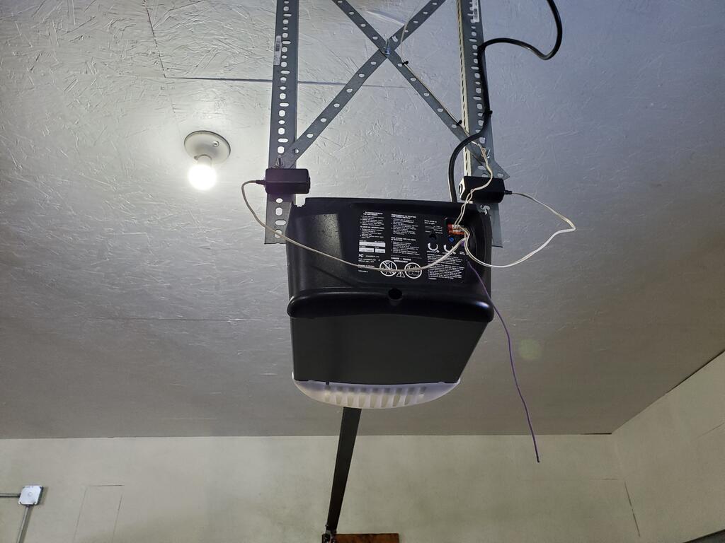

stevasaurus 23,857 #14 Posted January 29, 2021 I've got mine up in the garage rafters facing each other...works great!!! No little kids. BTW, did I ever tell you what I think about OSHA??? 5 Share this post Link to post Share on other sites
