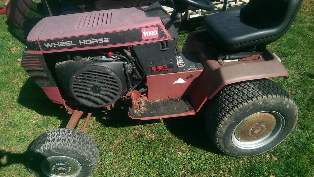

WVHillbilly520H 10,379 #26 Posted January 28, 2021 (edited) Yes the one I bought brand new has had a roof over it since the day I brought it home and moved 4 times, the other one not so lucky and it is older with less hours on the clock. 1st pic '95 I bought used, 2cd the "new" Anniversary model. Edited January 30, 2021 by WVHillbilly520H 1 1 Share this post Link to post Share on other sites

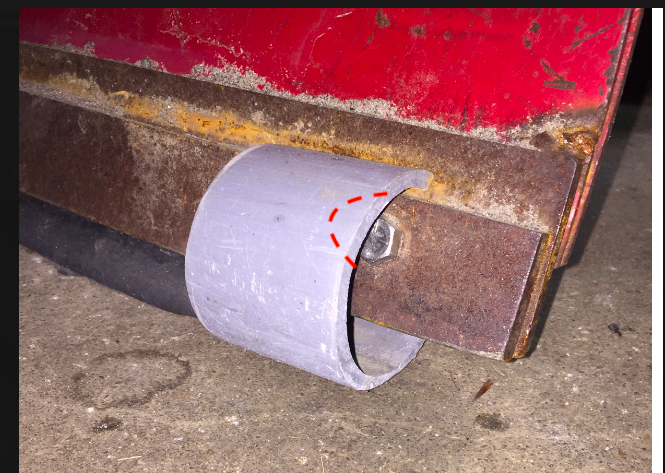

Chestnut 315 #27 Posted January 28, 2021 Back to the original post and those little slip on PVC pipe skids. If they work and the only issue is sliding off occasionally, how about using that outboard bolt that holds the steel scraper bar in place. Notch out the PVC pipe for a little clearance. Then either reverse that bolt so it runs from the backside to front and use a coupling nut instead of a regular nut to hold that bar in place. Then you could run another bolt into the coupling nut, long enough to keep the PVC pipe in place. The off the shelf coupling nuts may be too long and interfere with sliding the PVC on. Could cut them to size, or alternatively leave things just as they are and weld a regular nut onto that bolt head. Remove when a new piece of pipe needs to go on. Hope the description makes sense. I may be the only person in the world unable to draw more than a simple line on a Mac. 1 Share this post Link to post Share on other sites

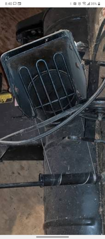

WVHillbilly520H 10,379 #29 Posted January 29, 2021 @Jeff-C175 here's another brand's snow chute stone deflector. Share this post Link to post Share on other sites
Jeff-C175 7,211 #30 Posted January 29, 2021 2 hours ago, Chestnut said: use a coupling nut That's a pretty darn good idea! That PVC wraps all the way around the back, and there's enough thread hanging out of the nut to screw a coupler onto. Then, a hole through the PVC and another bolt bottomed out in the coupler and tightened. Maybe I'll try that this weekend. With any luck the coupler will be long enough that I can cut it in half and make TWO! Share this post Link to post Share on other sites
Jeff-C175 7,211 #31 Posted January 29, 2021 13 minutes ago, WVHillbilly520H said: snow chute stone deflector. I had to look at it for a few seconds to get my mind off the idea that we were looking at a heating element inside an electric oven! Is that thing spring loaded? what happens when the rocks build up behind it, if it's not... 1 Share this post Link to post Share on other sites
WVHillbilly520H 10,379 #32 Posted January 29, 2021 1 minute ago, Jeff-C175 said: I had to look at it for a few seconds to get my mind off the idea that we were looking at a heating element inside an electric oven! Is that thing spring loaded? what happens when the rocks build up behind it, if it's not... Spring loaded not so much, its wire .(120" dia) or so that has 90° bends on each side that go through the chute, you squeeze them in to install/remove, it may have a bit of fore/aft movement the top stop is the chute and the bottom stop (hiding behind the belt) is the chute ring. Share this post Link to post Share on other sites
Jeff-C175 7,211 #33 Posted January 29, 2021 (edited) So it 'snaps' in at the red circles and pivots at the blue circles? The cable that can be seen in the other photo, That controls the discharge chute angle? Edited January 29, 2021 by Jeff-C175 Share this post Link to post Share on other sites
Jeff-C175 7,211 #34 Posted January 29, 2021 Weather reports that winter storm "Oreo" (sp!) is on it's way. They're saying possible 12-18" so I might get a chance to see how my toys play! 1 Share this post Link to post Share on other sites
ebinmaine 80,949 #35 Posted January 29, 2021 5 minutes ago, Jeff-C175 said: So it 'snaps' in at the red circles and pivots at the blue circles? The cable that can be seen in the other photo, That controls the discharge chute angle? I've had those guards in a couple of walk behinds. On the ones I had they only attach at the pivot point. Nowhere else. I removed them. My yard is gravel with no hard surface anywhere and I learned a long time ago never to point the snow blower anywhere near something I care about damaging. I found if the snow had any sort of moisture content to it that those guards were getting clogged, often. Share this post Link to post Share on other sites
Jeff-C175 7,211 #36 Posted January 29, 2021 2 minutes ago, ebinmaine said: if the snow had any sort of moisture content Not only the guard I bet! The last (and only so far) snow we've had here in Joisey stopped the walk behind cold after about 5' of travel. COMPLETELY packed in the chute. I gave up right quick, knew not to fight with it. I hope the rubber 'wipers' I bolted onto the 2nd stage impellers help with that, but I don't really have high hopes. We shall see! This upcoming snow should be dry though. It was 18° here this morning so ground should be frozen and the snow dry. 2 Share this post Link to post Share on other sites
WVHillbilly520H 10,379 #37 Posted January 29, 2021 (edited) 1 hour ago, Jeff-C175 said: So it 'snaps' in at the red circles and pivots at the blue circles? The cable that can be seen in the other photo, That controls the discharge chute angle? No blue circles mounting points, red circles is where the stop against the chute at its uppermost part, the lower most part stops against the "ring" hiding under the belt, (not my machine or picture) just trying to depict what could possibly be a stone deflector in some manufacturers eyes. Edited January 29, 2021 by WVHillbilly520H 1 Share this post Link to post Share on other sites

Handy Don 17,563 #39 Posted January 29, 2021 1 hour ago, WVHillbilly520H said: No blue circles mounting points, red circles is where the stop against the chute at its uppermost part, the lower most part stops against the "ring" hiding under the belt, (not my machine or picture) just trying to depict what could possibly a stone deflector in same manufacturers eyes. I always thought the one in my Ariens was more to take some of the energy out of the flying stone than to try to trap it. These may be akin to "lawyer lips" on the front forks of bicycles sold with quick releases--a legal defense more than an engineering solution. Share this post Link to post Share on other sites
WVHillbilly520H 10,379 #40 Posted January 29, 2021 10 minutes ago, Handy Don said: I always thought the one in my Ariens was more to take some of the energy out of the flying stone exactly "stone deflector" (removal of energy by deflecting) not entrapping.. I believe it even says in one of my WH snowthrower/blower manuals "wire stone deflector"... Share this post Link to post Share on other sites
Handy Don 17,563 #41 Posted January 29, 2021 1 minute ago, WVHillbilly520H said: exactly "stone deflector" (removal of energy by deflecting) not entrapping.. I believe it even says in one of my WH snowthrower/blower manuals "wire stone deflector"... I must add that when I ran into the plastic-wrapped and rolled newspaper buried under the snow, well, that wasn't pretty. Funny, yes; pretty, no. 3 Share this post Link to post Share on other sites
Chestnut 315 #42 Posted January 29, 2021 17 hours ago, Jeff-C175 said: That's a pretty darn good idea! That PVC wraps all the way around the back, and there's enough thread hanging out of the nut to screw a coupler onto. Glad you thought so! I didn't think about the backside too much because the photo was front. With threads already there it makes it even easier. If it works well it could be that rare trifecta - fast, cheap, good. 1 1 Share this post Link to post Share on other sites
Jeff-C175 7,211 #43 Posted January 30, 2021 4 hours ago, Chestnut said: Glad you thought so! I didn't think about the backside too much because the photo was front. With threads already there it makes it even easier. If it works well it could be that rare trifecta - fast, cheap, good. If the coupler is long enough I could drill a clearance hole for it in the backside of the PVC and I could just thread it on to the existing threads and not even need a nut. It only has to keep it from sliding sideways. I hope I can get that done tomorrow before the blizzard hits on Sunday. IF it hits, they still aren't sure. We're gonna get something, how much is the question. And now my wife's newly repaired car that was running so darn well for 5 days has developed a cylinder 5 misfire. Bad enough so that the that the SERVICE ENGINE light was flashing, which means possible Cat Con damage if driven. I hope I can get the garage at least warm enough to look at that and hopefully get her back on the road. I'm thinking a clogged injector, I should have replaced them when I had it apart. It MIGHT be a stripped out rocker bolt ... but it started running better after about ten minutes and I took it out for a 'blow out' tuneup and no rocker arms came through the valve cover at 6000 RPM so maybe that's OK. Injectors can be intermittent, stripped out rocker bolts can't... I pray. It still sucks I have to take it apart again and spend more money though. Share this post Link to post Share on other sites
