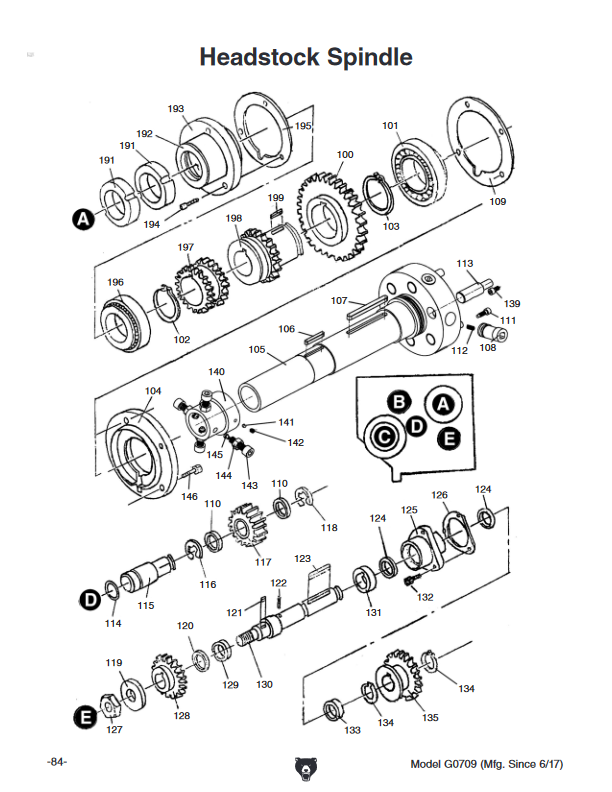

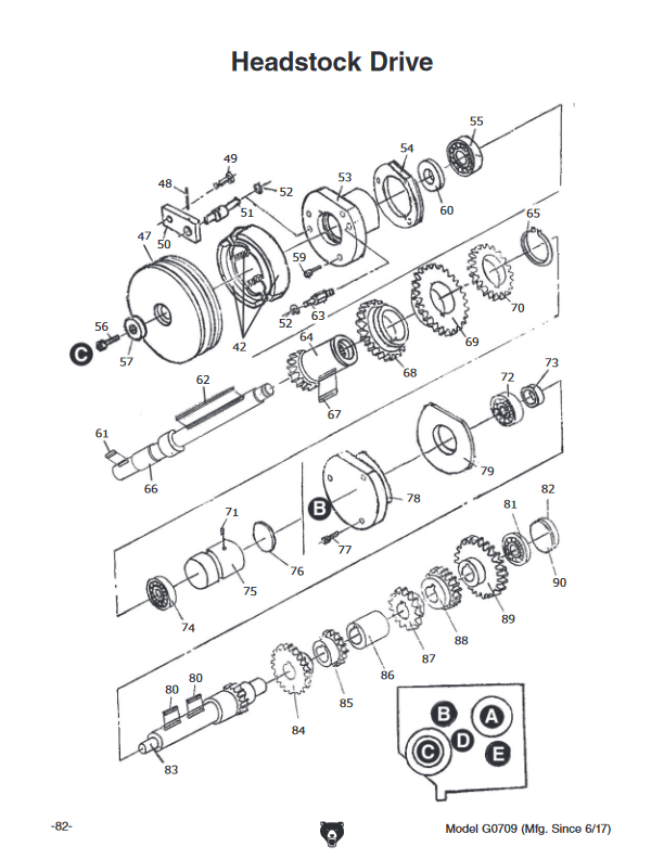

bc.gold 3,406 #1 Posted January 27, 2021 (edited) My personal experience. The bed casting, examine it for large voids filled with body filler then painted over, the tail-stock quill has a long key slot a very small pin keeps the quill from turning use a large drill this pin is prone to breaking. The foot brake serves several functions, if you tap the brake this disconnects the lathe from power, second the brake is intended to stop the chuck, now that large chuck has a lot of kinetic energy stored. if for some reason you need to apply a panic or emergency stop. The key on shaft part number 66 will try to shear itself, once this happens the entire head stock will over time self destruct. The gears no longer properly mesh and the head stock begins to emit strange noises. A lube change will show metal. Warranty is not worth the paper it's printed on, I had sent a video with full sound to the rep, this went ignored until I publicly posted the same video then sent another link to the rep. After the video became public they sent me every gear, bearings, shaft and thrust washer to do the repair. Soon after I sold the lathe. Buy an old American or English manufactured lather. Edited January 27, 2021 by bcgold Share this post Link to post Share on other sites

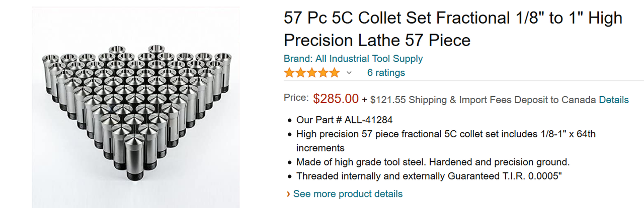

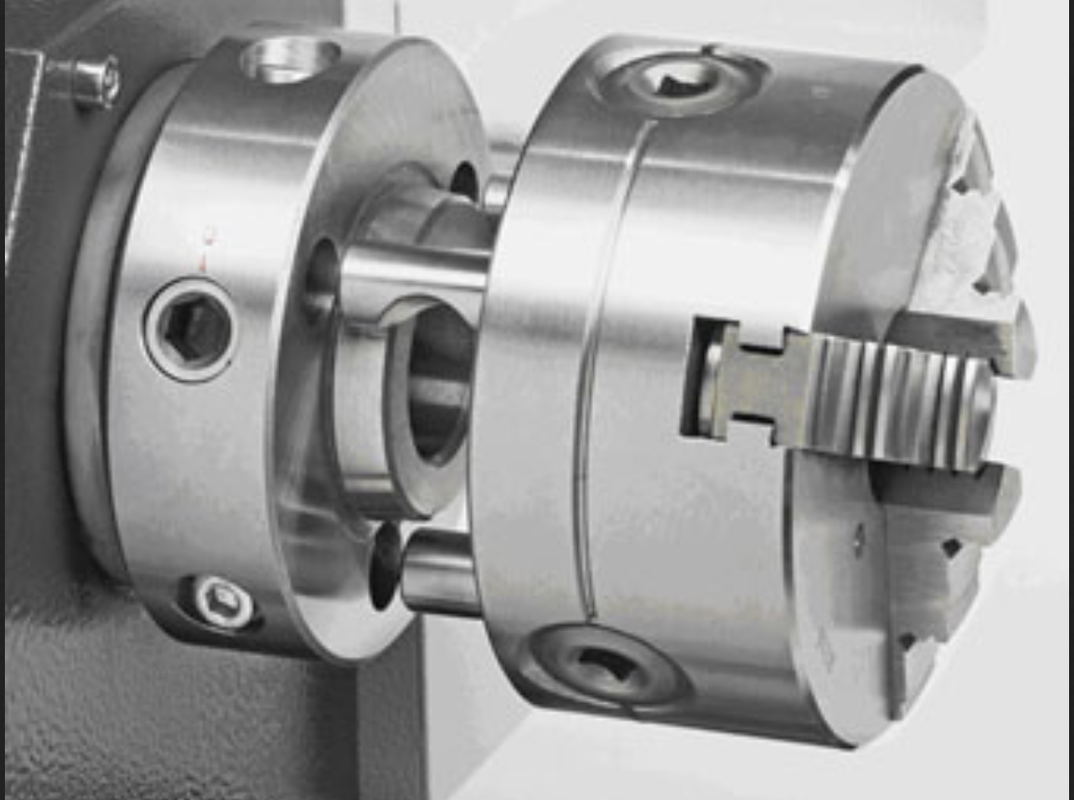

bc.gold 3,406 #6 Posted January 28, 2021 Not every lathe use the cam lock system which allows reversing chuck rotation without having to chase after a chuck rolling across the shop floor. Most modern lathes will accept collet's 1 Share this post Link to post Share on other sites
WVHillbilly520H 10,379 #7 Posted January 28, 2021 The old Leblond lathes I used had spanner lock ring/nuts and when tightened properly had issues with reverse rotation, most were 10-12" chucks with 2 18". Share this post Link to post Share on other sites
