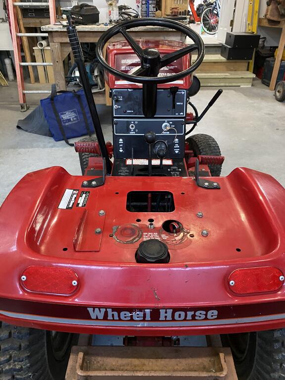

BeninCT 451 #1 Posted January 13, 2021 1. Is there an exact replacement LED light for these rear reflectors? I live on a busy road and might prefer lights over them. 2. tractor has standard round sealed beam glass headlights- is there an LED bulb that is the accepted substitute? 3. thinking of some tiny running lights on the tractor and have seen some that are LED and fit in 5/16” holes of which there are a few on my frame so might be a fun add without drilling. Anyone done anything like this? 2 1 Share this post Link to post Share on other sites

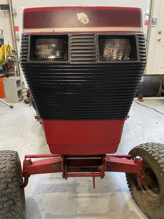

Goofey 89 #4 Posted January 13, 2021 Napa has the rear leds. Junglesite has the fronts. 1 Share this post Link to post Share on other sites

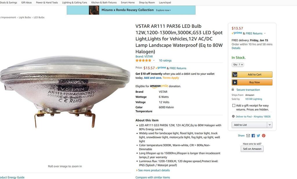

ebinmaine 80,765 #6 Posted January 13, 2021 7 minutes ago, Goofey said: fronts Is that the ones that are .. PAR 36? 1 Share this post Link to post Share on other sites

Goofey 89 #9 Posted January 13, 2021 24 minutes ago, ebinmaine said: Is that the ones that are .. PAR 36? yes :-) 1 Share this post Link to post Share on other sites

peter lena 10,076 #12 Posted January 13, 2021 BEN got mine at walmart , BLAZER BRAND,# C12544R, EASY TO DRILL OT THE POP RIVIT BASE, AND REMOUNT THE NEW LIGHTS. have them on all three of my horses , also added grounding points to all related areas , I too have a road side traffic issue , the lights help out , pete 2 Share this post Link to post Share on other sites
gwest_ca-(File Mod) 12,489 #13 Posted January 13, 2021 PAR 36 Parabolic Aluminized Reflector 36 eighths of an inch = 4.5" diameter 3 Share this post Link to post Share on other sites
Goofey 89 #14 Posted January 13, 2021 (edited) Yes the par36 is the factory bulbs. So yes. Direct replacement. Edited January 13, 2021 by Goofey 1 Share this post Link to post Share on other sites

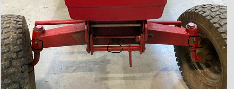

BeninCT 451 #16 Posted January 13, 2021 (edited) @ebinmaine i wont operate on the road just end up out near it and occasionally crossing to a neighbor so would like more light (plus its a fun little add) @Maxwell-8 perfect just have to see about an LED bulb. Looks like those will be exact replacements for my reflectors to lessen the crime against the tractor also I did grease all that but cleaned off the squeeze out! That kind of crazy here. Hot topic I guess. Was thinking of some small lights like this because they actually fit in a 6mm hole (1/4”) of which there are few on my frame. Also want to put a red light up under the hood so there is a red glow over the engine when running. Just to fit in with the kids up the road https://www.amazon.com/BRIGHTEST-Light-Bolt-Interior-Motorcycle/dp/B01AFU4QBS/ref=sr_1_2_sspa?crid=2CJN9OGUVHB6Q&dchild=1&keywords=small%2Bwaterproof%2Bled%2Blights%2Bsubmersible%2B12%2Bvolt&qid=1610575408&sprefix=small%2B12%2Bvolt%2Bled%2Blights%2Bwater%2Caps%2C204&sr=8-2-spons&smid=A6XWG1D8Q4A4V&spLa=ZW5jcnlwdGVkUXVhbGlmaWVyPUExTlVWR0ZTNTVRVEM5JmVuY3J5cHRlZElkPUEwNjY2NjUxMzE3RlhUTElBUFo3ViZlbmNyeXB0ZWRBZElkPUEwOTUxNTkxMkNKRE02MFZaQkE3NCZ3aWRnZXROYW1lPXNwX2F0ZiZhY3Rpb249Y2xpY2tSZWRpcmVjdCZkb05vdExvZ0NsaWNrPXRydWU&th=1 Edited January 13, 2021 by BeninCT 2 Share this post Link to post Share on other sites

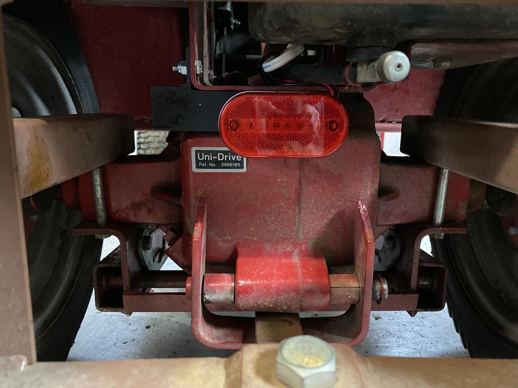

BeninCT 451 #25 Posted January 18, 2021 (edited) Ended up making a bracket instead b/c the amazon lights I go were too small to cover the factory reflectors and I decided to just leave them and have both. Had to do something in the garage on Saturday... Also @pfrederiI put those same LED headlights on and had to wire all the lighting straight from the hot post on the solenoid to eliminate the flicker but they all look great. Thx Edited January 18, 2021 by BeninCT 1 Share this post Link to post Share on other sites
