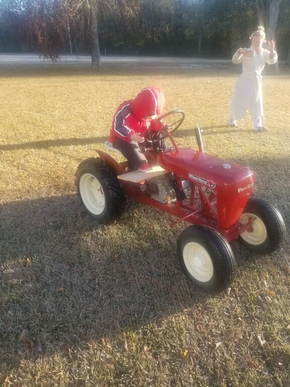

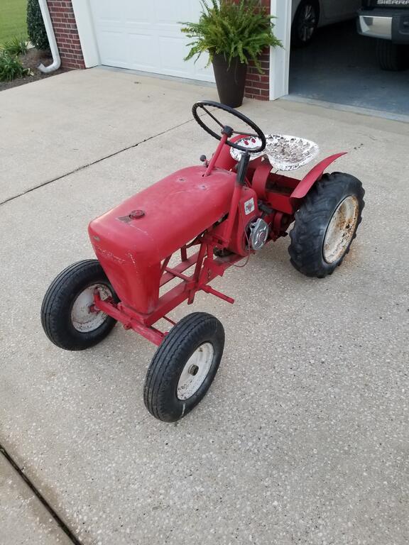

cmt123 23 #1 Posted December 27, 2020 Hello, I had never heard of Wheel Horse until October when I saw an RJ58 on eBay. I have a 3.5 year old that loves tractors, so on October 20th I purchased the tractor for Santa Clause to deliver. I was not able to pick it up until October 30th because I had to drive 3.5 hours one way to Fastenal in Enterprise, AL. I wasn't able to study the tractor until November 1st because I had damage from hurricane Zeta. What I found was a total piece of junk that the seller lied about, misrepresented, or failed to mention certain things wrong. I have attached pictures of before and after. It took 5 weeks to get the tractor in working order and presentable. I will continue to look for the correct parts and re-do the tractor when I have all of the parts. 4 4 2 Share this post Link to post Share on other sites
troutbum70 858 #2 Posted December 27, 2020 The after looks very good, appears that you done an engine swap. Was the original engine not running? 1 Share this post Link to post Share on other sites
Jeff-C175 7,207 #3 Posted December 27, 2020 I hope that you intend to get the old engine running and replace it onto the tractor! VERY nice job, and a heckuva Dad too! Your son is a very lucky boy! 1 Share this post Link to post Share on other sites
rjg854 12,862 #4 Posted December 27, 2020 @cmt123 looks good. Hope you can get the engine running and reinstalled. It would be well worth it to keep it original if at all possible. But it is your tractor and you might as well have it, the way you want it. 1 Share this post Link to post Share on other sites

cmt123 23 #6 Posted December 27, 2020 Thank you for the compliments. I very much so intend on replacing the harbor freight motor with either a Clinton or. Kohler engine. The Clinton engine that was on it was a Model 498 not a B1290. This is an early RJ58 with no casting date on the transmission; the serial number is 05714. The tractor had been rolled so I replaced all of the upright support and beat on the hood with a dolly and hammer for about 12 hours to get the major bow and twist out of it. None of the steering components were correct, the gas tank is not correct, the gears in the transmission are in really bad bad shape.. there were a lot of things wrong but it is a nice looking tractor now and it runs. The seller even took the lift cable off and repost it for sale. Parts are hard to come by here on the Mississippi Coast so it will take some time to find them. 1 Share this post Link to post Share on other sites

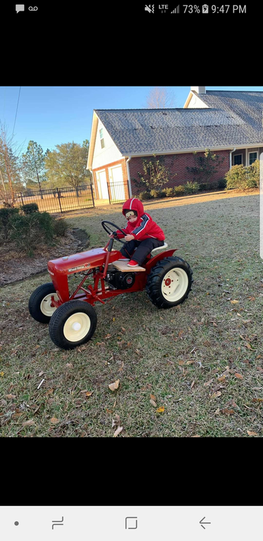

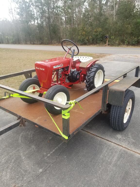

cmt123 23 #10 Posted December 27, 2020 Thanks, wallfish! I did buy a lift cable from them. I should probably post detailed pictures of the tractor and a list of things I know that are incorrect. Here are a few more until I can take better pictures. 6 2 Share this post Link to post Share on other sites

oliver2-44 11,272 #13 Posted December 27, 2020 Getting to be a very nice tractor. One thing to add to your todo list is add some weight to the front end such as filling the front tires or a front weight. Those RJ's are very light on the front end . If you or he pop the clutch a little you can easily be looking at the sky. 1 Share this post Link to post Share on other sites
cmt123 23 #14 Posted December 27, 2020 @oliver2-44 Santa Clause found that out first-hand and filled the front tires with water. But thx for the tip! 1 Share this post Link to post Share on other sites

cmt123 23 #22 Posted December 28, 2020 (edited) Thanks! @stevasaurus I need: front wheels, exhaust heat shield, correct engine complete with shroud and air cleaner, correct gas tank, engine pulley, lift cable hold down tab (or the dimensions of an original), BFG rear AG tires and every gear in the transmission. I know that's that's a pretty good wish list, but that's what I need for a "correct" restoration. Once I have the parts I will break it back down, sandblast it again and this time it will be sprayed with automotive paint. @Lane Ranger Edited December 28, 2020 by cmt123 forgot to tag a member 1 Share this post Link to post Share on other sites
