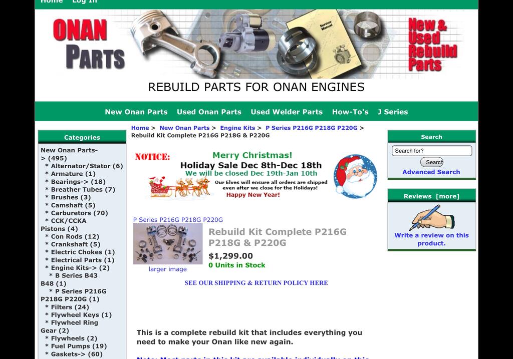

richmondred01 2,319 #14 Posted December 21, 2020 (edited) 6 minutes ago, onanparts.com said: For the past 20 years, yup! looks like 1299.00. Does the “Christmas sale” take it down to the 800.00? And does that sale include shipping? If so that’s great savings of $500.00. If I was still “rebuilding/overhauling” onans I would definitely be at your door. Edited December 21, 2020 by richmondred01 Share this post Link to post Share on other sites
richmondred01 2,319 #15 Posted December 21, 2020 Well Tom that’s a real good price that onan parts man has. A complete kit that according to his website includes: Rebuild Kit includes: Two Pistons with Rings & Wrist Pins: Two Con Rods: Two Main Bearings: Two Cam Bearings: Two Intake Valves: Two Exhaust Valves: Two Intake Guides: Two Exhaust Guides: Four Valve Springs: Four Valve Caps: One Rebuilt Oil Pump: New pump no longer available. One Oil By-Pass Spring: One 168-0187 Gasket & Seal Kit: All for $800.00. You really are going to find it hard to beat that price. I can’t remember when onan parts were that cheap. I was guessing 1200.00. You should jump on that deal. Share this post Link to post Share on other sites

richmondred01 2,319 #18 Posted December 21, 2020 I can’t find a telephone number on your website. I would like to call and order that full rebuild kit .010 over on pistons and .010 under on rod that you are selling for 800.00 For that price I’ll keep it on the shelf in case I ever do another. please forward telephone number either on the board or via PM. 1 Share this post Link to post Share on other sites

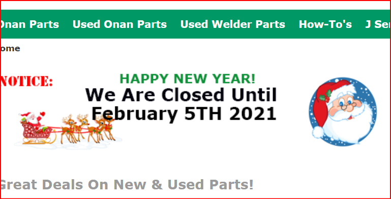

R Scheer 507 #20 Posted December 22, 2020 Their website says closed Dec 19 to Jan 10. Share this post Link to post Share on other sites
WHX?? 53,365 #21 Posted January 8, 2021 Now it says closed till Feb?? Looking to refresh an Onan myself. Share this post Link to post Share on other sites
