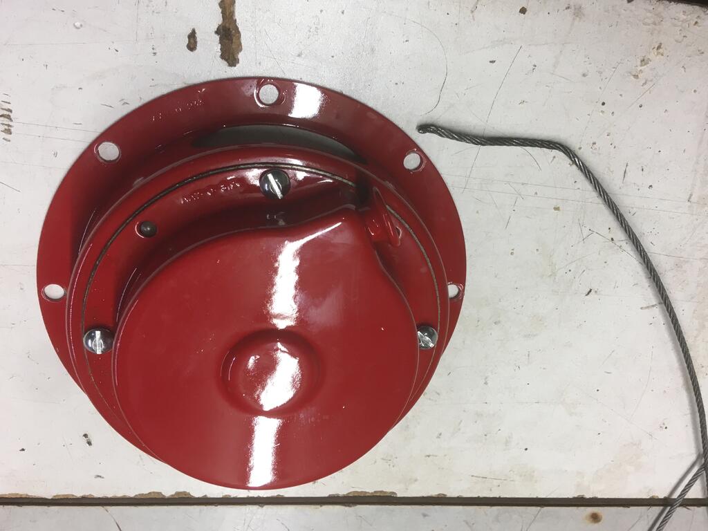

formariz 12,381 #1 Posted December 20, 2020 (edited) So today while attempting to start the grindstone engine due to my negligence by pulling it out to the end, obviously what was at the end of cable came out. Luckily there are a few of these here so I just switched to another new one. Never had one of these apart. Is this an easy fix or do I need a new cable? Edited December 20, 2020 by formariz 1 Share this post Link to post Share on other sites
Maxwell-8 4,371 #2 Posted December 20, 2020 (edited) 5 hours ago, formariz said: So today while attempting to start the grindstone engine due to my negligence by pulling it out to the end, obviously what was at the end of cable came out. Luckily there are a few of these here so I just switched to another new one. Never had one of these apart. Is this an easy fix or do I need a new cable? It's a easy fix, you can reuse the cable. plenty video's on youtube how to do it. Just to safe you from headaches, try and do it without unscrewing the recoilsystem. A video of Steve: He can explain it in human language! Edited December 20, 2020 by Maxwell-8 2 Share this post Link to post Share on other sites
