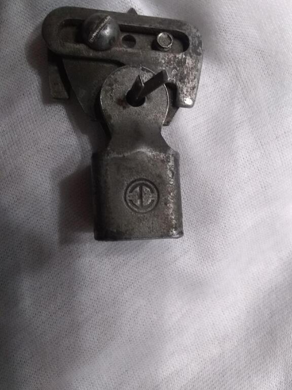

Jeff-C175 7,209 #54 Posted December 20, 2020 I wonder if it's some sort of adjustable spanner wrench? (with the plates turned around so the 'tangs' stick out) 1 Share this post Link to post Share on other sites

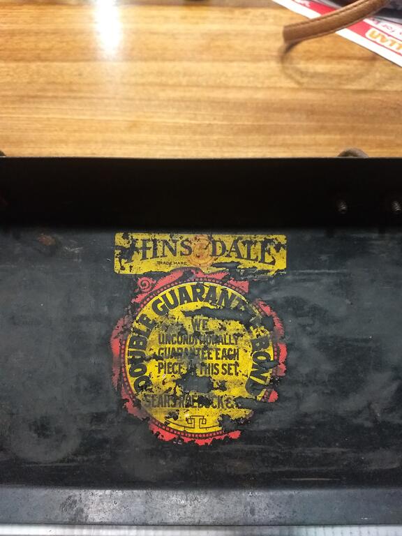

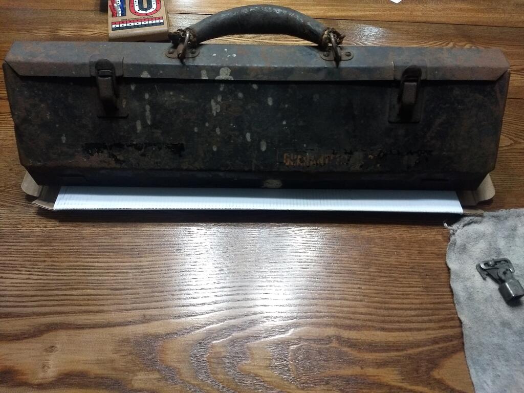

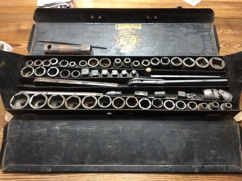

ebinmaine 79,296 #55 Posted December 20, 2020 So guys here's the tool box that piece was/is in.... I took a few minutes to completely empty it and organize by size and type. It looks at or near complete. Close-up of the decal outside Decal inside the lid. The post organizing layout. 2 2 Share this post Link to post Share on other sites
DennisThornton 4,773 #56 Posted December 21, 2020 Certainly appears that something square goes into it but what? Wooden handle?Then what? Are there other parts missing? Is it even a tool? Or just a part of something? I don't foresee an answer coming from me... Share this post Link to post Share on other sites
ebinmaine 79,296 #57 Posted December 21, 2020 15 minutes ago, DennisThornton said: Certainly appears that something square goes into it but what? Wooden handle?Then what? Are there other parts missing? Is it even a tool? Or just a part of something? I don't foresee an answer coming from me... I believe that the square end goes on to one of the adapters in the kit. There are both 4 and 6 sided handles in the above toolbox. @Stepney you'd like this set. Share this post Link to post Share on other sites

DennisThornton 4,773 #60 Posted December 21, 2020 24 minutes ago, ebinmaine said: I believe that the square end goes on to one of the adapters in the kit. There are both 4 and 6 sided handles in the above toolbox. @Stepney you'd like this set. 4 sided thin walled with floppy cotter pin connected to what! I see no connection to the socket set. I give. 1 Share this post Link to post Share on other sites
ebinmaine 79,296 #61 Posted December 21, 2020 14 minutes ago, elcamino/wheelhorse said: I bet to a tool collector , that set would have value. @ebinmaine have you checked flea bay or internet for old tool sets. You may get your answer. Briefly. I was only able to find in several places that it's called a VALVE GRINDER ATTACHMENT. But to grind what valves I don't know. Share this post Link to post Share on other sites
SylvanLakeWH 31,609 #62 Posted December 21, 2020 Just now, ebinmaine said: Briefly. I was only able to find in several places that it's called a VALVE GRINDER ATTACHMENT. But to grind what valves I don't know. I’m sending my trophy back... (But not the snow)... 2 Share this post Link to post Share on other sites
ebinmaine 79,296 #63 Posted December 21, 2020 2 minutes ago, SylvanLakeWH said: I’m sending my trophy back... (But not the snow)... How bout if I send more snow just to help you feel better? 1 1 Share this post Link to post Share on other sites
Stepney 2,357 #64 Posted December 21, 2020 (edited) The valves on a T engine have notches in the top, they were never in the same place twice. Just a hunch, the part with the notches is upside down. Flip it so they point down. Then the square and pin at the top went into basically an old fashioned eggbeater drill. It was for turning the valve under load in its seat. I helped do valves on a T truck in Florida when I was little and vaguely remember the tool. Im not sure what it would have to do with the T jack.. I have three different factory T jacks, and none had anything but a ratchet or a crank. Henry would never include an intricate little piece.. heck one of the timing cover bolts on the A is also the tool to set the ignition timing Clearly not the same, but I think its somewhat similar to this? In this case.. use the ratchet, and the double ended square bit. Couple the square into the ratchet, flip the tabs over, and set them to fit the valve. The little tab in the middle would center it.. I cant find another tool like that online but vaguely remember working with it. Edited December 21, 2020 by Stepney 3 Share this post Link to post Share on other sites

Handy Don 16,784 #71 Posted December 21, 2020 11 hours ago, Stepney said: The valves on a T engine have notches in the top, they were never in the same place twice. Just a hunch, the part with the notches is upside down. Flip it so they point down. Then the square and pin at the top went into basically an old fashioned eggbeater drill. It was for turning the valve under load in its seat. I helped do valves on a T truck in Florida when I was little and vaguely remember the tool. This makes a lot of sense to me, thanks @Stepney and it's the kind of job a mechanic of the era would have to be prepared to do so including it in the kit makes sense as well. With some rubbing compound, one could lap valves with only minor issues right in place and not have to disassemble the engine. We also have to keep in mind the limits of metallurgy in that era at those low, Model T price points. 1 Share this post Link to post Share on other sites
Stepney 2,357 #72 Posted December 21, 2020 1 hour ago, Handy Don said: This makes a lot of sense to me, thanks @Stepney and it's the kind of job a mechanic of the era would have to be prepared to do so including it in the kit makes sense as well. With some rubbing compound, one could lap valves with only minor issues right in place and not have to disassemble the engine. We also have to keep in mind the limits of metallurgy in that era at those low, Model T price points. The poor oil and fuel was horrible about carbon, and the inexperienced T driver would often run the engine with the timing way off .. since you set it right from the steering column on a lever. They coked up valves all the time and only would need a quick turn to get them seated *enough to 'run' again. 1 1 1 Share this post Link to post Share on other sites
