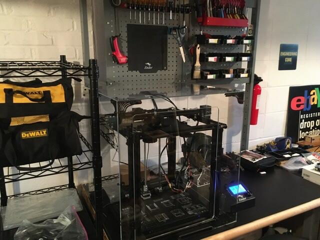

tom2p 2,394 #3 Posted December 14, 2020 (edited) 15 minutes ago, tom2p said: My kid (youngest) has a 3D printer He has a Creality Ender 5 Pro He uses Solid Works software If he had to do it again - he would purchase the Prusa ... he said the Prusa is a top quality printer He modified and upgraded the Creality Ender 5 Pro significantly - with some of the upgrades including parts and attachments he designed and printed with the printer Some of the upgrades : Upgraded “hotend” to mosquito hotend by slice engineering to print high temperature plastics Re-designed printhead for use with mosquito hotend in a “bowden” tube configuration for use with a “BL-Touch” (auto-bed leveling probe) as well as a 4040 Fan duct for part cooling E3D V6 plated copper nozzle w/ .4mm inner diameter Upgraded heated bed to a silicone heater (same dimensions as stock) Upgraded build plate to machined 6000 series aluminum, as well as a “whambam” magnetic base. (permits use of magnetic build plate with a spring steel base ; spring steel plate with a PEI coating over tradition glass Installed thrust bearing for the z-axis Reflashed firmware with modified version Upgraded power supply to official Meanwell 350W 24V, so all external devices (parts cooling fan, hotend fan, enclosure fan, enclosure temp sensor, and raspberry pi) can be run off of the printers power supply using two 3A buck converters to step-down the voltage to be usable Setup raspberry pi to so the printer can run remotely off of “octoprint” to be monitored while printing via camera (files can be uploaded and commands can be sent to the printer remotely as well) External touchscreen to control octoprint interface Added acrylic enclosure with LED lights and temperature sensor ; lights are powered by a separate mean well 12V power supply (to reduce load from printer’s psu) Edited December 14, 2020 by tom2p 1 Share this post Link to post Share on other sites

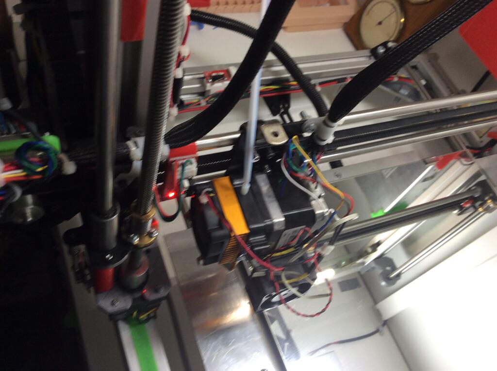

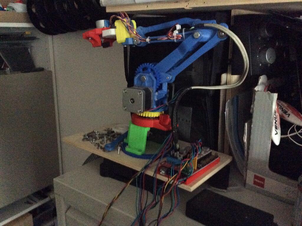

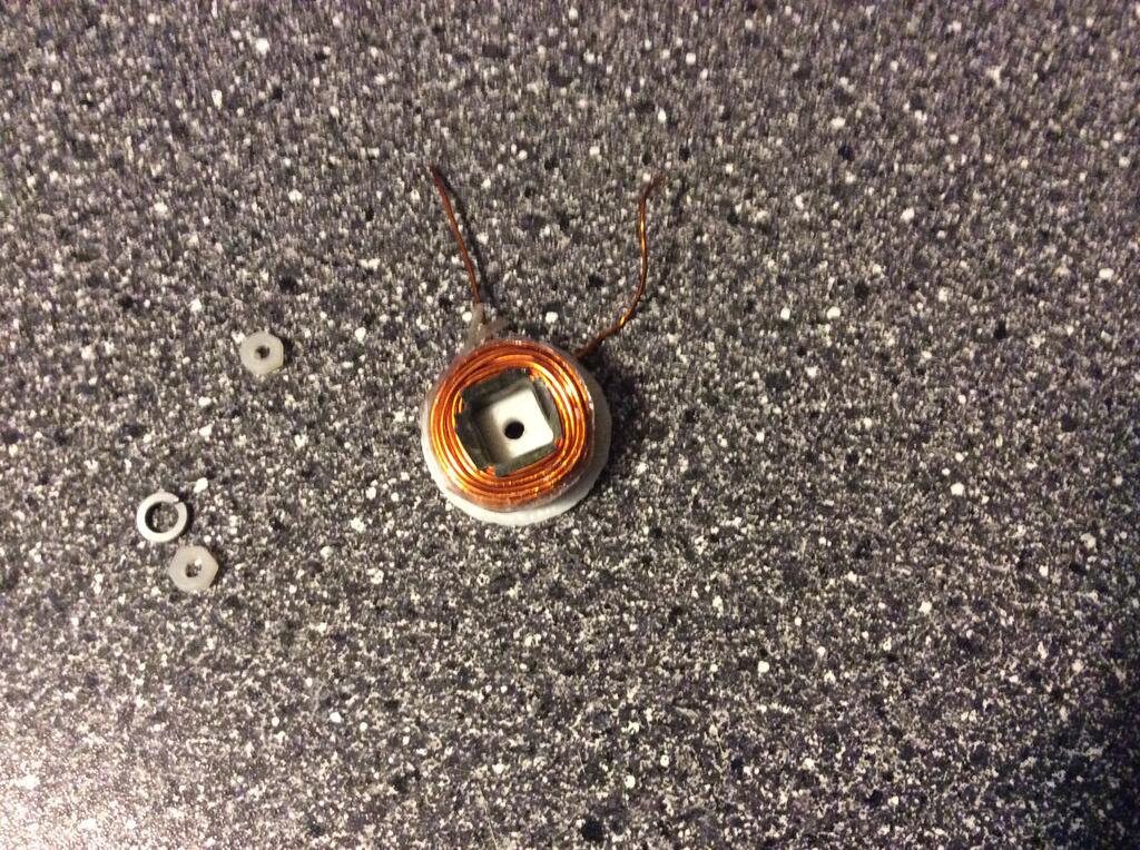

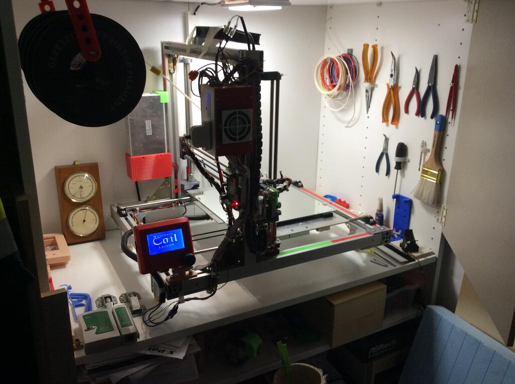

Tractorhead 9,215 #16 Posted December 14, 2020 Use Rhino 3D for Painting and sketching and Repetier Host with Cura Engine for slicing on my selfmade „Prusa type“ Printer for Printing. Rhino, because i like it and i know difference between painted parts and reality on repetier is exact 0.76 correct. Factor. That Factor i had fixed implemented in Repetier Host what means all i draw is printed 1:1. Before i tried Google sketchup, but the correctur factor differs on each slicing process. As Firmware i use Marlin with lot‘s of changes. Max dimension is 380x380 x280mm i can use, but mirrorplate restricts them to 300 by 300mm and most parts are mostly smaller. Lots of 3 D printed Parts in my Prusa, all are made of PLA. This Printer still works now since 2 Years without any thermal Problems or troubles. Sometimes 3 or 4 Day‘s jobs are still done without problems. Printbed is a heated mirror, what sticks very great if preheated to 68 degC and PLA loosened itself at below 40 deg.C. So Parts can be picked without any force. I don‘t work with ABS or with higher temp material, because it‘s stinks too much and i use mine just for Rapid Prototyping things like Coil winders or i.eg. Quadcopters, they mostly had a very short lifetime on highspeed flights with video Googles thru forrest... 😎 The left one was a high speed test with 214 Km/h in result.... but it had just a lifetime of 5 min before it trashed on a Tree, what jumps to it quickly. 😂 I mostly print with high speed and lower quality, because i like fast results. I make several coils with different inner diameters different wires and different windings to find the perfect fit and the perfect windings on the Tecumseh H66 So i fixed or better rebuild my Charging Coil’s also for the 656 Wheelhorse to bring the Charging option back in Service. I use only PLA while in Rooms printing, because of nice Smell like a warm pancake and the lower Temps. When i had too much rests of PLA i make sometimes colormixing Toy‘s. Some things are out of thingiverse, some are self constructed, depending on. Most are Nice to look or great to play with. Some toy‘s are still in work, some are just a optical gadgets but the most works. Even my 3D Printer was 60% built by my first one, what is now retired. There are a lot of 3 D printers on the market, from cheap to high end and from Trash to „whow“ Machines. The Prusa is a good choice for starting, Joseph has improved his last machine much, so in my opinion it‘s a fantastic way to Start because you pay what you get or vice versa. A enclosure is highly recommended for each 3 D Printer to get quick better results without Warping and avoids dust from the Hardware. The biggest must in my experiences, is a well feeded Airstream in the enclosure for best results. Any free Airstream can trash your printresult very quick. 2 1 Share this post Link to post Share on other sites
