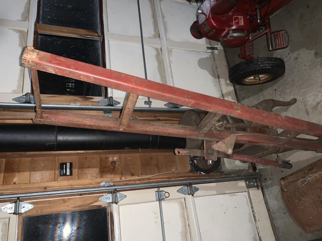

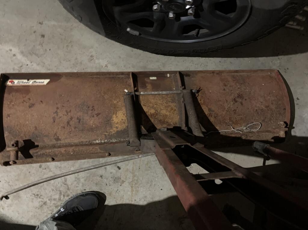

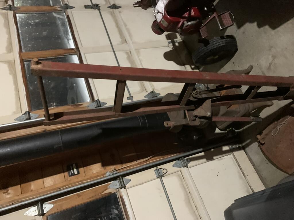

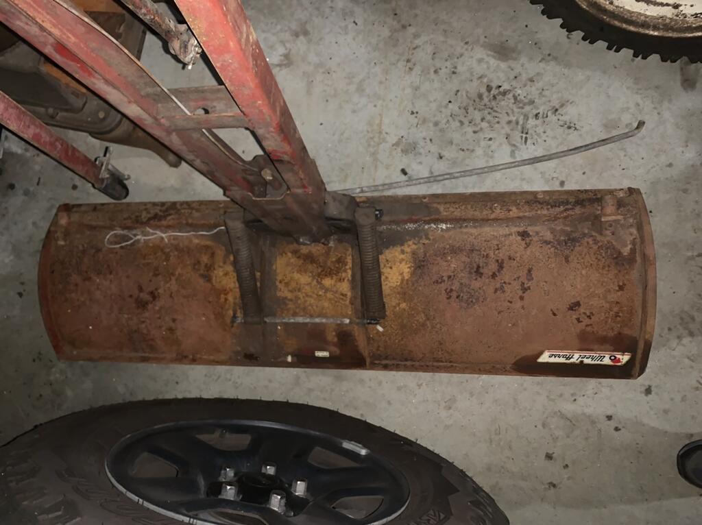

Crmaverick 91 #1 Posted December 11, 2020 I picked up a 54” plow today, it’s a early/mid 1960s A frame style. I thought it was a 42” when I went to look at it. I never knew they made an early A frame 54” not sure if this will fit my 753? Looks like the lift arm comes up in a different spot in relation to the rear mount. Any ideas what’s this go to or if it will work? Share this post Link to post Share on other sites
8ntruck 8,626 #2 Posted December 11, 2020 The interchange list in the Implements and Attachments section only list a 42" blade for a 753. That is not to say that the 54" blade can't be made to fit with some 'adjustments' (flame wrench, suicide wheel, big hammer, spark wand, etc.). Any idea what the blade was used on by the PO? Disclaimer - I don't own a dozer blade, and my Horse is newer than yours, so this is just an educated guess. Somebody how knows will probably be along soon. Good luck Share this post Link to post Share on other sites

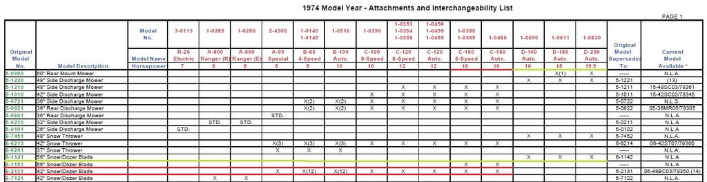

gwest_ca-(File Mod) 12,015 #3 Posted December 11, 2020 1 1 Share this post Link to post Share on other sites
ebinmaine 77,541 #4 Posted December 11, 2020 Garry's got you fixed right up there. Certainly isn't a common plow. Someone in the 953/1054 crowd would be pretty happy to have that. Share this post Link to post Share on other sites
gwest_ca-(File Mod) 12,015 #5 Posted December 11, 2020 You should verify that the A-frame is for a 953 or 1054 because the 54" blade will also fit the short tractor frame and long tractor frame A-frames. The only difference between the 42" blades and 54" blades is the width. Later on when the blades came in 2 packages as a basic unit and a completeing kit you ordered the blade and an A-frame kit to suit the application. 42" blade was standard and the 54" was an option for the 16hp tractors. Hopefully some one familiar with the 953 and 1054 blades can identify the A-frame you have. Garry 1 Share this post Link to post Share on other sites

gwest_ca-(File Mod) 12,015 #8 Posted December 11, 2020 I was wrong. The 54" blade shows up for the left over GT-14's in 1973. In 1974 the blade was increased to 56" and listed as an option for the 16hp models. Garry 1 Share this post Link to post Share on other sites

953 nut 64,332 #10 Posted December 11, 2020 8 hours ago, Crmaverick said: 54” not sure if this will fit my 753? Chances are the 54" snow/dozer blade would be a bit too much for a 753. You could adapt the lift point to work but the added width and length would be a bit hard to maneuver and with the blade at an angel it would tend to push the front of the 753 sideways. The 953/1054/GT-14 are longer and much heavier in the front than the 753. You may want to list it for trade for a 42" short frame unit. https://www.wheelhorseforum.com/classifieds/trade/ 1 Share this post Link to post Share on other sites
ebinmaine 77,541 #11 Posted December 11, 2020 54 minutes ago, gwest_ca said: I was wrong. The 54" blade shows up for the left over GT-14's in 1973. In 1974 the blade was increased to 56" and listed as an option for the 16hp models. Garry I'm still fairly new at this whole Wheelhorse game but I've never seen a C Series with a 56. Would that have been an option only on the D series? Share this post Link to post Share on other sites
Crmaverick 91 #12 Posted December 11, 2020 26 minutes ago, 953 nut said: Chances are the 54" snow/dozer blade would be a bit too much for a 753. You could adapt the lift point to work but the added width and length would be a bit hard to maneuver and with the blade at an angel it would tend to push the front of the 753 sideways. The 953/1054/GT-14 are longer and much heavier in the front than the 753. You may want to list it for trade for a 42" short frame unit. https://www.wheelhorseforum.com/classifieds/trade/ I would bolt the blade to the short frame plow frame to eliminate the longer length. Think front frame weights and aired down front tires would eliminate front end sliding? Share this post Link to post Share on other sites
ebinmaine 77,541 #13 Posted December 11, 2020 4 minutes ago, Crmaverick said: I would bolt the blade to the short frame plow frame to eliminate the longer length. Think front frame weights and aired down front tires would eliminate front end sliding? I have 110 lb of fluid weight on the front of the Cinnamon Horse and also a much larger engine with a 48-in plow and that will slide sideways if I push it much. Your best bet would be to get as much weight up there as you possibly can along with roller chains wrapped around the front tires so you have steel beams effectively doing the steering. Fluid filled tires. Front wheel weights if possible. A lot of weight hanging off the frame... With me sitting on it my tractor weighs over 1,350 lb and I occasionally wish it was heavier. Share this post Link to post Share on other sites
gwest_ca-(File Mod) 12,015 #14 Posted December 11, 2020 1974 1 Share this post Link to post Share on other sites
gwest_ca-(File Mod) 12,015 #15 Posted December 11, 2020 1973 1 Share this post Link to post Share on other sites
Crmaverick 91 #16 Posted December 11, 2020 3 hours ago, ebinmaine said: I have 110 lb of fluid weight on the front of the Cinnamon Horse and also a much larger engine with a 48-in plow and that will slide sideways if I push it much. Your best bet would be to get as much weight up there as you possibly can along with roller chains wrapped around the front tires so you have steel beams effectively doing the steering. Fluid filled tires. Front wheel weights if possible. A lot of weight hanging off the frame... With me sitting on it my tractor weighs over 1,350 lb and I occasionally wish it was heavier. Got the front wheel weights, I’d have to fab up a bracket to mount some front end weights to. I think I would also add 1/4 angle iron across my rear frame mount (across the four bolts that mount to the uni drive). That plate isn’t cracked at all but I would think that it would prevent it from cracking. I also read about some guys doing plow frame stabilizaters, to prevent sideway torsion 1 Share this post Link to post Share on other sites
ebinmaine 77,541 #17 Posted December 11, 2020 12 minutes ago, Crmaverick said: would also add 1/4 angle iron across my rear frame mount (across the four bolts that mount to the uni drive). That plate isn’t cracked at all but I would think that it would prevent it from cracking. I also read about some guys doing plow frame stabilizaters, to prevent sideway torsion Both of those are great ideas. I can't remember how to search for it but there's a thread that talks about reinforcing that rear frame area and I'll post it when I can find it if somebody else doesn't beat me to it. @pfrederi Paul and @WVHillbilly520H Jeff both have good ideas about front stabilizer setups. I'll be installing one on my Cinnamon Horse soon. Share this post Link to post Share on other sites

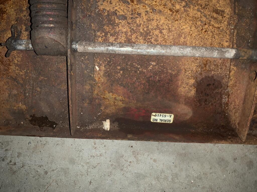

Crmaverick 91 #18 Posted December 11, 2020 2 hours ago, gwest_ca said: 1973 Is this plow I have from the 1960s? The serial number on mine is 65418 but I don’t see that listed in these 73 or 74 tables. Thanks Share this post Link to post Share on other sites
gwest_ca-(File Mod) 12,015 #19 Posted December 11, 2020 Your blade is from a 1964 model BD-543 dozer assembly identified by the A-65418 serial number. The A-frame is not necessarily from that assembly as I explained earlier. If it is it may be too wide for your tractor. You will not find the serial number listed anywhere but here because Wheel Horse never published serial numbers. That is why we record serials we see and how we have learned this one is a 1964 model even though the BD-543 model number was used for the 1963 to 1965 model years. Click on the picture in this link for more info The 1973-74 attachment lists were posted because someone commented on the wide blades being used on 16hp tractors and D-Series tractors including the large 1973 no-name models. 1 Share this post Link to post Share on other sites
Crmaverick 91 #20 Posted December 11, 2020 2 hours ago, gwest_ca said: Your blade is from a 1964 model BD-543 dozer assembly identified by the A-65418 serial number. The A-frame is not necessarily from that assembly as I explained earlier. If it is it may be too wide for your tractor. You will not find the serial number listed anywhere but here because Wheel Horse never published serial numbers. That is why we record serials we see and how we have learned this one is a 1964 model even though the BD-543 model number was used for the 1963 to 1965 model years. Click on the picture in this link for more info The 1973-74 attachment lists were posted because someone commented on the wide blades being used on 16hp tractors and D-Series tractors including the large 1973 no-name models. Good info, when did they stop making long A frame plows? The plow frame I have does look different than the one in that manual Share this post Link to post Share on other sites
gwest_ca-(File Mod) 12,015 #21 Posted December 11, 2020 Here is a list of the long frame plows. 953, 1054 and D-Series are often called large frames. I am quite sure your frame is 1968 or older because the frame is a full A-shape. The rear axle hitch for this frame mounts ahead of the rear axle. When the frame changed in 1968 they went to a frame that has about 2 feet of the rear rails parallel to each other. This rear hitch is mounted under the rear axle. Dozer DNA of long tractor frame dozer blades 1966-1967 model BD-426 - Fits LONG frame tractors - Mounts ahead of the rear axle - replaced by 1968 model 6-1111 - Fits LONG frame tractors - Mounts ahead of the rear axle ---------------------------------------------------------------------------------------------------------------------- 1968 model 6-4111 - First to fit LONG & SHORT frame tractors and first to mount under the rear axle with a loose A-frame crossbar - replaced by 1969 model [6-4112 + 6-9621] 1970-73 model [6-4113 + 6-9622] 1973-74 model [6-4113 + 6-9623] 1974 model [6-4114 + 6-9624] 1974 model 6-2131 1975 model 6-2132 1976 model 6-2133 1976 model 66-42BC01 1977 model 76-42BC01 1978 model 86-42BC01 1979 model 96-42BC01 1980 model 06-42BC01 - (Last blade to have a loose A-frame crossbar #7701) 1981-1984 model 06-42BC02 (Up to here including this one they are 42" wide) and (First blade to have a welded-in rear A-frame crossbar) 1984-1989 model 06-48BC01 (They are now 48" wide) - replaced by the following 1990 model 06-48BC02 (Last blade to have 3 angle positions) 1991-1993 model 06-48BC03 (First blade to have 5 angle positions) 1993-2001 model 79350 - (105-1502 kit adapts 2001 and older GT Classic-Series blades to fit 2002 and later tractors 2002 2004-2009 2012 model 79364 - (105-1501 kit adapts 79364 blade to fit 2001 and older GT Classic-Series) Share this post Link to post Share on other sites
Crmaverick 91 #22 Posted December 11, 2020 Thanks for all the info. I’m going to offer this frame up for trade for a 42” A frame plow set up, I’m going to keep this blade and see how it works mounted to a short frame. Anyone interested in a trade feel free to PM me Share this post Link to post Share on other sites
gwest_ca-(File Mod) 12,015 #23 Posted December 11, 2020 Here is what you are looking for. Any from 1962 and later will fit. Dozer DNA of short tractor frame dozer blades 1961 model BD-4271 - Fits SHORT frame tractors - Mounts ahead of the rear axle - replaced by 1962 model BD-4262 - Fits SHORT frame tractors - Mounts ahead of the rear axle 1963 model BD-4263 - Fits SHORT frame tractors - Mounts ahead of the rear axle 1964 model BD-4264 - Fits SHORT frame tractors - Mounts ahead of the rear axle 1965-1966 model BD-4264A - Fits SHORT frame tractors - Mounts ahead of the rear axle 1967 model BD-4267 - Fits SHORT frame tractors - Mounts ahead of the rear axle 1968 model 6-2111 - Fits SHORT frame tractors - Mounts ahead of the rear axle ----------------------------------------------------------------------------------------------------------------------------------- 1968 model 6-4111 - First to fit LONG & SHORT frame tractors and first to mount under the rear axle - replaced by 1969 model [6-4112 + 6-9621] 1970-73 model [6-4113 + 6-9622] 1973-74 model [6-4113 + 6-9623] 1974 model [6-4114 + 6-9624] 1974 model 6-2131 1975 model 6-2132 1976 model 6-2133 1976 model 66-42BC01 1977 model 76-42BC01 1978 model 86-42BC01 1979 model 96-42BC01 1980 model 06-42BC01 1981-1984 model 06-42BC02 (Up to here they are 42" wide) -------------------------------------------------------------------------------- 1984-1989 model 06-48BC01 (They are now 48" wide) 1990 model 06-48BC02 (Last blade to have 3 angle positions) 1991-1993 model 06-48BC03 (First blade to have 5 angle positions) 1993-2001 model 79350 - (105-1502 kit adapts 2001 and older GT Classic-Series blades to fit 2002 and later tractors 2002 2004-2009 2012 model 79364 - (105-1501 kit adapts 79364 blade to fit 2001 and older GT Classic-Series) Garry Share this post Link to post Share on other sites
