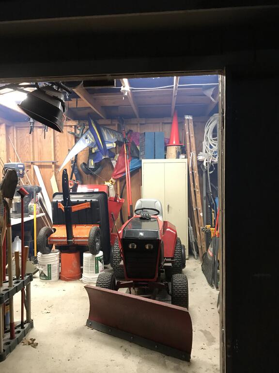

JohnD 145 #7 Posted December 8, 2020 Tonight I let it warm up at 3/4 throttle for 3 minutes and then it engages the hydro with no issues. If I take it to full throttle while the hydro is warming up the hydro whines, so 3/4 looks like the magic setting. Here's a photo at 2 minutes of warm up with a nice blue haze in the shed, so it is burning some 10W30 while warming up. Next time I have it out I'll let it idle in the shed and see if it looks the same after it is warmed up. Share this post Link to post Share on other sites
