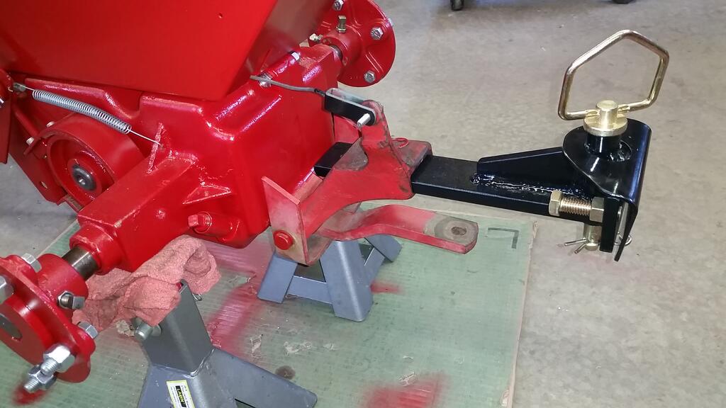

Achto 32,276 #30 Posted December 3, 2020 (edited) 1 hour ago, Crmaverick said: I hear you on that safety I’m just trying to not put pressure on that cable with a trailer cart loaded and bouncing around the yard. The C series draw hitch seems to be the right way to tow a load, without your cable taking the load of the tounge weight. Then your other receiver hitch can still pivot independently on that cable inside the draw hitch Like @WHX24 stated above, I add a rubber bumper to my drawbar hitch where it makes contact with the transmission to get rid of the up & down movement.. I drill & tap a hole on the hitch to add a bumper like the one listed below. https://www.globalindustrial.com/p/fasteners/vibration-isolators/isolators-machine-leveling/vibration-shock-absorption-mount-threaded-stud-100-inch-dia-50-inch-h-1-4-20-thread?infoParam.campaignId=T9F&gclid=EAIaIQobChMIiramqZ6y7QIV0z2tBh2ScAhWEAQYByABEgJz1PD_BwE Most of the time the rubber is too thick. To remedy this I chuck the threaded end in a drill. Then I oil up a razor blade for easier cutting. Spin the bumper with the drill & slice through the rubber to get it down to the size that you need. I use this method to trim bumpers quite often & it works very well. Edited December 3, 2020 by Achto 2 1 Share this post Link to post Share on other sites

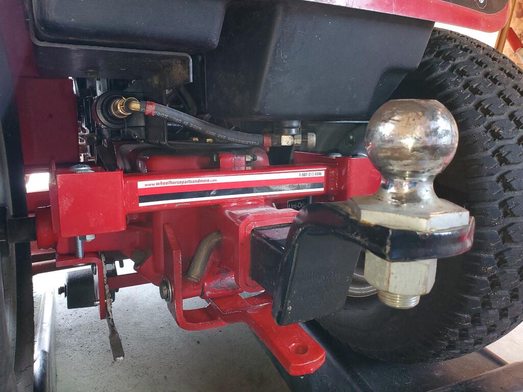

JohnD 145 #34 Posted December 6, 2020 It looks like the hitch from Wheel Horse Parts & More is easily removable and works with the plow mounting bracket. Check out the photos. https://www.ebay.com/itm/Toro-Wheel-Horse-Removable-Receiver-Hitch-with-mounting-hardware/324370405786?hash=item4b85fb999a:g:uCoAAOSwFBhazQaV 1 Share this post Link to post Share on other sites
ebinmaine 80,166 #35 Posted December 6, 2020 7 hours ago, JohnD said: It looks like the hitch from Wheel Horse Parts & More is easily removable and works with the plow mounting bracket. Check out the photos. https://www.ebay.com/itm/Toro-Wheel-Horse-Removable-Receiver-Hitch-with-mounting-hardware/324370405786?hash=item4b85fb999a:g:uCoAAOSwFBhazQaV Correct. Lowell and Joette are wonderful people and one of our own vendors. If you buy direct from them through this site or theirs the fleabay doesn't get a cut.. 1 Share this post Link to post Share on other sites
WHX?? 57,667 #36 Posted December 6, 2020 You have ?? about his products call him direct. His phone number is listed on his site. Share this post Link to post Share on other sites
Racinbob 13,088 #37 Posted December 6, 2020 14 hours ago, JohnD said: It looks like the hitch from Wheel Horse Parts & More is easily removable and works with the plow mounting bracket. Check out the photos. https://www.ebay.com/itm/Toro-Wheel-Horse-Removable-Receiver-Hitch-with-mounting-hardware/324370405786?hash=item4b85fb999a:g:uCoAAOSwFBhazQaV Like Eric said, yes it does. This is mounted on my 2005. 1 Share this post Link to post Share on other sites
