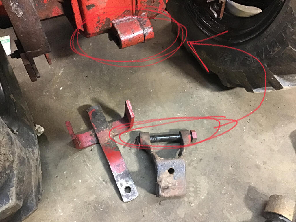

Pullstart 71,540 #19 Posted December 3, 2020 Disregard the circles.. these two can work in conjunction with each other. Lowell’s cables at WheelHorsePartsAndMore.com are surely up to the job, we have tested that with plenty of rounds of plowing! 1 Share this post Link to post Share on other sites
ebinmaine 81,223 #20 Posted December 3, 2020 2 minutes ago, Crmaverick said: I did see those to, but I do want to keep my plow mounting Bracket on my axle. It seems like the best option might be the C series draw bar. I tried one and it fit my hitch receiver in the middle. But I had up and down play, which I figured wasn’t normal. If you have fabrication capabilities and tools it might be best to make what I did for my go-to worker tractor. I made up a set of plow mounts that bolt to the front of the axle so I could use that same hitch. As far as that C series hitch I'm wondering if we're talking about the same thing because it shouldn't have any interference, usage, insertion, or anything else to do with your own except that they share the Cross pin at the bottom. When I speak of up and down movement... The pivot pin at the bottom should have next to zero up and down play. The hitch itself does pivot a little bit. Do you have any pictures of the pieces you are talking about? Share this post Link to post Share on other sites
ebinmaine 81,223 #21 Posted December 3, 2020 1 minute ago, pullstart said: Disregard the circles.. these two can work in conjunction with each other. Lowell’s cables at WheelHorsePartsAndMore.com are surely up to the job, we have tested that with plenty of rounds of plowing! Awesome job Kevin. Thank you. The hitch to the left is the one that I was talking about for a b or c series. Share this post Link to post Share on other sites

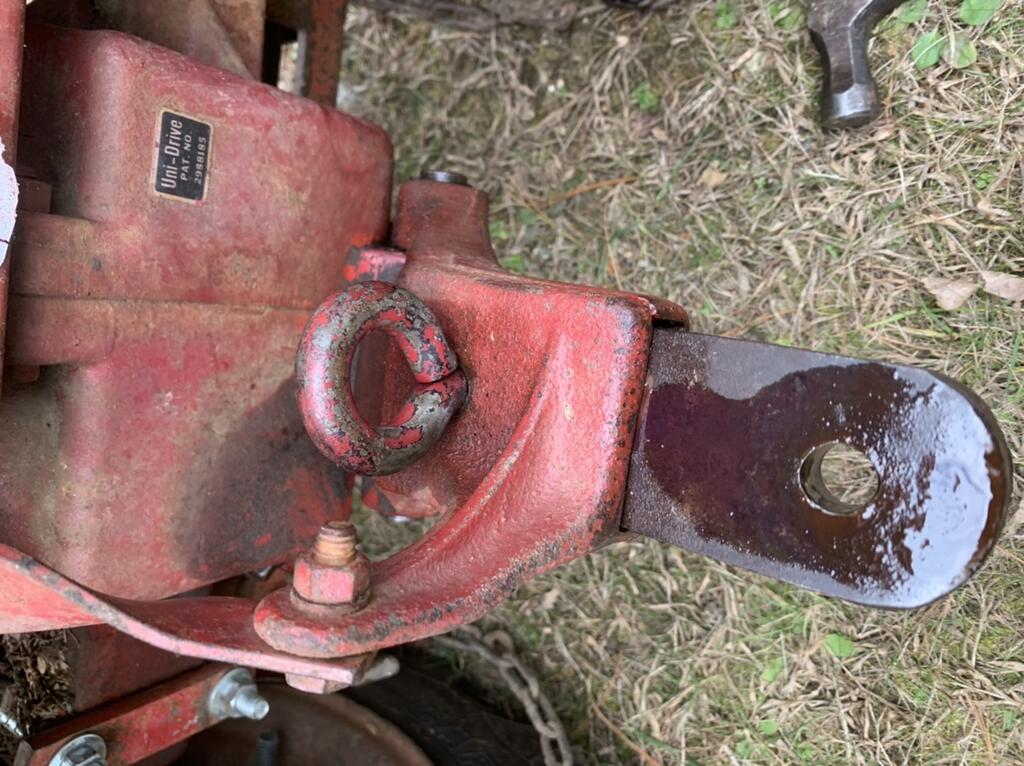

71_Bronco 1,073 #22 Posted December 3, 2020 This is the back-end of my Commando 8 I picked up about a year and a half ago. It shows the slot hitch and the draw-bar assembled on the case (same as yours). I swapped in a 6-speed with a limited slip differential, and put the same drawbar / slot hitch combo back on it, as the cases were pretty much the same. I had a problem with my old pin coming out of the 3-speed, so I bought a new one from "Wheel Horse Parts And More", for when I assembled it onto the 6-speed. My drawbar does have a little bit of up-and-down play, but I dont think it is an inch like you said. Worst case, you may be able to adjust the "tongue" that goes under the case, and bend it up a little to reduce the movement. 5 1 Share this post Link to post Share on other sites
Crmaverick 91 #23 Posted December 3, 2020 17 minutes ago, 71_Bronco said: This is the back-end of my Commando 8 I picked up about a year and a half ago. It shows the slot hitch and the draw-bar assembled on the case (same as yours). I swapped in a 6-speed with a limited slip differential, and put the same drawbar / slot hitch combo back on it, as the cases were pretty much the same. I had a problem with my old pin coming out of the 3-speed, so I bought a new one from "Wheel Horse Parts And More", for when I assembled it onto the 6-speed. My drawbar does have a little bit of up-and-down play, but I dont think it is an inch like you said. Worst case, you may be able to adjust the "tongue" that goes under the case, and bend it up a little to reduce the movement. yeah that’s exactly what I’m talking about, it may not be an inch, maybe half or a quarter. It pivots on the pin. Is there a reason they made these draw hitches have that pivot play? Share this post Link to post Share on other sites
71_Bronco 1,073 #24 Posted December 3, 2020 2 minutes ago, Crmaverick said: yeah that’s exactly what I’m talking about, it may not be an inch, maybe half or a quarter. It pivots on the pin. Is there a reason they made these draw hitches have that pivot play? Probably to take into account any variation in casting sizes and cross-hole location. Plus the hole location and bends in the drawbar itself have manufacturing tolerances. Could just be a stack-up. 1 Share this post Link to post Share on other sites
