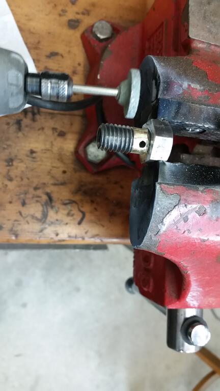

WHX?? 57,923 #39 Posted December 9, 2020 6 minutes ago, Greentored said: Was driving me nuts, 400 things going on right now including draining a six pack of Miller Lite and going to the out house but I had to at least redo the steering and slap a pair of decals on her👍 LOL ...sorry Green but you asked for it! Was that bushing put in by you or a PO? Those holes in the drag link I drill to 5/8 and bronze bush back to 1/2" The zerk bolts are known to wear and wallow too. I braze them up then Dremel grind back down to fit goodntite. Redrill the grease hole. I don't wanna hear how it cuts into yer Miller time! 1 1 Share this post Link to post Share on other sites
Greentored 3,221 #40 Posted December 9, 2020 @WHX24 that’s hilarious, and sometimes true! Nice job on the zerk bolts! Mine were only worn about .030, I chucked them in the lathe and cut them back to round and made a bushing to fit, about .470. Had to sacrifice some of the thread ‘depth’ to cut to an even OD, but still left plenty to tighten them up and jam nut em. The passages actually had grease in them and were clear! 1 Share this post Link to post Share on other sites

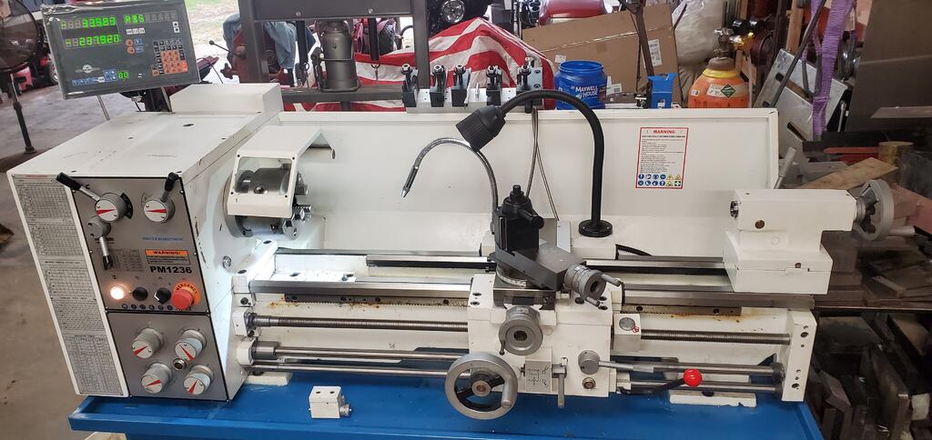

Greentored 3,221 #42 Posted December 9, 2020 10 hours ago, WHX24 said: I need to get a lathe dude! It's one of those machines folks see getting used a few times a year and have a hard time justifying having one. Believe me, the real numbers are closer to 'almost daily.' A mill might be even 'worse.' Throw one of those in there too and it would be very easy to lock one's self in that area with a pile of scrap metal and get lost for days on end...... If I win the powerball, EVERYONES getting a lathe and a mill 5 Share this post Link to post Share on other sites

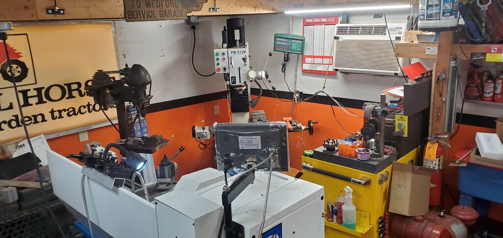

Shynon 7,656 #47 Posted December 9, 2020 2 hours ago, WHX24 said: Hear that Tom @Shynon?!?!?!? Amen to that! That's where I'll go when the boss says go to your corner. 1 2 2 Share this post Link to post Share on other sites
