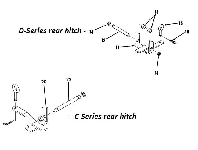

Sailman 1,307 #1 Posted November 23, 2020 Needing a stock tractor drawbar hitch for my C-120 auto. Several on e-bay from different wheel horse tractors including D series and 520. But....they all look alike with slants on the upright, 3/4 inch shaft with spacers and snap rings. Are they all interchangeable or are they different sizes? anyone here got one for sale? Thanks! Share this post Link to post Share on other sites
WVHillbilly520H 10,379 #2 Posted November 23, 2020 Yes B,C,3,4,&500 series are. 1 1 Share this post Link to post Share on other sites
Sailman 1,307 #3 Posted November 23, 2020 I take it the D series are not, correct? Share this post Link to post Share on other sites

R. L. Addison 300 #11 Posted November 23, 2020 C & D hitches are NOT the same. The D tongues are turned down, the C tongues are turned up allowing for a difference in height from the ground due to vehicle height. (Tongues having the pin holes in them). 2 Share this post Link to post Share on other sites
gwest_ca-(File Mod) 12,511 #12 Posted November 23, 2020 1 Share this post Link to post Share on other sites
