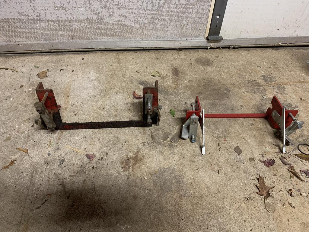

Jimmy0331 27 #7 Posted November 6, 2020 So the dirty bigger bracket came off the 1267 and the newer smaller bracket came with the plow and frame. 1 Share this post Link to post Share on other sites
ebinmaine 80,288 #8 Posted November 6, 2020 I'm not familiar with that smaller piece. Perhaps @953 nut or @pfrederi could help. Maybe off a 200 series or a Lawn Ranger? Share this post Link to post Share on other sites
JohnD 145 #9 Posted November 6, 2020 Its hard to tell the scale, but the one on the right looks like what is under my '83 C-175. I measure 12" from silver latch to latch. Share this post Link to post Share on other sites
gwest_ca-(File Mod) 12,454 #10 Posted November 6, 2020 The one on the left mounts to the front of the square axle housings. The one on the right mounts to the bottom of the square axle housings. Each assembly needs to stay with their plow. If you look at the list of plows in the file I linked you to it will make sense to you. Click on that picture in the link. Roll the one on the right so the cut-out notch is on the bottom and then turn end for end. Now it's position matches the one on the left. Garry Share this post Link to post Share on other sites
