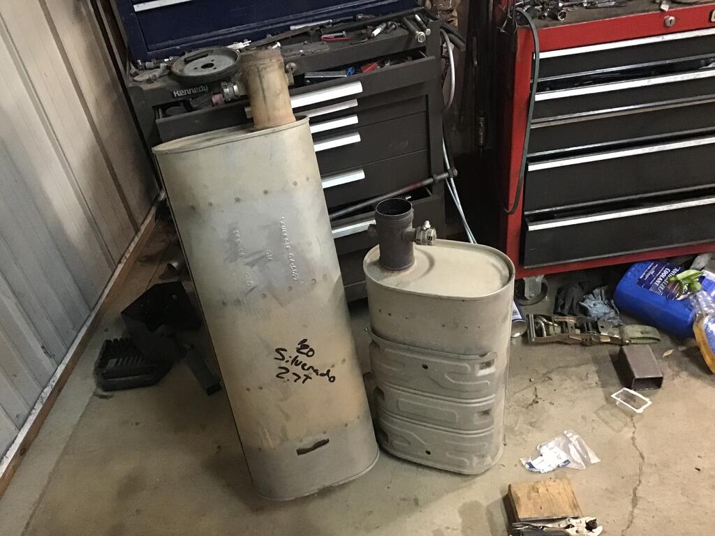

Pullstart 68,988 #1 Posted November 2, 2020 My 2020 2.7 Turbo muffler on the left, my buddy’s 2019 5.3 muffler on the right. Same 1500 Silverado, totally different muffler design. Mine... 3”. His... 2-3/4” Mine... gazillion pounds, measured in cubic yards. His... Normal. @WVHillbilly520H care to explain to a common folk like me why my turboed 4 cylinder needs this plus another resonator? The turbo in the diesel world is considered the first spark arrestor and it also quiets the sound. @PeacemakerJack I finally stuck that little stainless muffler on today! Sounds much better, for he minute or two of run time in the driveway! 1 1 Share this post Link to post Share on other sites

Achto 31,135 #3 Posted November 2, 2020 28 minutes ago, pullstart said: My 2020 2.7 Turbo muffler on the left, my buddy’s 2019 5.3 muffler on the right. Same 1500 Silverado, totally different muffler design. Mine... 3”. His... 2-3/4” Mine... gazillion pounds, measured in cubic yards. His... Normal. 8 cylinder in a full size truck - Normal 4 cylinder in a full size truck - Not Normal Nuff said. 8 Share this post Link to post Share on other sites

WVHillbilly520H 10,378 #6 Posted November 2, 2020 1 hour ago, pullstart said: My 2020 2.7 Turbo muffler on the left, my buddy’s 2019 5.3 muffler on the right. Same 1500 Silverado, totally different muffler design. Mine... 3”. His... 2-3/4” Mine... gazillion pounds, measured in cubic yards. His... Normal. @WVHillbilly520H care to explain to a common folk like me why my turboed 4 cylinder needs this plus another resonator? The turbo in the diesel world is considered the first spark arrestor and it also quiets the sound. @PeacemakerJack I finally stuck that little stainless muffler on today! Sounds much better, for he minute or two of run time in the driveway! Unfortunately the OEM has to meet "SPL" emissions as well as carbon emissions, and you will probably agree that with your current setup it stays at higher RPMS until cruising and most 4 and 6 cylinder vehicles I have owned were usually a higher hertz exhaust note than many V8s (think fast and furious Hondas vs the Charger exhaust note) at least that what was explained to me back in my exhaust manufacturing days... And most 4 cylinder O.E. style aftermarket mufflers Walker made were bigger than the V8 counterparts but usually with 1.5" to 1.75" piping not 3"... Now does yours have the factory dual exit tail pipes or single exit? 1 1 Share this post Link to post Share on other sites
ZXT 2,401 #7 Posted November 2, 2020 It's likely larger so that people don't have to listen to the sound of a 4 cylinder as much. 1 1 1 Share this post Link to post Share on other sites
cschannuth 3,819 #8 Posted November 2, 2020 (edited) They are definitely trying to make sure your truck doesn’t sound like a ricer. I have the 2.7 eco-boost V6 in my F150 work truck and it is the fastest truck I’ve ever owned but I see a lot of people putting loud mufflers on them and, to me, as a big block V-8 guy, they sound terrible. The 5.3, like I have in my suburban, sounds good but it needs all the performance help it can get. That’s just my guess. Edited November 2, 2020 by cschannuth 1 1 Share this post Link to post Share on other sites
Pullstart 68,988 #9 Posted November 2, 2020 11 hours ago, WVHillbilly520H said: Unfortunately the OEM has to meet "SPL" emissions as well as carbon emissions, and you will probably agree that with your current setup it stays at higher RPMS until cruising and most 4 and 6 cylinder vehicles I have owned were usually a higher hertz exhaust note than many V8s (think fast and furious Hondas vs the Charger exhaust note) at least that what was explained to me back in my exhaust manufacturing days... And most 4 cylinder O.E. style aftermarket mufflers Walker made were bigger than the V8 counterparts but usually with 1.5" to 1.75" piping not 3"... Now does yours have the factory dual exit tail pipes or single exit? It’s a single exit out the right rear. His is dual exhaust after the muffler, out through the bumper. Notice those spring loaded flappers in the pipe. They block 1/3 of the pipe when fully open because of the counter weight. I removed it and picked up over 1 mpg! It’s been straight piped for 6,000 miles or so and I am already enjoying the new sound that the Amazon rip off stainless 40 series wannabe is helping to create! It’s much more mellow than the Honda Civic sound it was making, but the fuel savings seemed like enough of a difference for me to be ignorant of the sound. Share this post Link to post Share on other sites

WVHillbilly520H 10,378 #11 Posted November 2, 2020 2 hours ago, pullstart said: It’s a single exit out the right rear. His is dual exhaust after the muffler, out through the bumper. Notice those spring loaded flappers in the pipe. They block 1/3 of the pipe when fully open because of the counter weight. I removed it and picked up over 1 mpg! It’s been straight piped for 6,000 miles or so and I am already enjoying the new sound that the Amazon rip off stainless 40 series wannabe is helping to create! It’s much more mellow than the Honda Civic sound it was making, but the fuel savings seemed like enough of a difference for me to be ignorant of the sound. I am about to get an actual Flow master 50 series cat back dual kit for my 14 5.3. If you search enough you will fill that $1200 kit for less than $700. Walker Dynomax Ultra Flo may be a better option if you were just changing muffler/s for sound and performance. Share this post Link to post Share on other sites
WVHillbilly520H 10,378 #12 Posted November 2, 2020 2 hours ago, JoeM said: I suppose to the average guy, mufflers can be baffling! That was sad! Not all mufflers are baffled, some are chambered... Not all louver tubes are patterned the same or perforated with the same size holes or amounts... Is definitely a lot that goes into the way each specific muffler is designed for each vehicle and its purpose thereof... Believe me after 22 years in the only Walker brand aftermarket exhaust factory in the lower 48 i have seen All kinds of sales gimmicks that really didn't catch on just like "Flow valve" in the stock GM trucks. 1 Share this post Link to post Share on other sites
