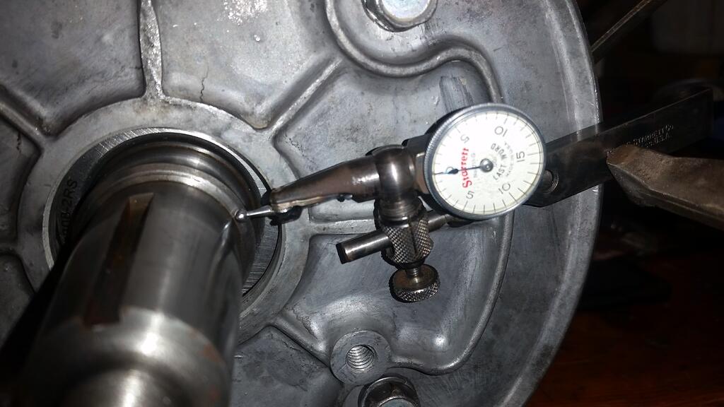

WHX?? 56,064 #4 Posted October 29, 2020 I would have definitely checked the big end to crank journal unless you really got a good crank grinder that you trust. Plasti gage is the only way to do it but any competent shop can do that. Unless you have been following the engine section and how hard it is to find those shops nowadays. Just sayin. To accurately measure end play or vertical play you need a dial indicator with a suitable mounting. My set up.... 1 Share this post Link to post Share on other sites
tntatro 181 #5 Posted October 29, 2020 Thanks for showing that, so it's clamped onto the bearing plate I see. Do you know if the dial from my bore gauge would be sufficient if I could secure it onto the bearing plate? The machine shop I go to did a few other crankshafts for me. The first one they did .030" under and fit a bearing in the rod. They told me they have done thousands like that so I think they know what they are doing. I guess I should check the big end, I pretty much just trusted that the rod was in spec. I thought you used a micrometer and bore gauge to check the big end to journal and plasti gage was the "good enough" method, although I don't have a bore gauge that small or inside micrometer so plasti gage is all I can do now anyway. I just checked the rod with dial calipers to make sure it was in fact .020" under when I installed it. Share this post Link to post Share on other sites
