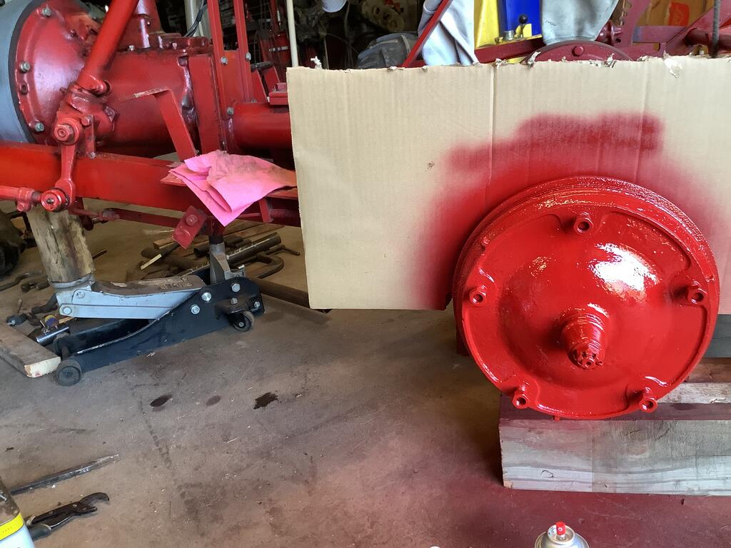

Pullstart 71,564 #177 Posted August 10, 2022 1 hour ago, davem1111 said: I haven't heard of this "grease trick" yet - what is it? anything you don’t want paint to stick to grease it. It’ll wipe away when finished! 1 1 Share this post Link to post Share on other sites

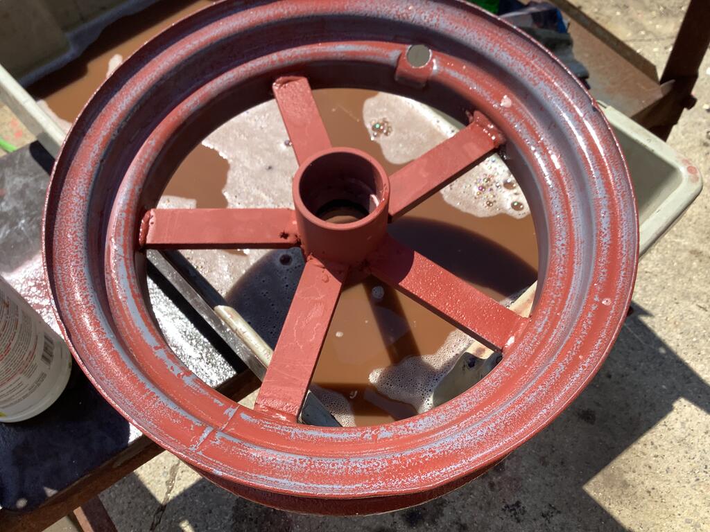

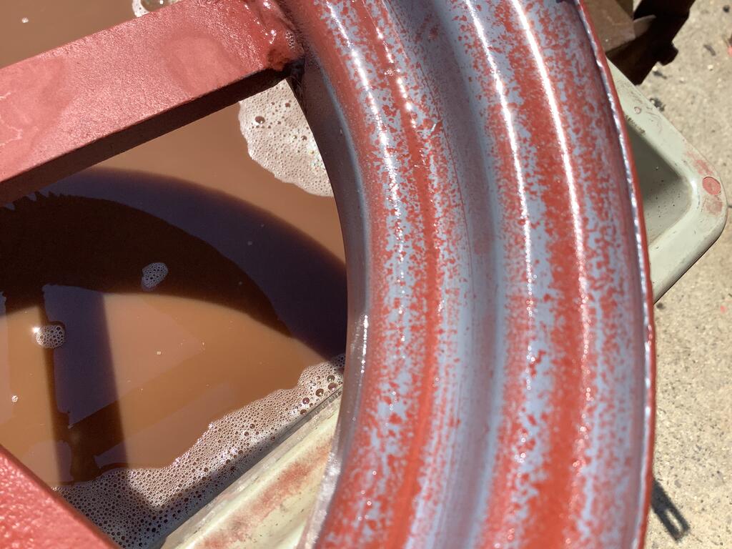

Pullstart 71,564 #181 Posted August 10, 2022 Hey @Achto what say you? Obviously we’re not talking a class A panel. How much more red should I take off here? I’ll be getting down to bare metal before it’s all gone I bet! 1 1 Share this post Link to post Share on other sites
Achto 32,964 #182 Posted August 10, 2022 (edited) 11 minutes ago, Pullstart said: How much more red should I take off here? That depends on how smooth you want the finish. Looks like a fair amount minor of pitting yet. Could stop where you are at and let some of the history shine through. If you hit some bare metal, just spray a coat of self etching over it right before painting. If you want a smooth finish. Then you may have to get it as smooth as you can right now, hog some more primer on it, and wet sand it again. Edited August 10, 2022 by Achto 2 Share this post Link to post Share on other sites

Handy Don 17,735 #184 Posted August 10, 2022 4 hours ago, davem1111 said: I haven't heard of this "grease trick" yet - what is it? Paint won't stick to grease. A light grease coating on, say, the inside bore of the wheel hub lets you simply wipe off any "overspray" after you're done. I'll be using that trick to keep the spindle bores of the RM-366 mower deck plate paint-free without having to try to tape them off. (Paint first; install bearings later ) 1 Share this post Link to post Share on other sites
Handy Don 17,735 #185 Posted August 10, 2022 3 hours ago, Achto said: stop where you are at and let some of the history shine through I like this suggestion! Share this post Link to post Share on other sites
953 nut 70,662 #186 Posted August 10, 2022 4 hours ago, Pullstart said: Obviously we’re not talking a class A panel. How much more red should I take off here? I would spray some satin clear and call it done! Patina rules! 1 Share this post Link to post Share on other sites
Pullstart 71,564 #187 Posted August 10, 2022 13 minutes ago, 953 nut said: I would spray some satin clear and call it done! Patina rules! Yeah, wrong tractor for making patina though…. Well in our eyes 1 Share this post Link to post Share on other sites
Pullstart 71,564 #188 Posted August 10, 2022 I’m not sure if the IH red is any darker but it’s on! 2 2 Share this post Link to post Share on other sites

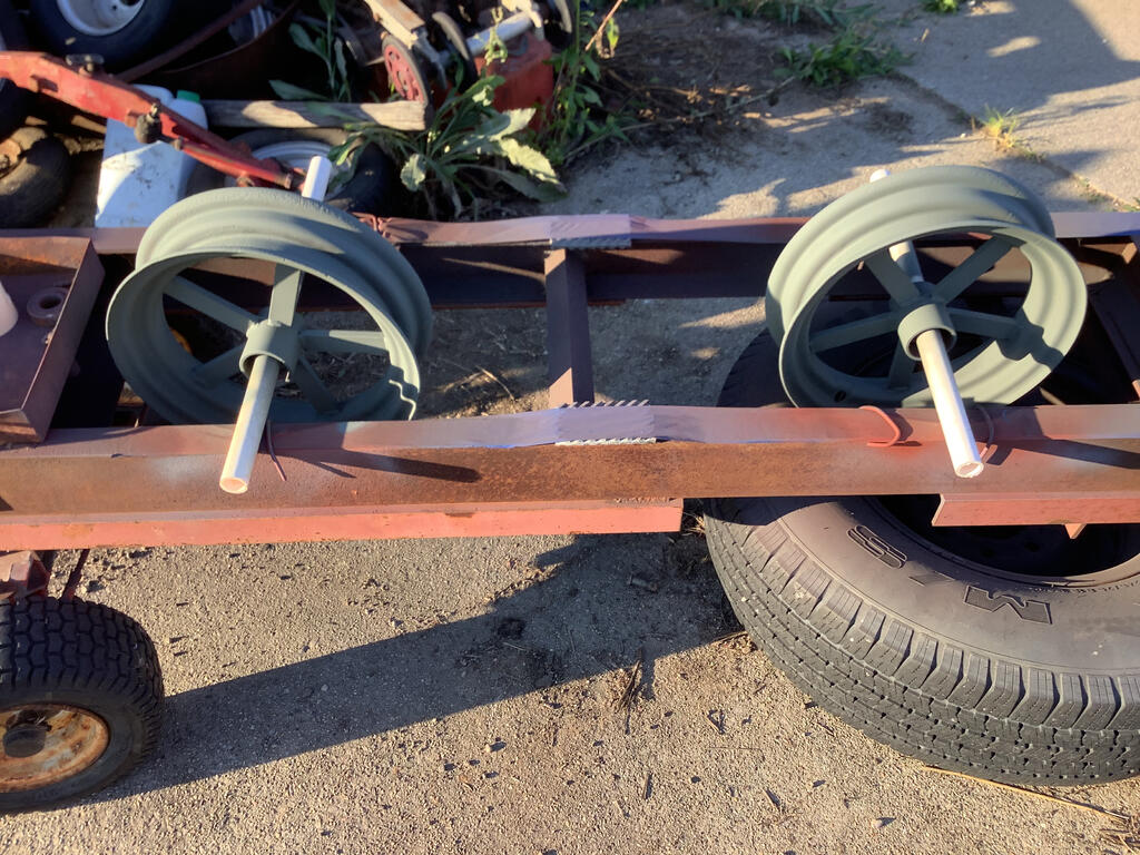

Pullstart 71,564 #189 Posted August 10, 2022 My paint tray Self etching primer applied, next is Antique White! 2 1 Share this post Link to post Share on other sites

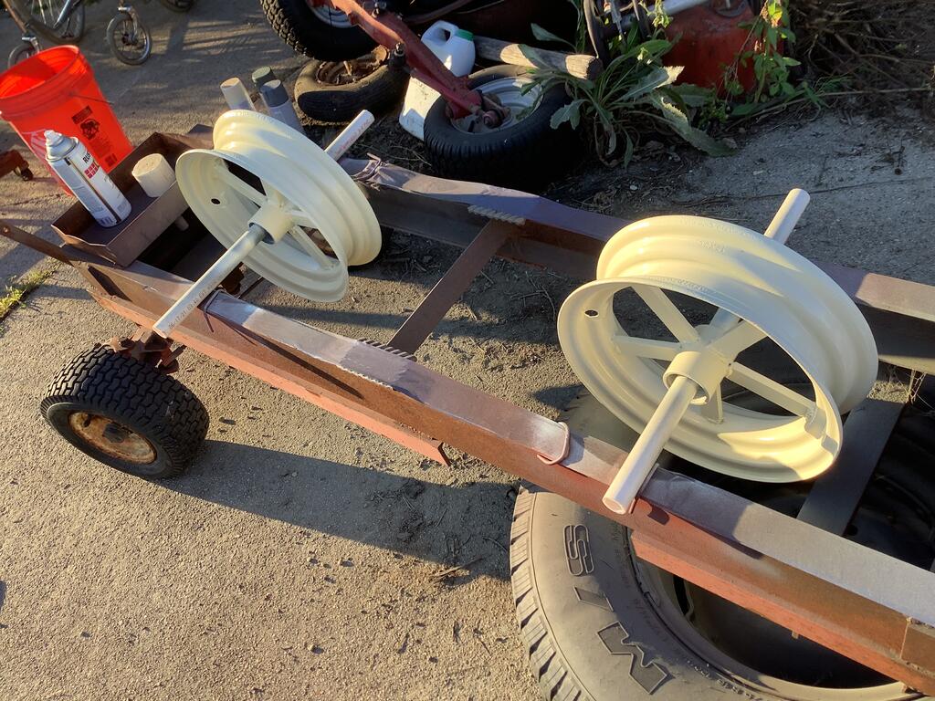

Pullstart 71,564 #190 Posted August 10, 2022 Coat #1 3 2 Share this post Link to post Share on other sites
