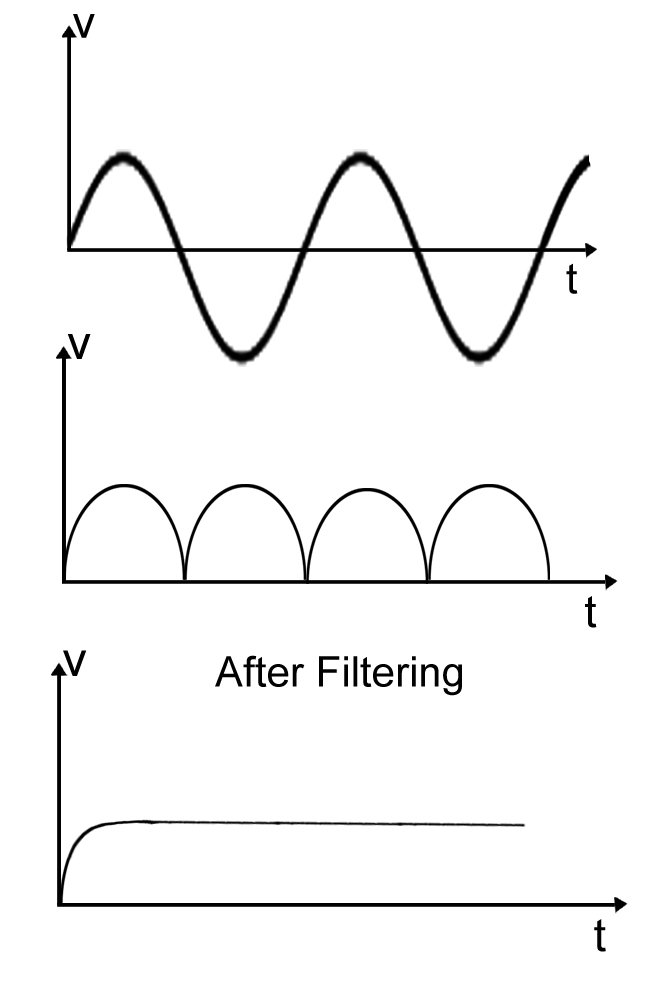

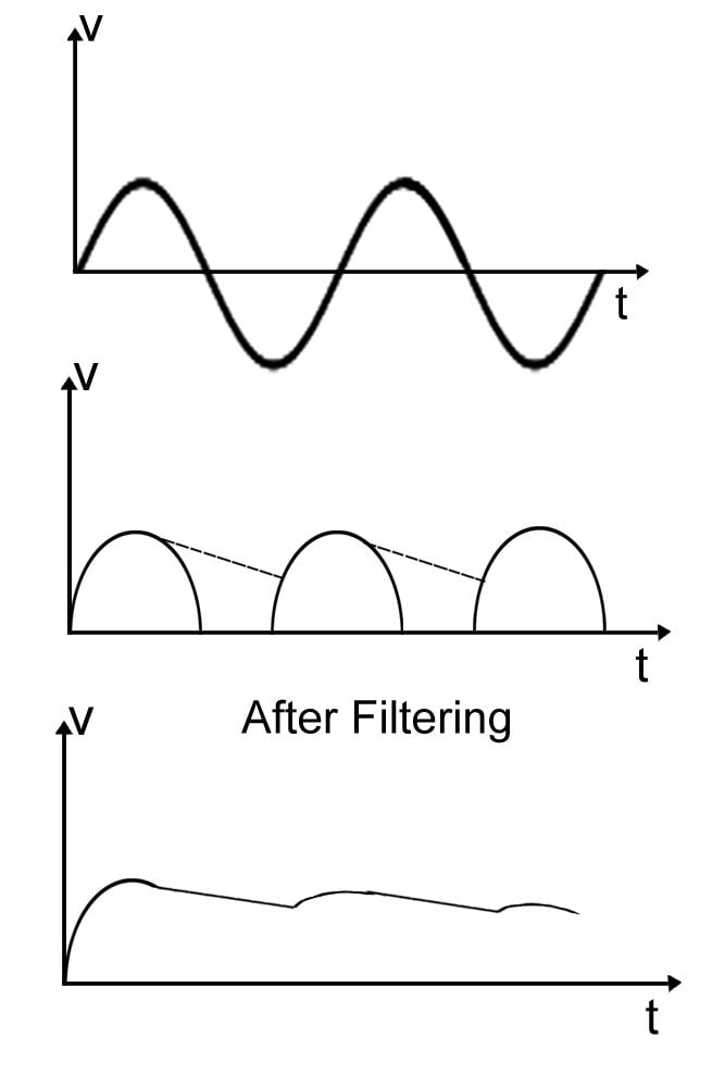

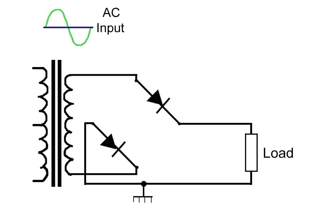

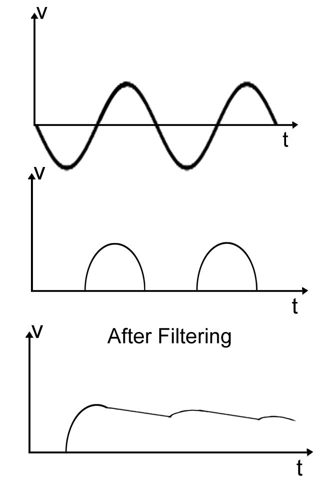

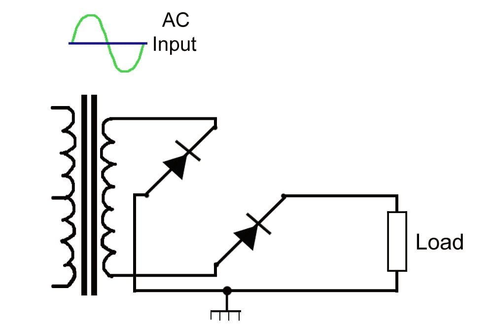

bc.gold 3,406 #11 Posted October 26, 2020 5 hours ago, Solze1267 said: @bcgold are you talking the voltage regulator for the tractor or something to do with the charger? Sorry electrical isn’t my strong suit...now if you want something painted I’m all over that!! The alternator on the tractor generates 3 phase ac current, if you were to look at that voltage on a oscilloscope you would see the sine wave. North American house current is 60 cycles per second. Diodes are one way valves either positive or negative for instance a positive diode will only pass the positive side of the sine wave giving DC current. Three phase produces 3 legs of usable power, usually defined as L1, L2 and L3, the alternator charging the battery would have 3 positive and 3 negative diodes. One of the most common failures is when a person mistakenly connects jumper cables to the wrong battery terminals, the fully charged battery supplying the jump has enough power to blow a diode. Being that diodes are electronic devices they are subject to cycle depreciation - old age. How Does A Rectifier Work? Updated on: 21 Oct 2019 by Akash Peshin To begin with, your most prized possession would be unable to function without a rectifier: no, it’s not your phone, but its charger. Your phone charger and, for that matter, the majority of your household electronic devices do not operate on an AC supply – the alternating current generated by power plants and then supplied to your house via transmission cables — but rather on a DC supply: a constant current that flows unfailingly in a single direction. The rectifier is a circuit embedded in your device that converts the restless AC supply coming to your house into a steady DC supply, so that your devices can function properly. However, how does the rectifier achieve this rectification? The Diode The diode is one of the semiconductor revolution’s first offspring. The device is basically two slabs of semiconductors glued to each other. However, the semiconductors differ in their properties: one is electron-impoverished, or exhibits an excess of positive charges or holes, while the other is suffused with electrons and therefore exhibits an excess of negative charges. Together, they constitute what is called a PN Junction. The fundamental purpose of a diode, unlike a resistor, is to allow current to flow in a single direction. Current through a diode will only flow when its positive semiconductor, or the anode, is connected to the positive terminal of the battery, and its negative semiconductor, or the cathode, is connected to the negative terminal of the battery. The current is stifled when the terminals are cross-connected. The diode lies at the heart of the rectifier, where the rectifier leverages its properties to fulfill its purpose. Rectification First of all, the AC voltage is drastically reduced, as a triple-digit voltage will fry your toaster or charger. This is achieved with a transformer or a voltage regulator. The diminished AC supply is then fed to the device, where it is first greeted by the rectifier. The rectifier converts the AC to DC and then passes it to the device’s core circuit. A rectifier can generate a DC supply either by rectifying only one cycle (either positive or negative) of the AC supply or by rectifying both of them. The former is therefore called a half-wave rectifier, as it only rectifies one half of the supply waveform, while the latter is called a full-wave rectifier, as it rectifies both halves or the entirety of the waveform. Half Wave Rectifier The magnitude of the AC supply is reduced with a transformer and fed to this particular configuration of diodes. The configuration will rectify only the positive cycles of the waveform: Positive Half-Wave Rectifier During a positive cycle, a positive charge is obtained on the upper node, while a negative charge is obtained on the lower node. Now, because a diode will allow the current to pass only when the anode (the triangle) is connected to the positive terminal and the cathode (the stick) is connected to the negative terminal, both the diodes in the configuration will conduct during the positive cycle. The load is therefore supplied with a current: the positive cycle is replicated on its output waveform. However, when the AC supply alternates, the polarity on the nodes swap: now, the upper node is negatively charged, while the lower node is positively charged. The diodes are cross-connected and the current ceases to flow. When no current reaches the load, the output waveform for the negative cycle is a line tracing the X-axis, depicting the passage of time, but not any current. Voltage Across The Load After Rectification The negative cycle can be rectified (at the cost of the positive cycle, of course) through some tinkering with the configuration of the diodes: Negative Half-Wave Rectifier The configuration is such that the load will experience a current during the negative cycle, more specifically, when a negative charge is obtained on the upper node and a positive charge is obtained on the lower node. Of course, being a half-wave rectifier, the current is stifled when the current alternates and the polarities swap. As this rectifier only rectifies the negative cycles, its output waveform will look like this: Voltage Across The Load After Rectification However, one can observe how the waveforms are bumpy: two waves of productivity separated by an undesirable void of idleness or unproductivity. The waveform can be “smoothed” with a large, filtering capacitor. The capacitor will accumulate energy during the productive cycle and release it during the unproductive cycle until the next productive cycle begins. It then reaccumulates energy and the whole cycle repeats. The result is a bridging of the valley – a constant, unidirectional DC supply. Still, the conversion is dramatically inefficient: why must we waste half of all the energy? Why shouldn’t we utilize every ounce of it? Full Wave Rectifier One rectifier rectifies only the positive halves, while another rectifies only the negative halves. So how do we develop a rectifier that rectifies both halves sequentially? Simply by combining the two rectifiers! Full Wave Rectifier The circuit appears enmeshed and therefore automatically complex and confusing. However, its function, on the contrary, is astonishingly simple. Examine the circuit carefully and you’ll observe that it is literally a combination of the two half-wave rectifiers explained above. The first half-wave rectifier conducts during the positive cycle, while the second half-wave rectifier conducts during the negative cycle. As the current passes through the load during both cycles, no voids are found in the output waveform. It is a continuous series of hills, or trail of energy. Of course, gaps do exist between the hills, but they are much narrower than the gaps in the output waveform of a half-wave rectifier. We can remove these small inconsistencies, again, with a large filtering capacitor. The smoothed waveform is an even steadier, energy-efficient and high-quality DC supply. Share this post Link to post Share on other sites
