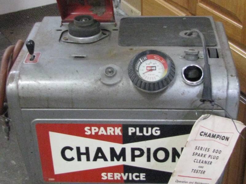

Stepney 2,357 #1 Posted October 25, 2020 Evening, all. Grabbed this dinosaur today. It's a Champion plug cleaner/tester. Has a little sand blaster in the top and various rubber plugs for different threads. It has a button hooked to a model T ford ignition coil, and a little mount with mirrors on top to see into the plug as it fires, along with what seems to be some sort of ammeter. So far nothing works at all, but I have hardly looked into it. There's a large rotating knob in the top that does .. something? Havent figured it out yet. The rest seems fairly obvious and its just stuck from sitting. Has anyone messed with one of these dinosaurs? I see tons of pictures online, but no videos of one working, nor any posts of someone talking about one.. 7 Share this post Link to post Share on other sites

oliver2-44 11,537 #9 Posted October 26, 2020 my dad had a benchtop model like this at our LagrangeAirport/farm Shop. @Stepney " There's a large rotating knob in the top that does .. something? Havent figured it out yet. " If i remember correctly that unit is hooked up to an air pressure supply. Rotating that knob/wheel increases pressure in the chamber that the plug is screwed into. so you can see the plug firing simulating engine cylinder pressure. 1 hour ago, ACman said: Still have one like this at the AC dealership. Used the sandblasted part cleaning plugs for the snowmobile (Champion N2C for Rotax 377) growing up. 2 1 Share this post Link to post Share on other sites
953 nut 66,635 #10 Posted October 26, 2020 10 hours ago, oliver2-44 said: unit is hooked up to an air pressure supply. Rotating that knob/wheel increases pressure in the chamber that the plug is screwed into. so you can see the plug firing simulating engine cylinder pressure Right on Jim. We had one in the gas station I worked at in the '60s. When a car was running rough we would see which cylinder was dead bu pulling plug wires on and off while the engine was running. Once the dead cylinder was found we would test the plug without pressure and then watch it fail with increased pressure. Then of course we would tell the customer that all the plugs should be changed, it was a good sales tool. Many customers would bring in lawn mower plugs and we would clean and test them for free. @Stepney, thanks for the trip down memory lane. 1 1 Share this post Link to post Share on other sites
