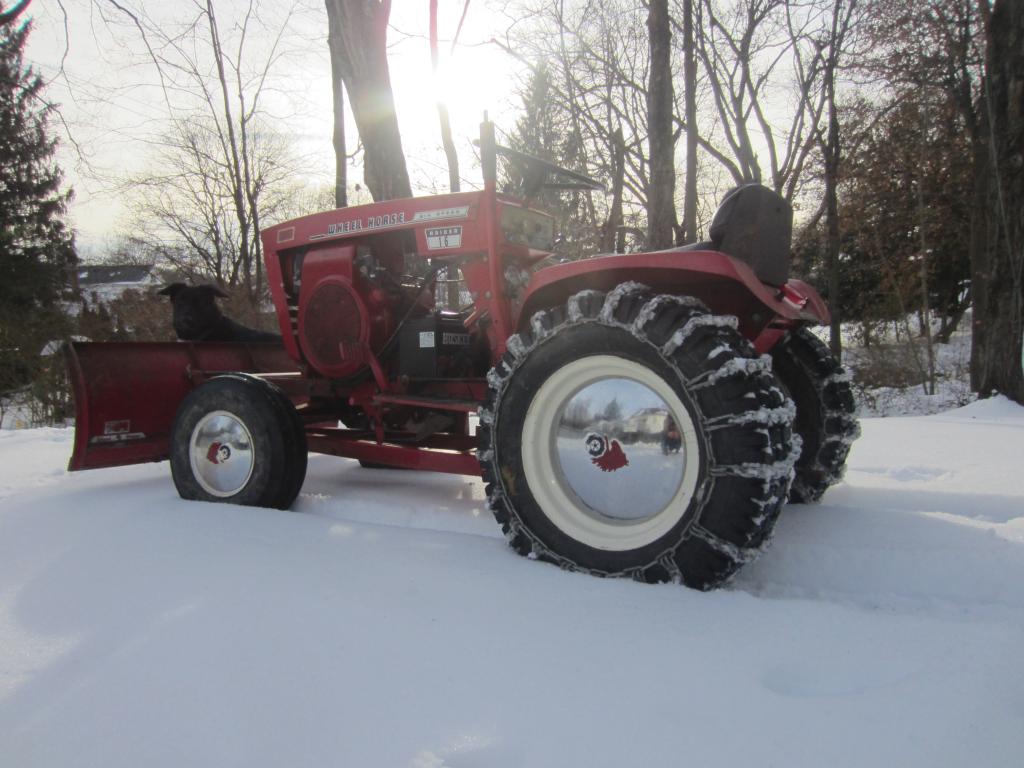

ebinmaine 80,628 #43 Posted October 20, 2020 19 hours ago, Herder said: This is the push all of everything!! Weights, chains and fluid filled tires. Chains are not recommended for blacktop driveways. Adam what kind of weight do you have there? Homemade? Share this post Link to post Share on other sites
ebinmaine 80,628 #44 Posted October 20, 2020 41 minutes ago, danweikert21 said: Hey one more question how would I add wights to the front of my Riader 10. I know I could do the front wheels but i would rather mount them up front. If anyone has any tips that would be helpful thank you. Check out the top picture in the post I just quoted above this one. Looks like a steel box maybe? Share this post Link to post Share on other sites
Herder 2,356 #45 Posted October 20, 2020 41 minutes ago, ebinmaine said: Adam what kind of weight do you have there? Homemade? This is a WH front plow weight. Rather hard to find, I had to purchase a tractor in order to get this weight. Couldn't help myself. 1 Share this post Link to post Share on other sites

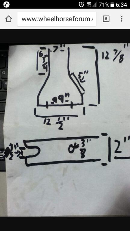

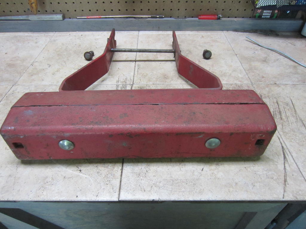

ebinmaine 80,628 #46 Posted October 20, 2020 3 minutes ago, Herder said: This is a WH front plow weight. Rather hard to find, I had to purchase a tractor in order to get this weight. Couldn't help myself. No real rush but I need to make up a bracket or two so I can install some front weights in particular on Trina's Pig Pen tractor. ... But possibly others. Would you mind taking some rough measurements of that thing sometime? Share this post Link to post Share on other sites
WVHillbilly520H 10,379 #47 Posted October 21, 2020 6 hours ago, ebinmaine said: No real rush but I need to make up a bracket or two so I can install some front weights in particular on Trina's Pig Pen tractor. ... But possibly others. Would you mind taking some rough measurements of that thing sometime? Hope this helps... 2 Share this post Link to post Share on other sites
ebinmaine 80,628 #48 Posted October 21, 2020 27 minutes ago, WVHillbilly520H said: helps EXCELLENT 1 1 Share this post Link to post Share on other sites
