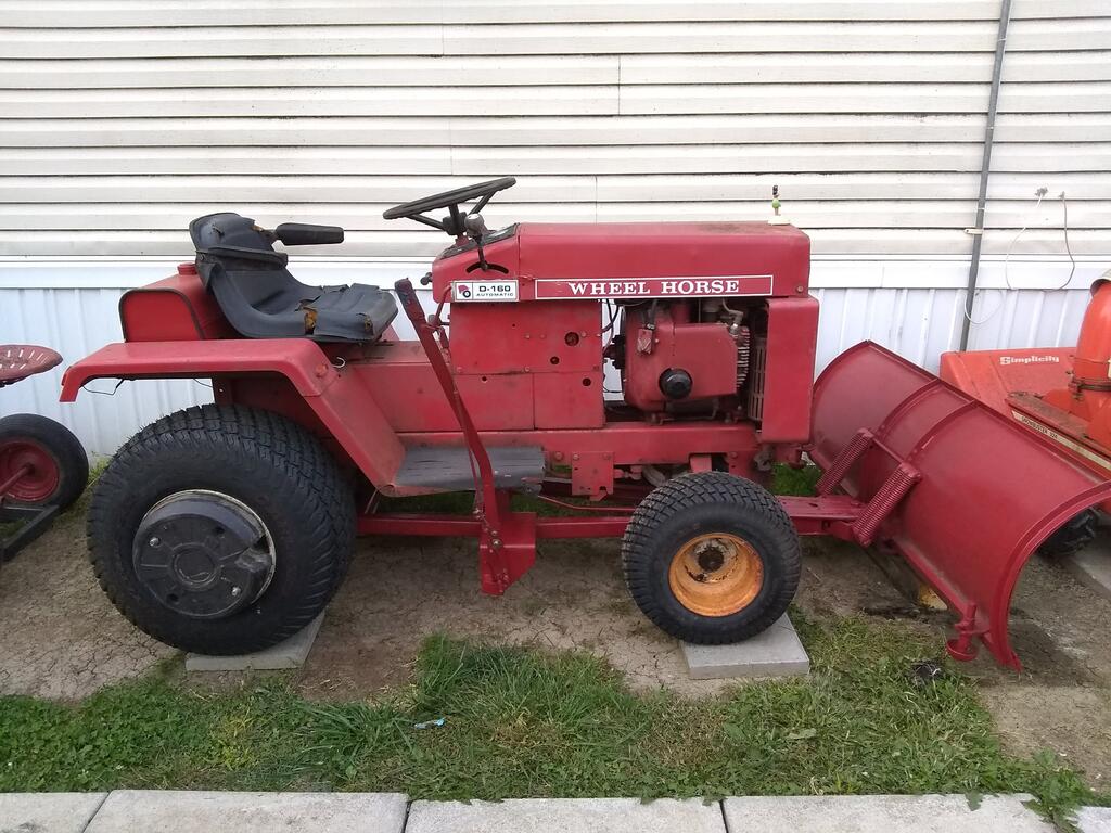

stevasaurus 23,884 #6 Posted October 19, 2020 Rubber chains if you are doing others driveways. Here is my B-100...it plows great the way it is, but I do have nubbier tires on mine. Yours seem a little smooth. 1 Share this post Link to post Share on other sites
danweikert21 166 #7 Posted October 19, 2020 Thanks for the help is that a metal bar on the plow? Share this post Link to post Share on other sites
rjg854 13,422 #8 Posted October 19, 2020 Most likely it is, by the looks of it Share this post Link to post Share on other sites
stevasaurus 23,884 #9 Posted October 19, 2020 Yes, and I adjust it to be about 1/4" off the driveway surface. I would also stick with turf tires, but with deeper nubs. 1 Share this post Link to post Share on other sites

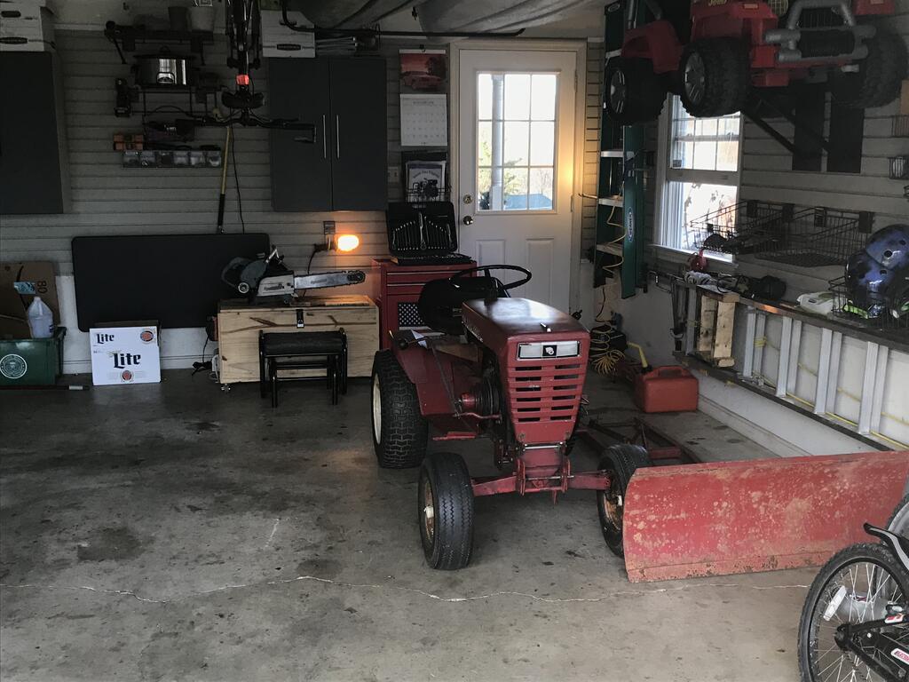

SylvanLakeWH 32,823 #14 Posted October 19, 2020 I plow three flat driveways - 2 asphalt and one concrete. Used chains a few times and the scratching and marring (on my driveway) made me try without. Have never gone back. Been doing it with no added weight and no chains for 5 years now and no issues. Do I skid around sometimes - yup. Michigan slop is fun to plow! Here's my rig: 5 1 Share this post Link to post Share on other sites

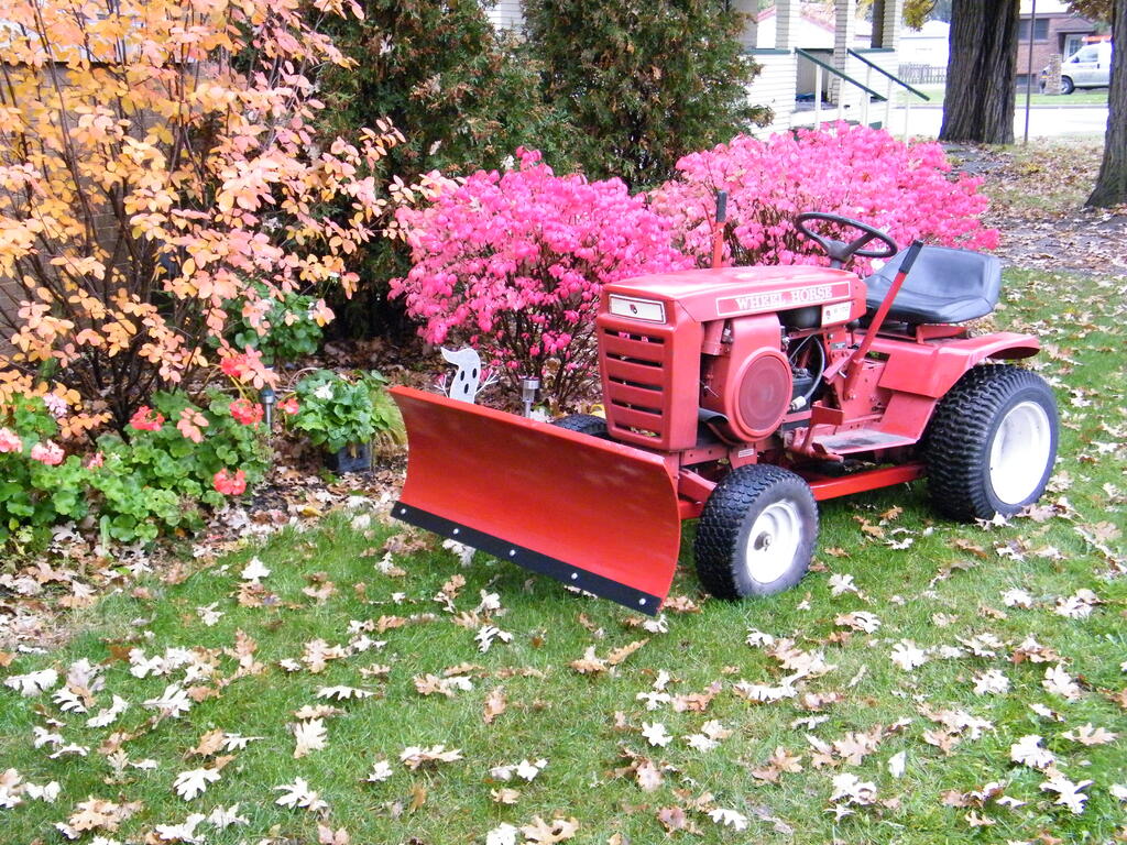

Herder 2,356 #25 Posted October 19, 2020 This is the push all of everything!! Weights, chains and fluid filled tires. Chains are not recommended for blacktop driveways. 1 2 Share this post Link to post Share on other sites
